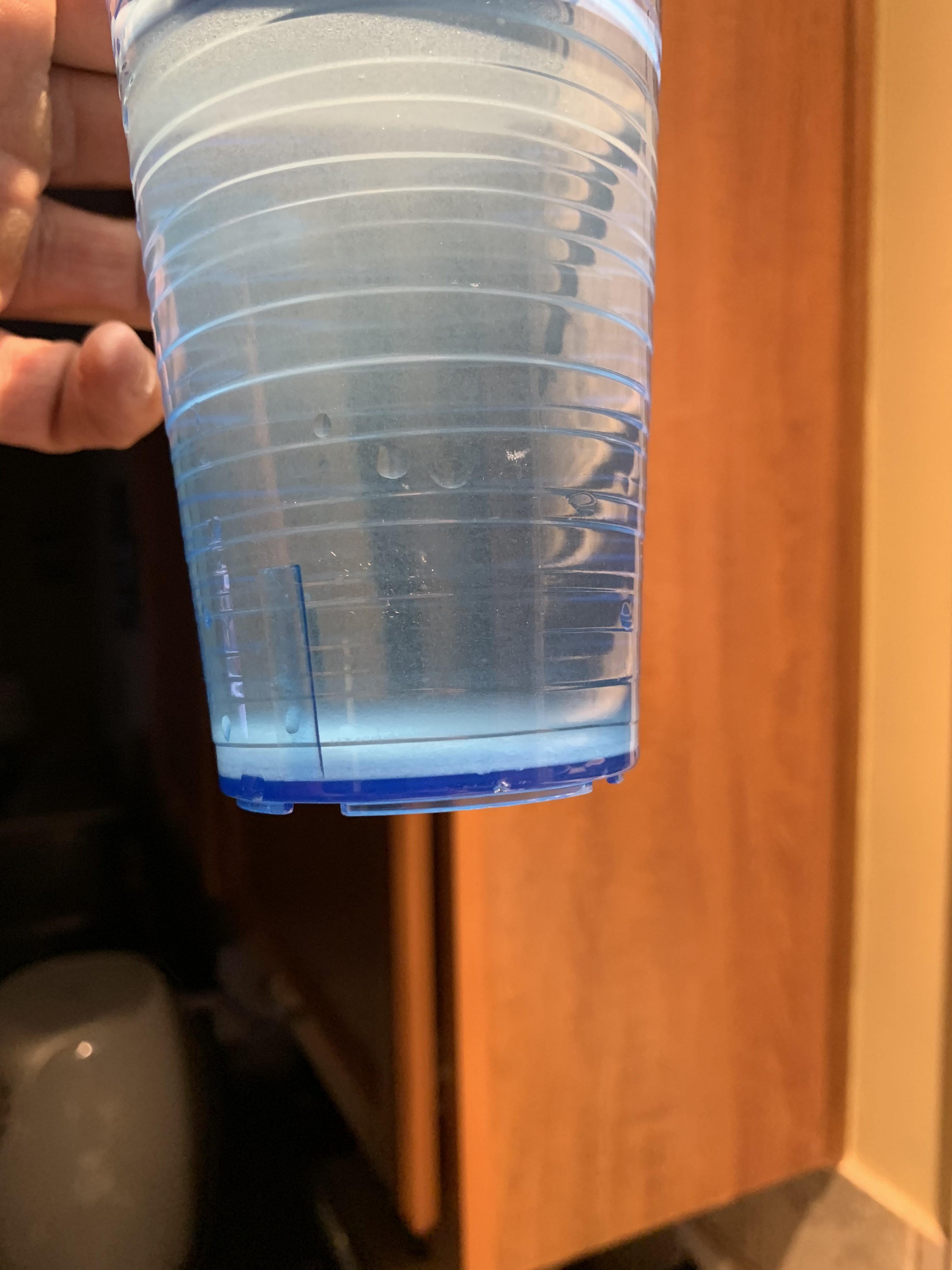

I mixed a teaspoon in a glass of hot water and let it sit for a few minutes.
Easy to see the powder at the bottom of the glass.

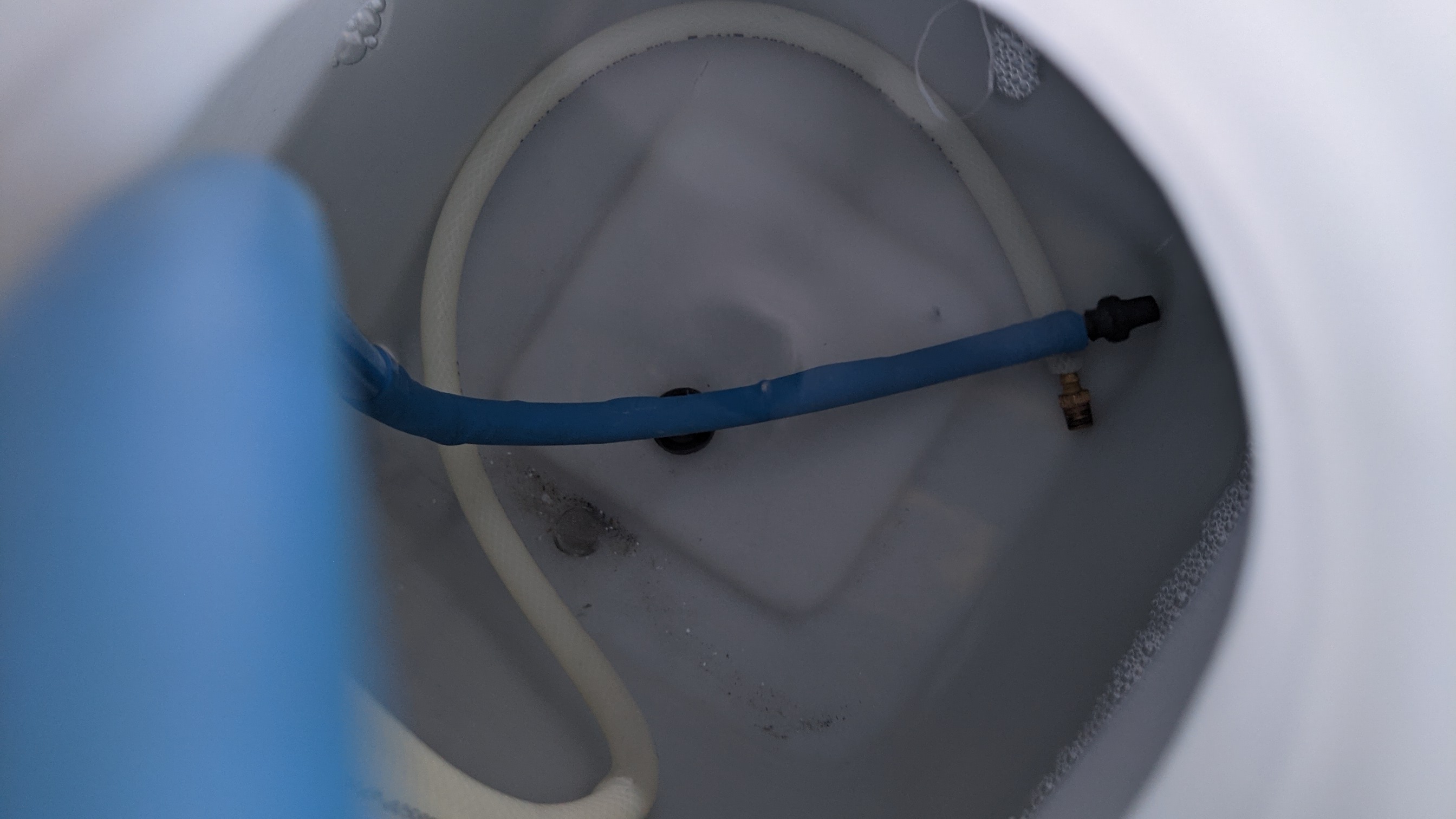

lemmie help you with mixing powders
do you have short piece of solution line?
If not, get one.
(or use your sol line)
When mixing powders, use hot water from the TM, while using the hose to stir while filling
fill your jug while bleeding off hot water at shut down.
