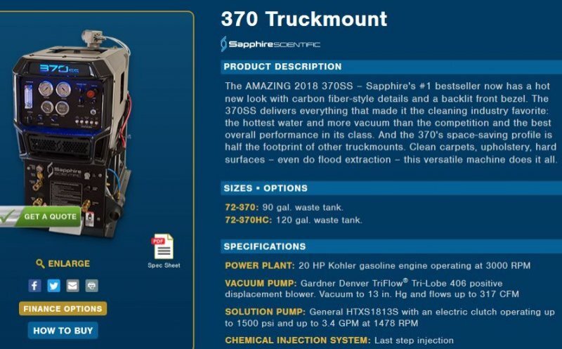

I just noticed the that the ss 370 has 16” hg but it has the same blower as the 2500 which is only 13” hg Why would that be @Larry Cobb
Larry Cobb
5,795
Larry Cobb
Just checked at the website:
Still says 13" . . . Behind the times.
Mikey had to change vac level on his 370, since he knows better.
The industry was @ 15" years ago.
