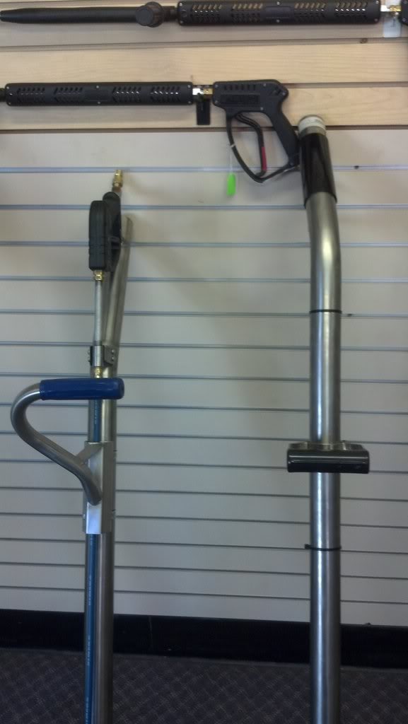

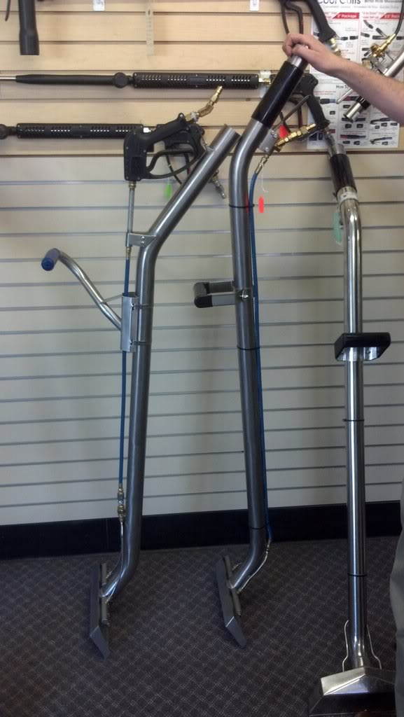

Zee was asking me if I felt the Ergo wand would fit him, I went by Proline in San Carlos today to check them both out.
my custom 4 jet Ti is 6 inches longer than the standard version so the both felt short to me. The Ergo does feel like it's in the right spot though..
Zee if you want to back out, Eckman will gladly take a Standard version instead.

Even though the ergo gun grip wand is shorter.
It will provide a longer stroke than the regular valve wand.
The ergo also has a better angle. The ego gives the what I call sawing wood angle which is better for your body.
The lower valve is a bad motion for arms, shoulders, wrists and fingers.
Try each angle with out a wand and you can see the difference. The lower valve angle is much more awkward.
Jeez...I could use Mike's Ti wand.......if I strapped on a pair of "drywallers" stilts!!
S
First off with My Ti I move the handle up to the bend, I dont look to have really long wand strokes but if the handles is where its at on that ti wand that would not only kill your hands but Your back also.
The idea is to stand straight and use Your legs not Your back.
