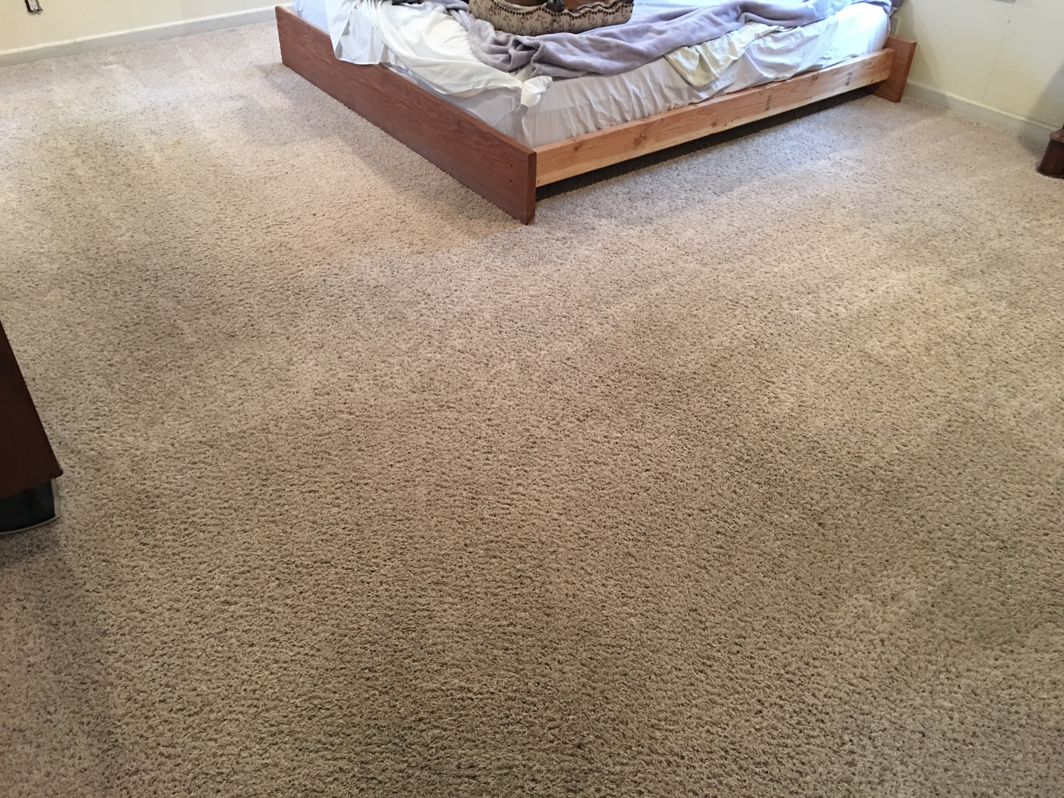

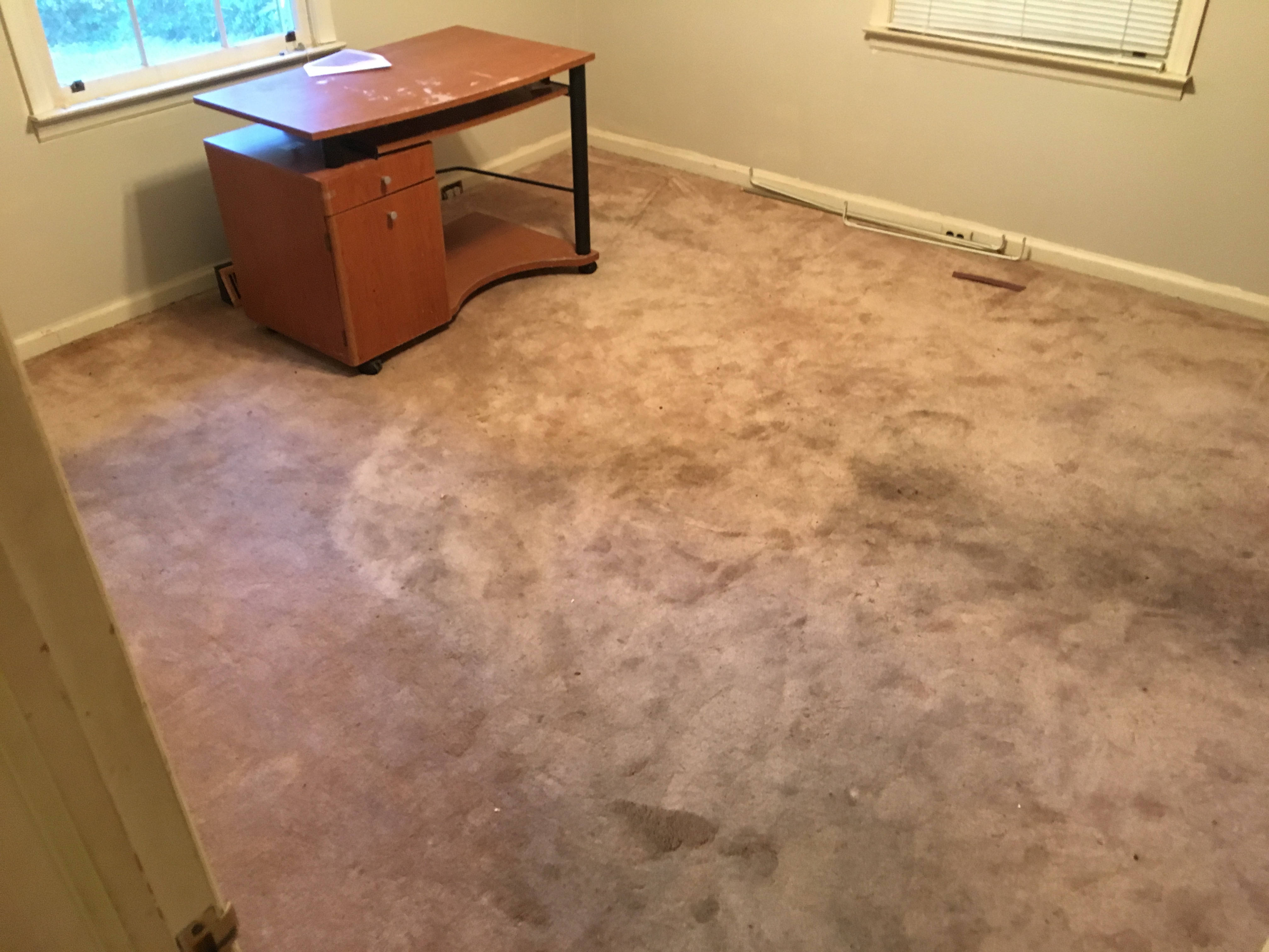

12 year old Lab sleeps in this room. Hadn't been bathed since 2014. The dog that is.1st pic was dry when arrived. Just mixed as directions. No prescrub.
Upstairs shot is just an in home office.

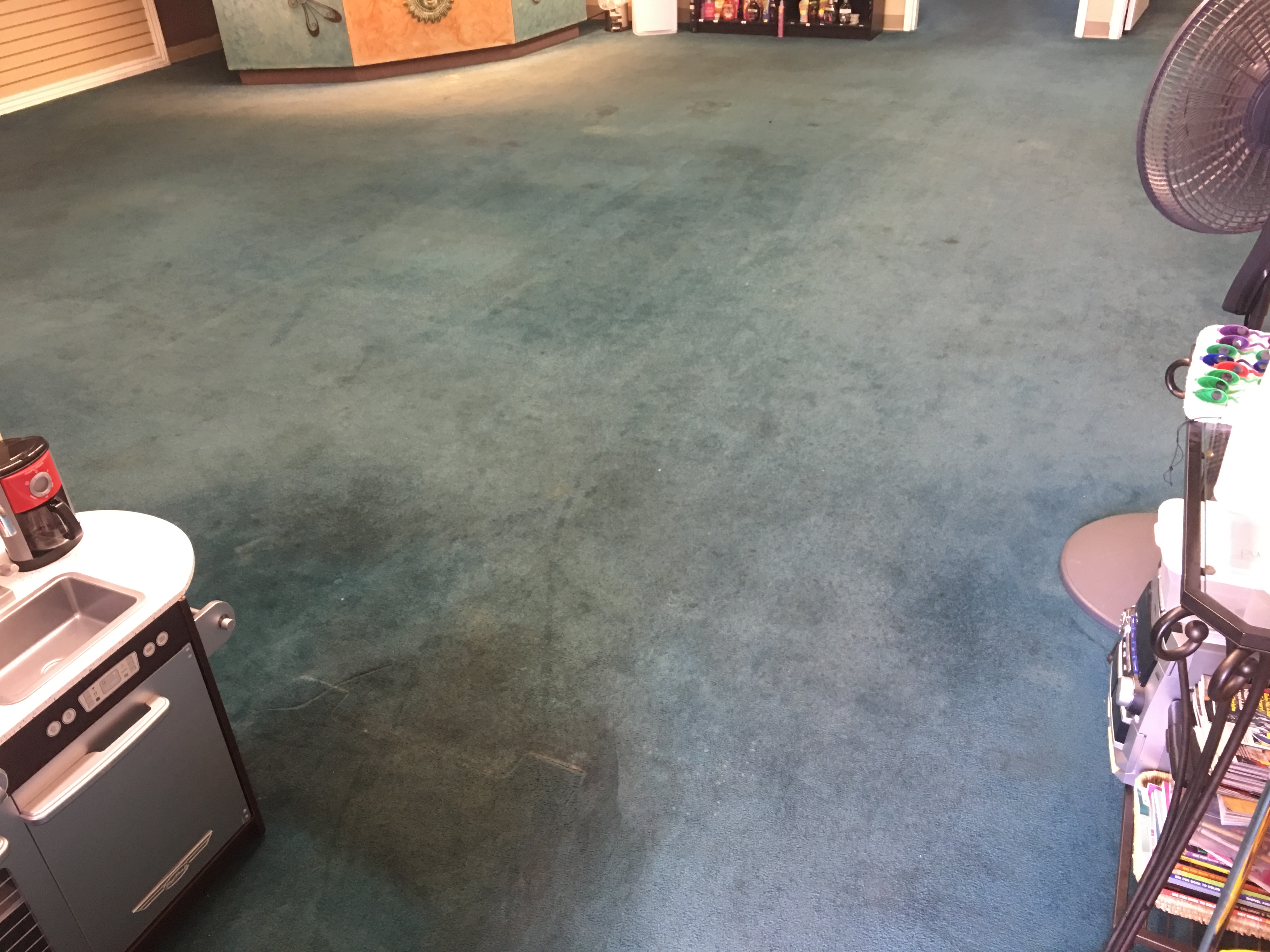

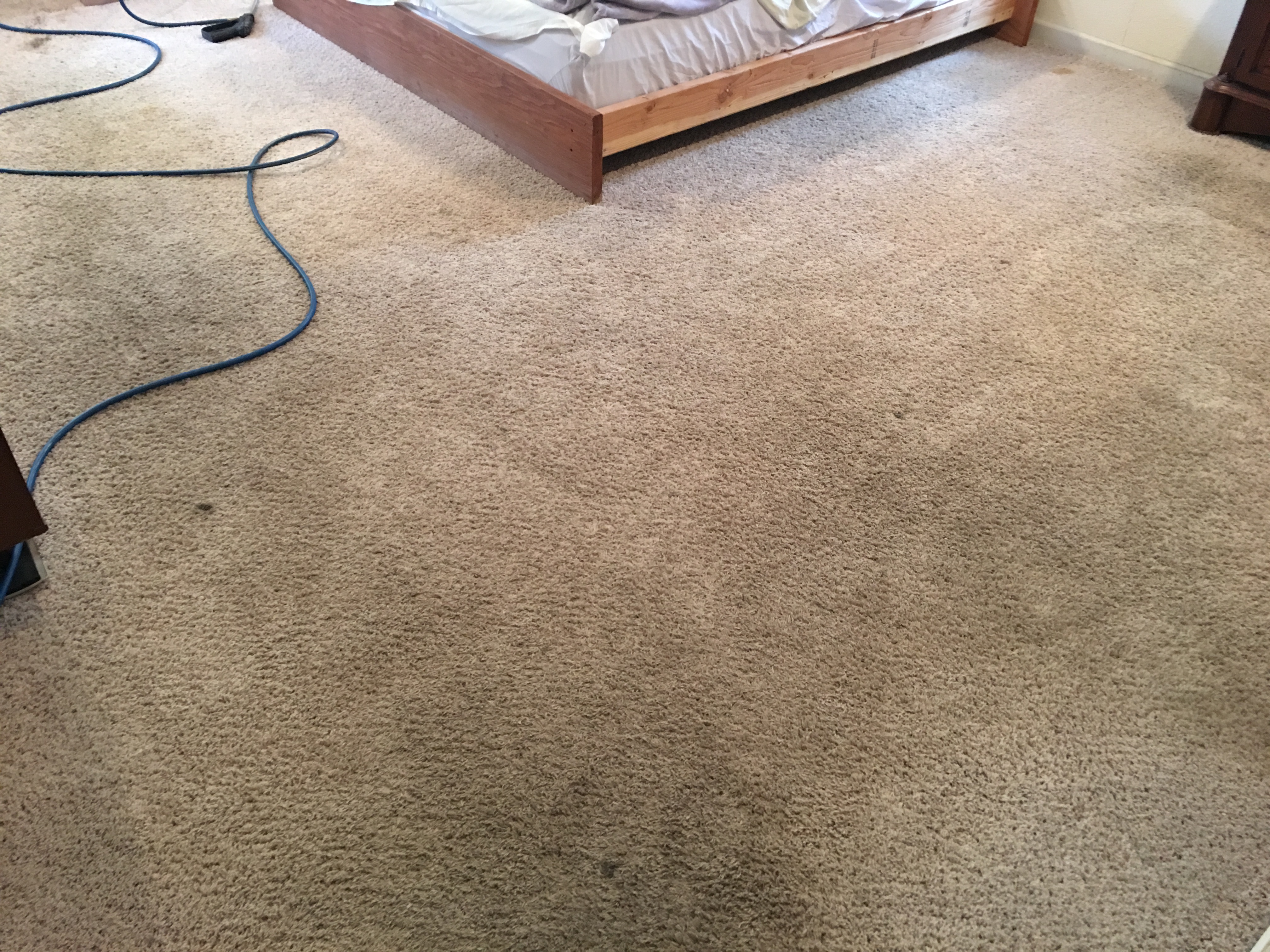

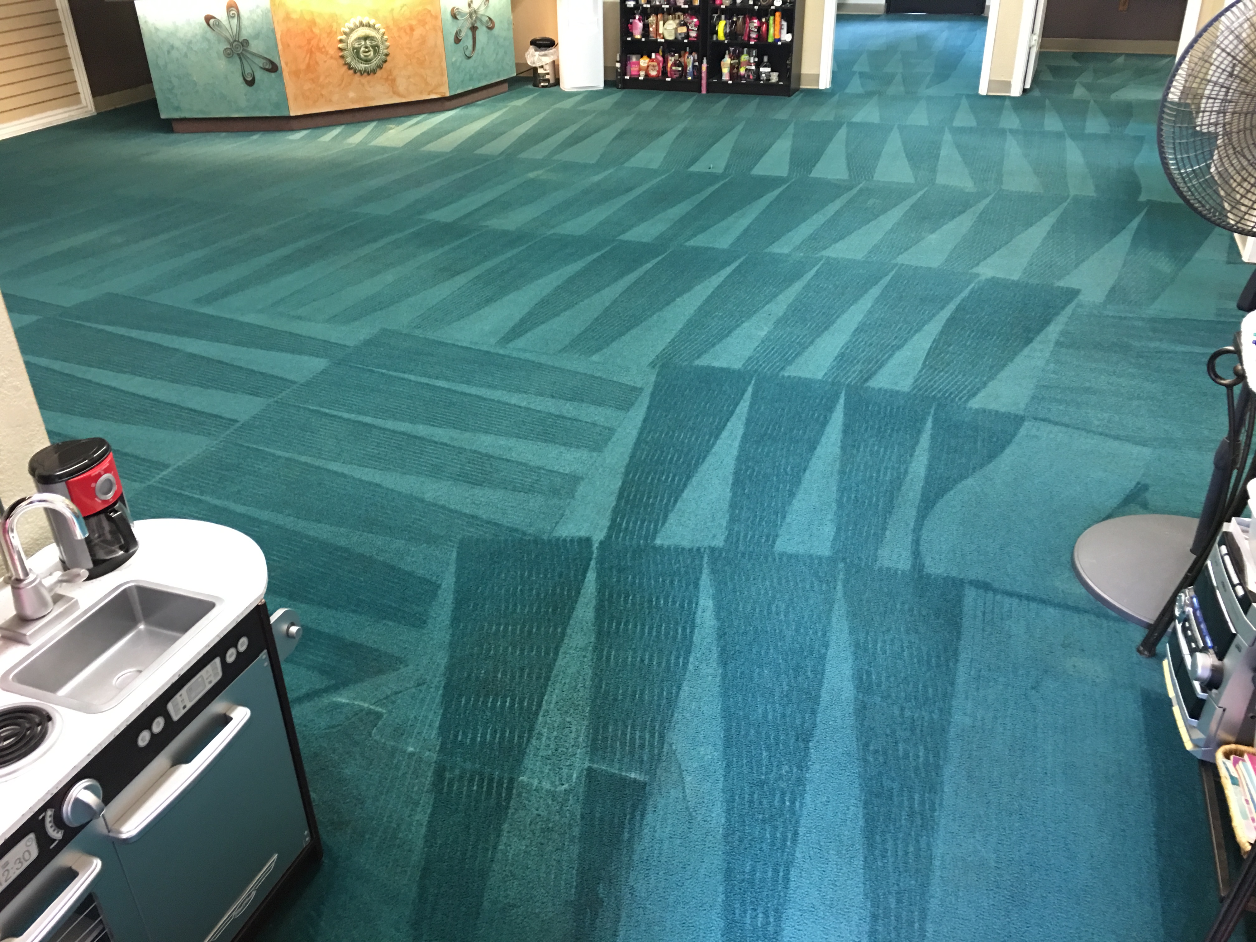

Today I cleaned two places that were both a mess. The first place was a Tanning Salon that hasn’t been cleaned in years. The other job was an olefin carpet I did for free. My buddy just lost his son, and with all the people coming over to pay their respects, his wife was embarrassed about their carpet. The white Olefin cleaned up well but there was just so much wear it still looked rough.

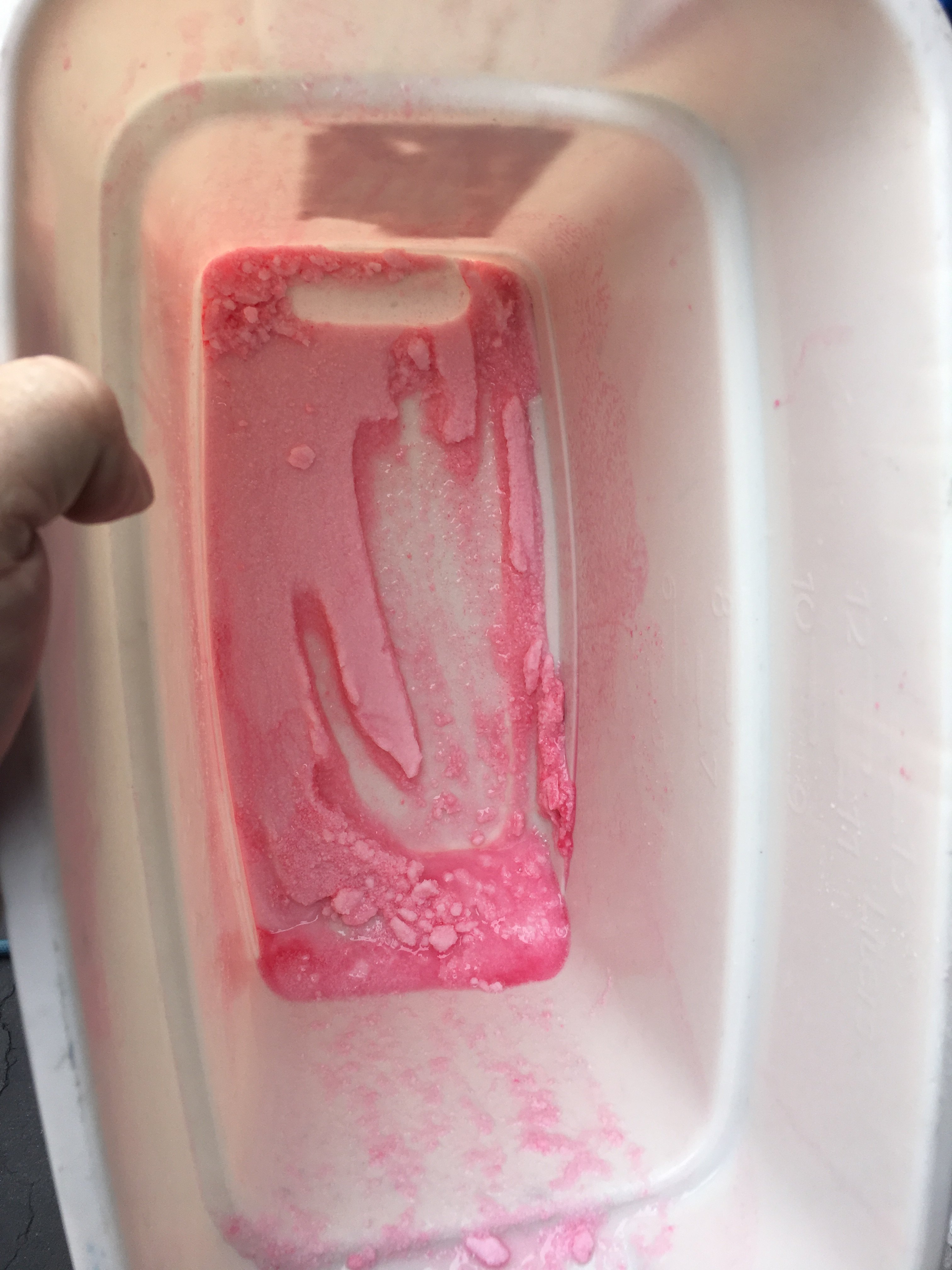

The ultrapac doesn't seem to mix well. After mixing in my special bucket and agitating the water, it was all settled at the bottom. I tried experimenting mixing it with both hot and cold water and it still was problematic. I eventually surrendered and used a stick to mix it. I’ll continue to mess around with it and see.
One thing that concerns me a little is how safe, aka ā€œgreenā€ is this product? The warning label about Ethylene Oxide has my attention. I wear gloves.
Here are some pics and before and after pics of my day.

How much product did you use. Looks like enough residue to make up several hydroforce's. Any product that is 12.3 pH is probably not very safe or green.

1 scoop per gallon as per the instructions. I’ll keep testing. Maybe the humidity and rotation of Jupiter in relation to the sun had some affect.
