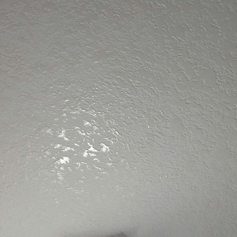

Day of texturing the ceiling. See picture of results:
Explanation provided in next post.

It looks great. Don't know about the knock down finish, it hides imperfections but DIY repairs I think are easier with smooth or orange peel. What type of volume are you thinking you will and possibly could get through their.
Smooth may be easier for you but certainly not for me----I own a few rentals and I hate matching smooth.... I cannot seem to get anything Flat or Square---but I am always working on houses in the 60-100 year range. Thick texture hides all my blemishes.
The preexisting ceiling and walls already had the knock-down look. In this instance, we took ALL the weak joint tape off since it was not secure. It had peeled off in some places and in others was not mudded appropriately. Additionally, we put in a long control joint in the ceiling because the long span had a crack in the drywall. This likely occurred over years from the trusses moving in the weather shifts due to the seasons here in Michigan. Since we had to re-tape and finish the drywall, the knock-down look was re-introduced where needed. This is not a difficult thing to do with the craftsman and tools we have on hand. The new walls for the Tumble Duster and Rug Hanging rooms were not textured.
By the way, repair is fairly easy to do if a need arises.

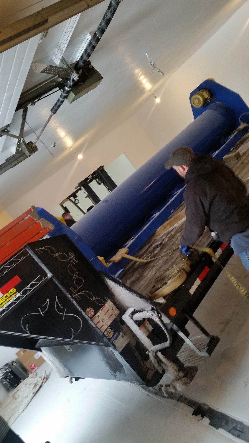

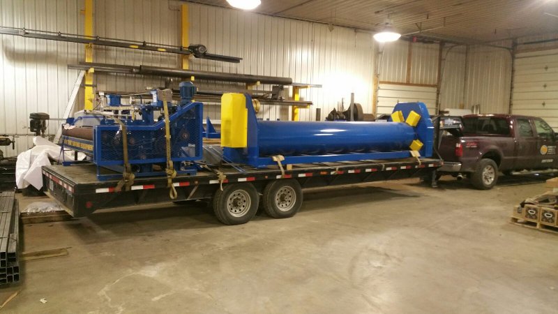

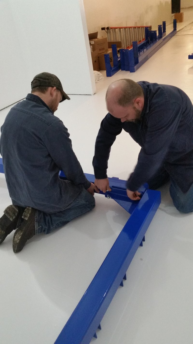

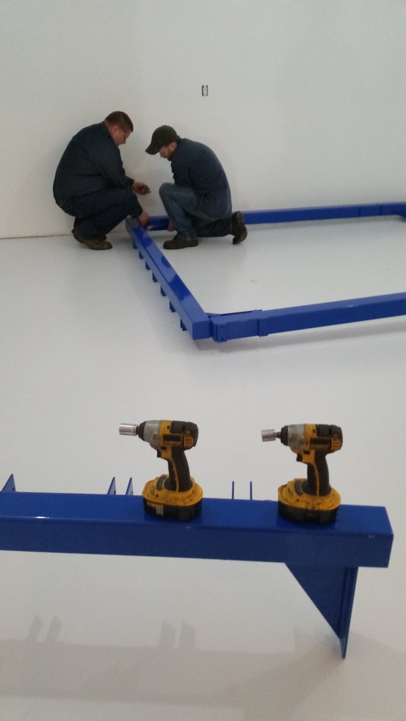

What happened to the great blue sky and sun we had last week! Monday brings the drama and another phase to rug plant development. The installation of equipment:
T Monahan
Sep 9, 2012
1,675
Tom Monahan

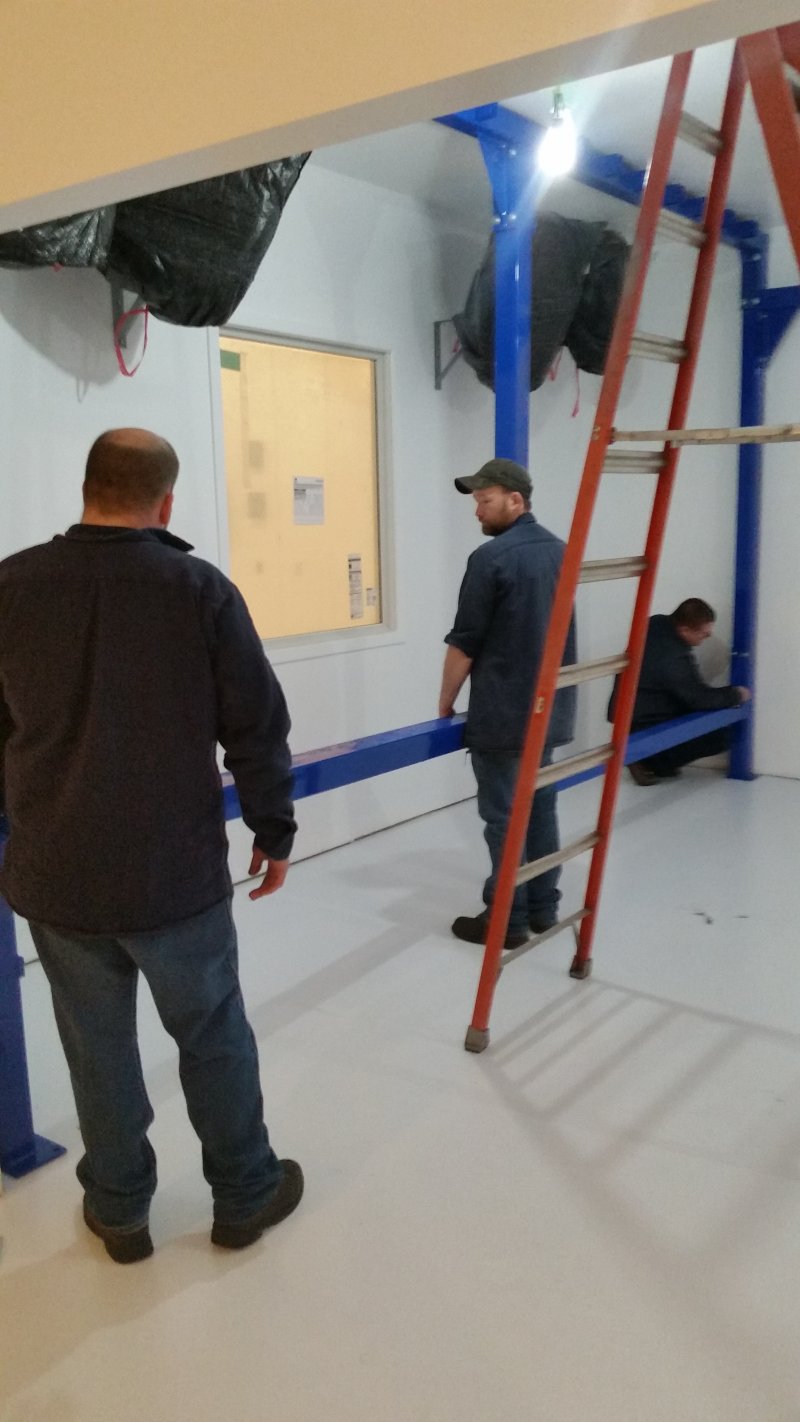

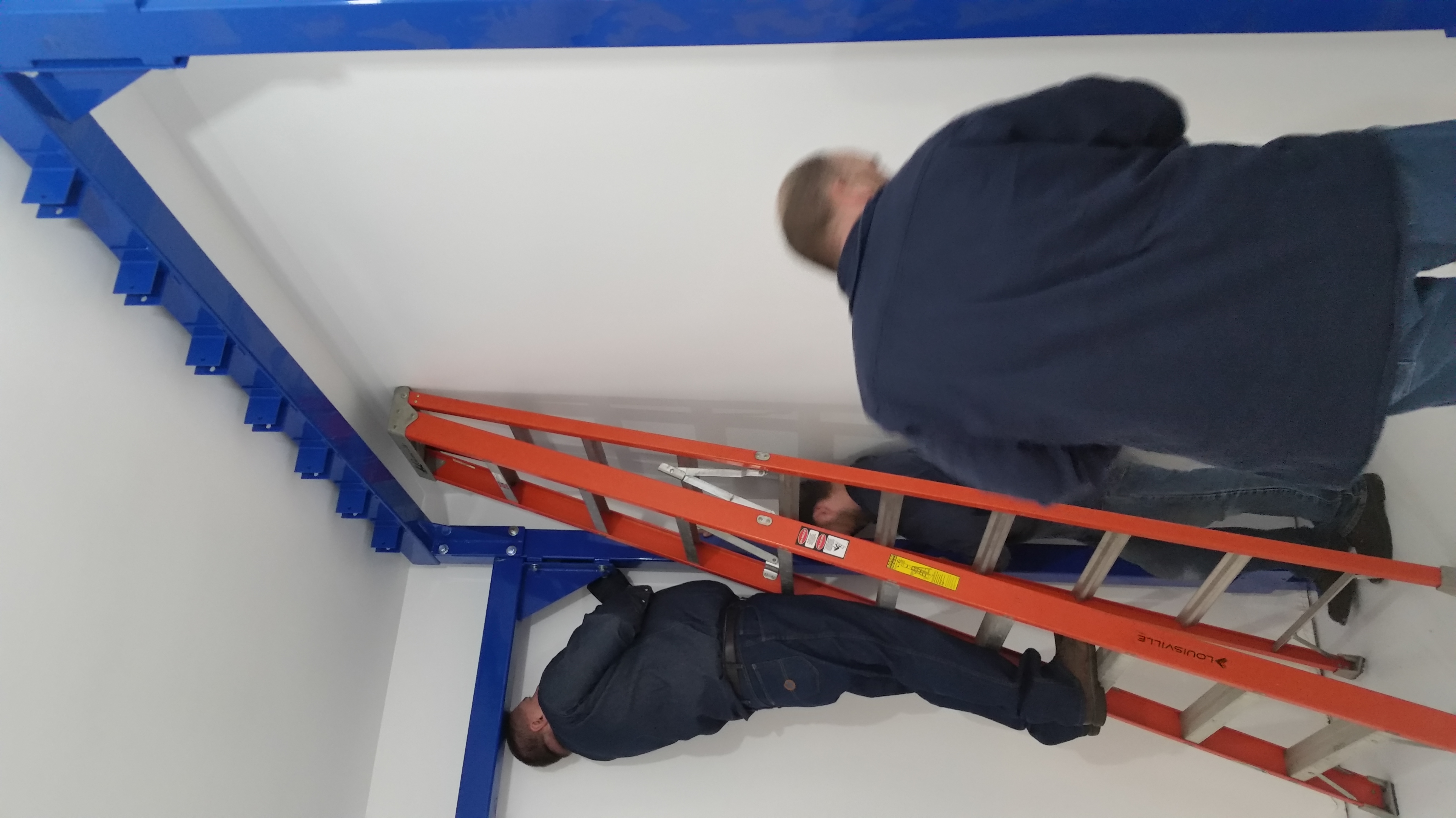

Dry tower layout for installation:

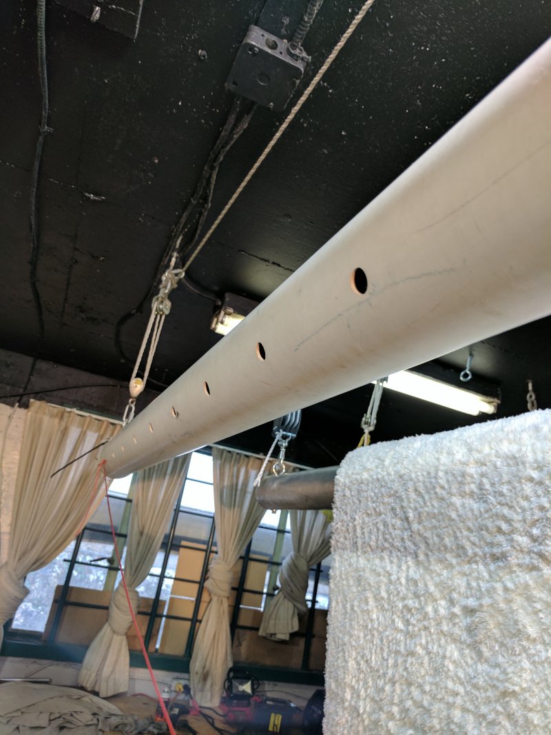

A little something we have suggested for over 10 years: Corrugated drain tile over steel pole tubes. The steel does not flex and the radius of the tile is kind for the rugs.
28,260
I use perforated PVC pipe over steel poles. I prefer the white over black.

I think that is a fine idea Ron. We use the perforated ribbed (or corrugated) black drain pipe. Between the ribs and the holes it allows for some measure of evaporation to occur.

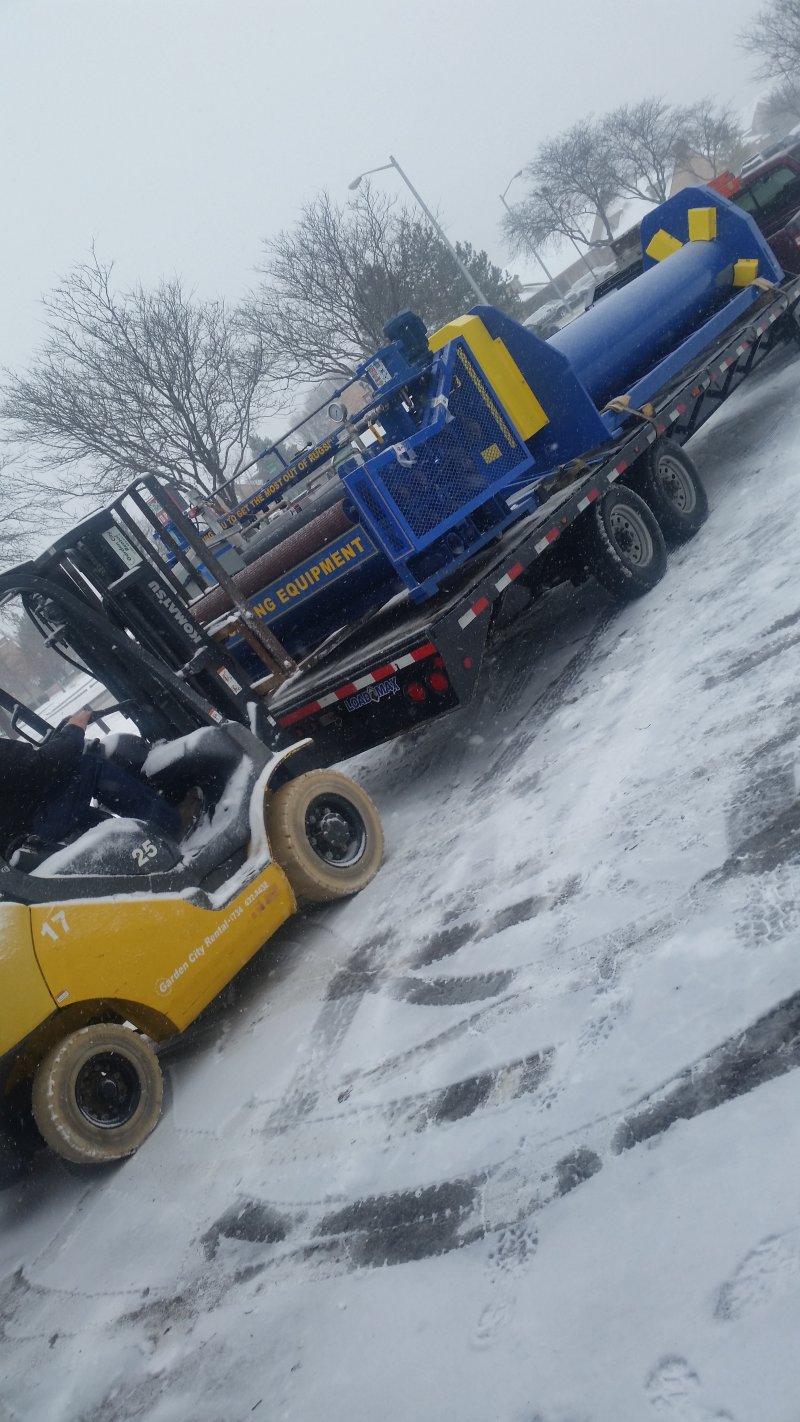

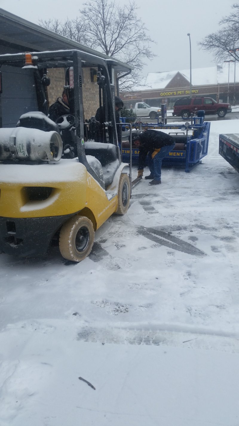

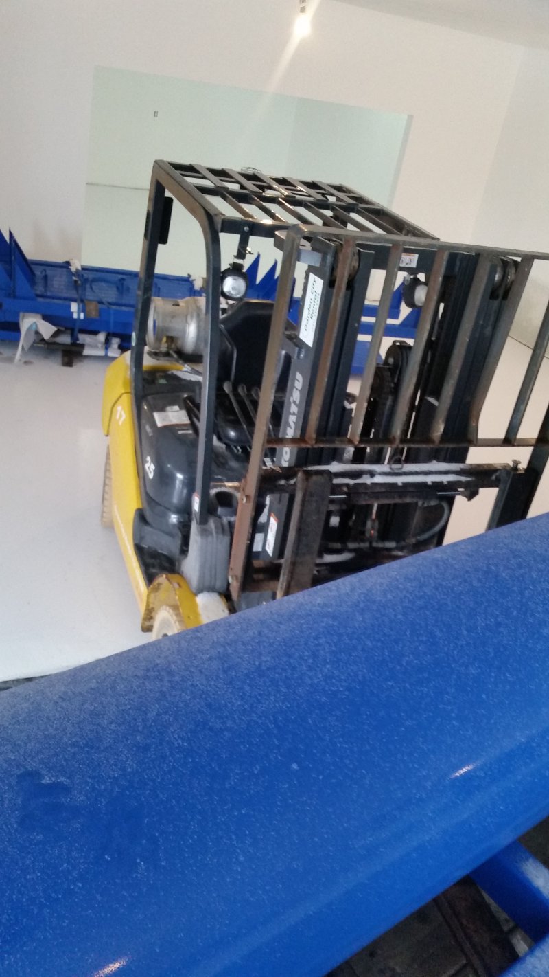

Today was clearer on the roads for the latest delivery:
