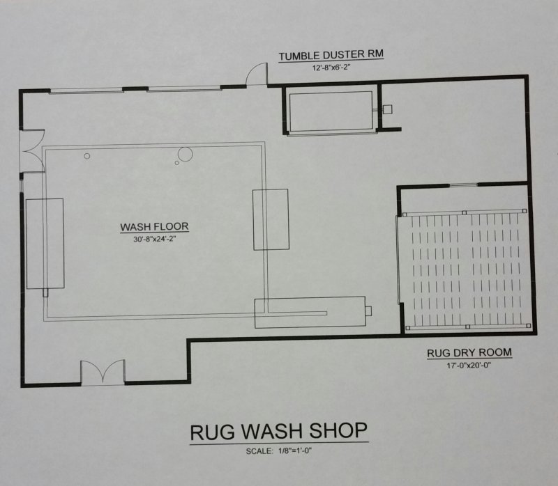

Tom,
Could you explain the layout with for the rug plant for flow of cleaning rugs, with the locations of each piece of equipment you are using? Also interested in where storage for clean/done and dirty rugs is with this lay out? Do you have this detailed on graph paper? I did see the sketch in the first few posts, just looking for more detail and understanding of space and sqft needed operate properly. Also what is the actual sqft used for the rug plant, minus all the office, show room, training area's? Thanks, really liking this thread!

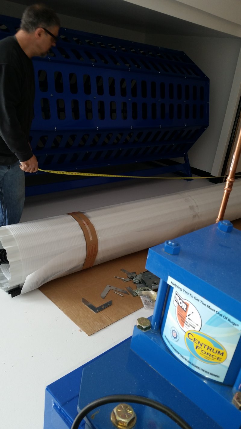

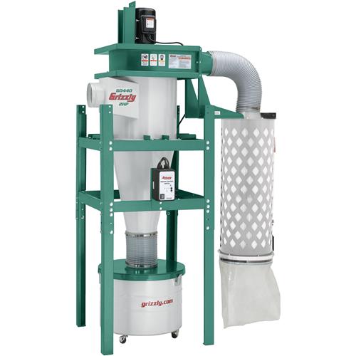

Nice set up Tom. I'm just wondering if you vent the area with the tumble duster or is it not necessary?
I am waiting on the delivery of my Dust Collector. It will draw air by ductwork from inside the room They were out of stock when I ordered it. Here is a picture of it:
60 seconds of overview on how it looks is today in the afternoon:
28,260
It looks very compact and very efficient. Can't wait to see it in operation.

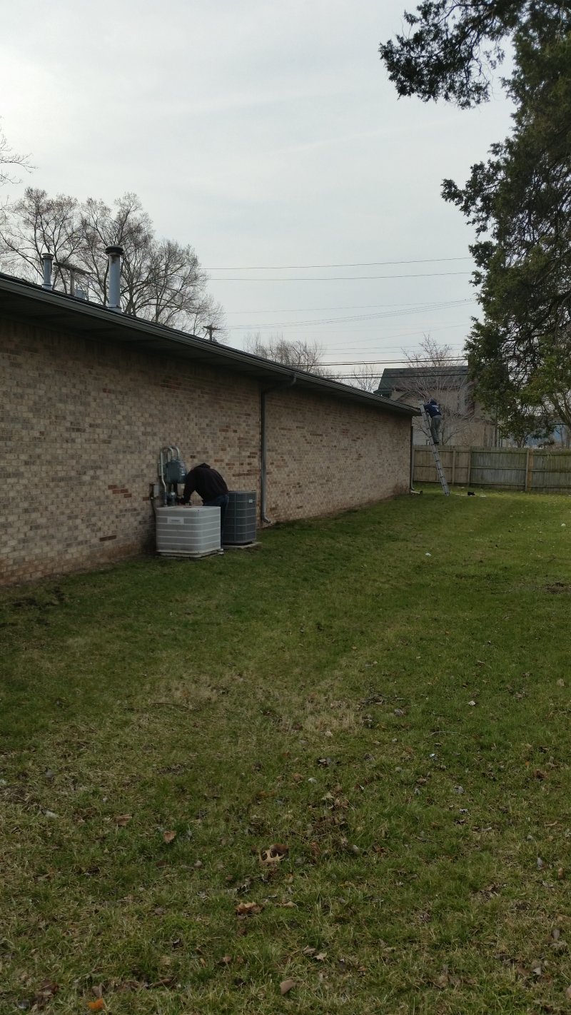

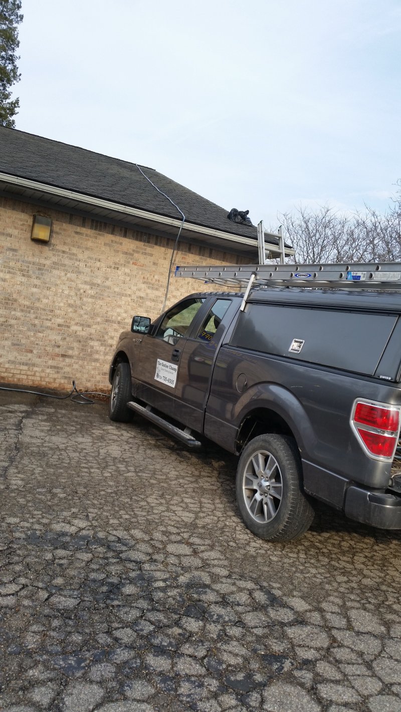

I was reminded to clean out the gutters after the high winds weaken them a bit. A contractor secured them better and subsequently cleaned them out today too:

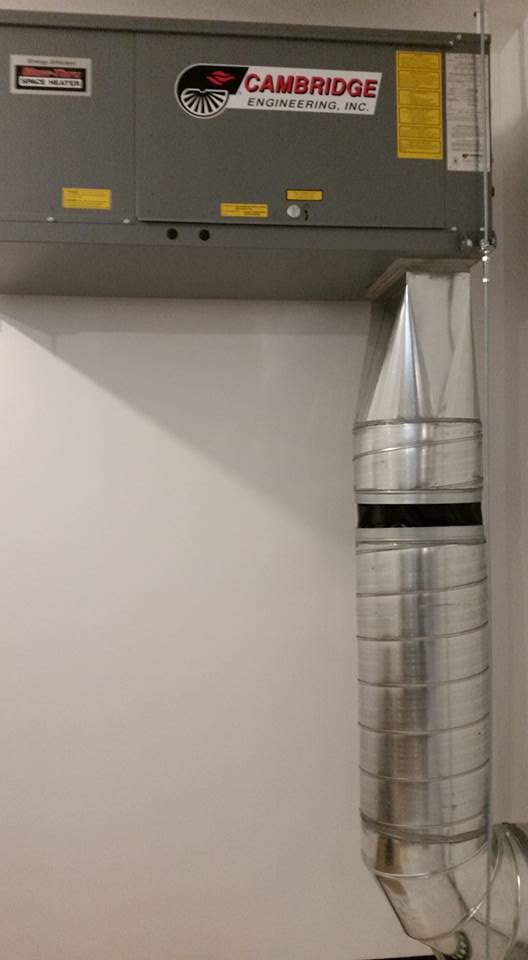

Excuse my ignorance---This is the unit that pulls the air from outside, heats it and then heats your drying room? With the Exhaust coming out of the Top of the room---grin--?
Are you going to harvest any of the exhaust heat? Maybe to preheat your hot water?
The moist or humid air is evacuated outside at the same cfm it enters the drying chamber. It runs on and off on a cycle. No plan was eveer intended for savaging the humid air. Think like a clothes dryer in your home. Same principle. It is more economical than dehumidifying.

My thought is build a water preheater heat exchanger like a TM.
Wrap 200 feet of copper Tubing around an 8 inch pipe to make a coil. Suspend the coil inside a 14" inside diameter Sewer pipe. The stick you suspend the coil on could have notches to keep the coils apart.
The air intake to this would be right next to your ceiling. Slope it down so the condensed water goes to one end to drain. You can run the drain into one of your trenches.
Run the water through the copper coil before it goes to your water heater.
Since this is all inside you don't need to worry about freezing.
There are no issues with overheating the water or high pressure like in a TM so this is really low tech, low risk.
I would bet this would have a very fast payoff.

With your fabrication skills I'm sure it would be much nicer than what is in my head---
The one I built in my head has about $300 in materials. The payback would be quick...

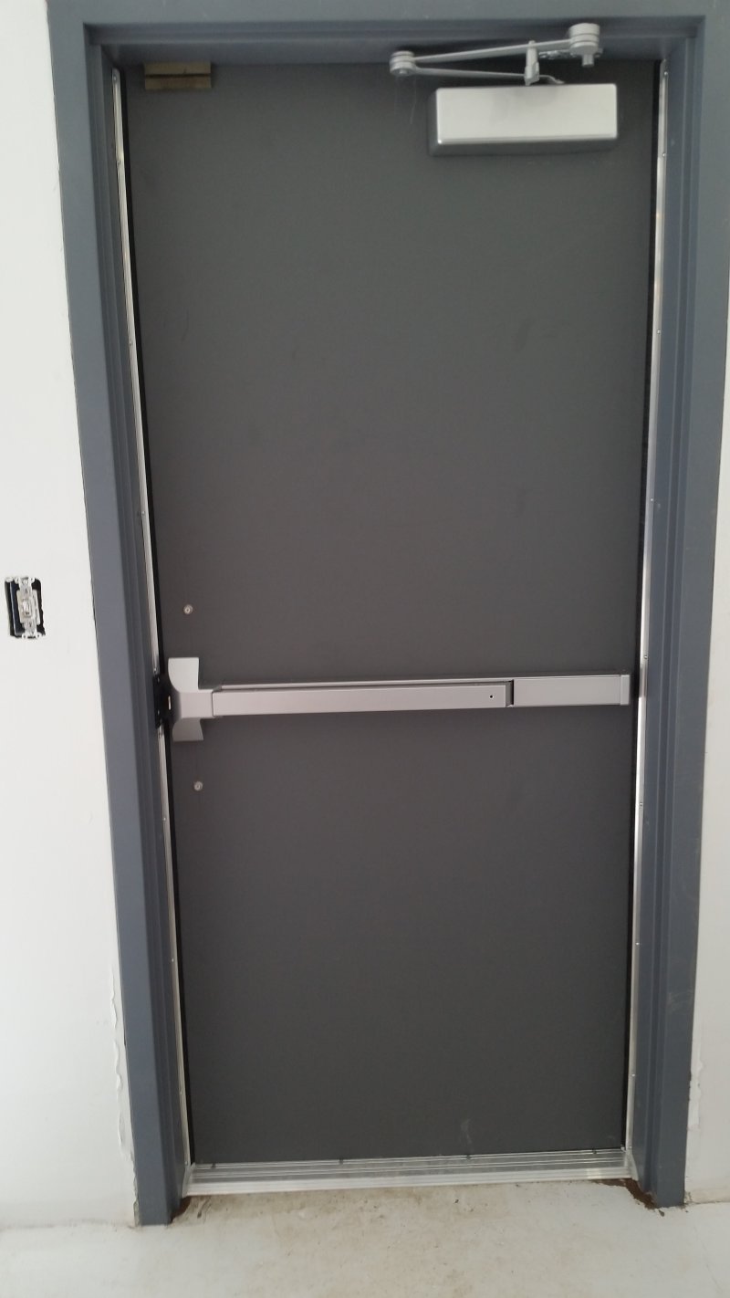

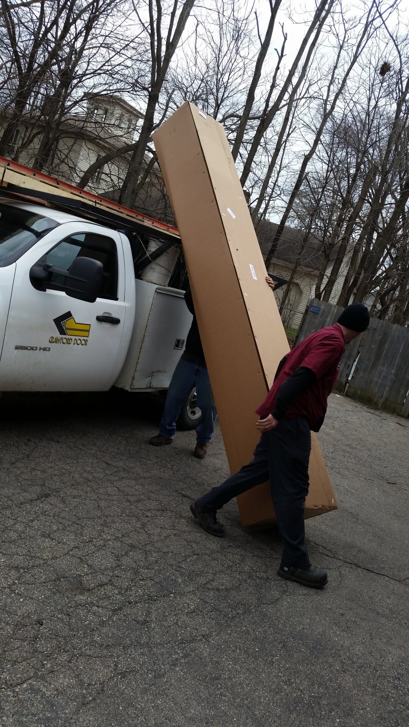

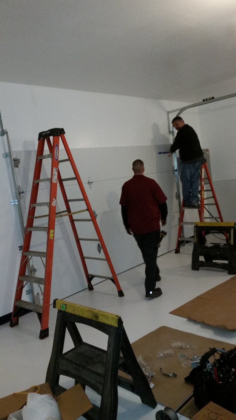

Finally, the custom doors have arrived! Hanging the Dry Room Door first:
T Monahan
Sep 9, 2012
1,675
Tom Monahan
Project continues to Tumble Duster Room with a different style of door:

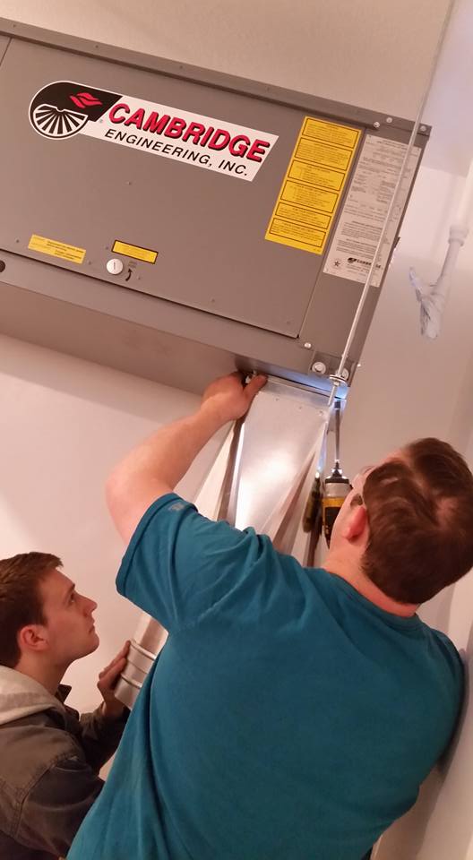

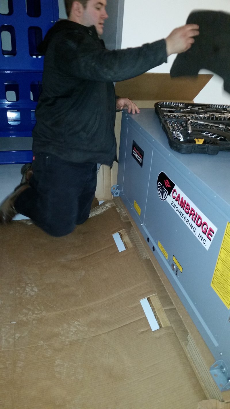

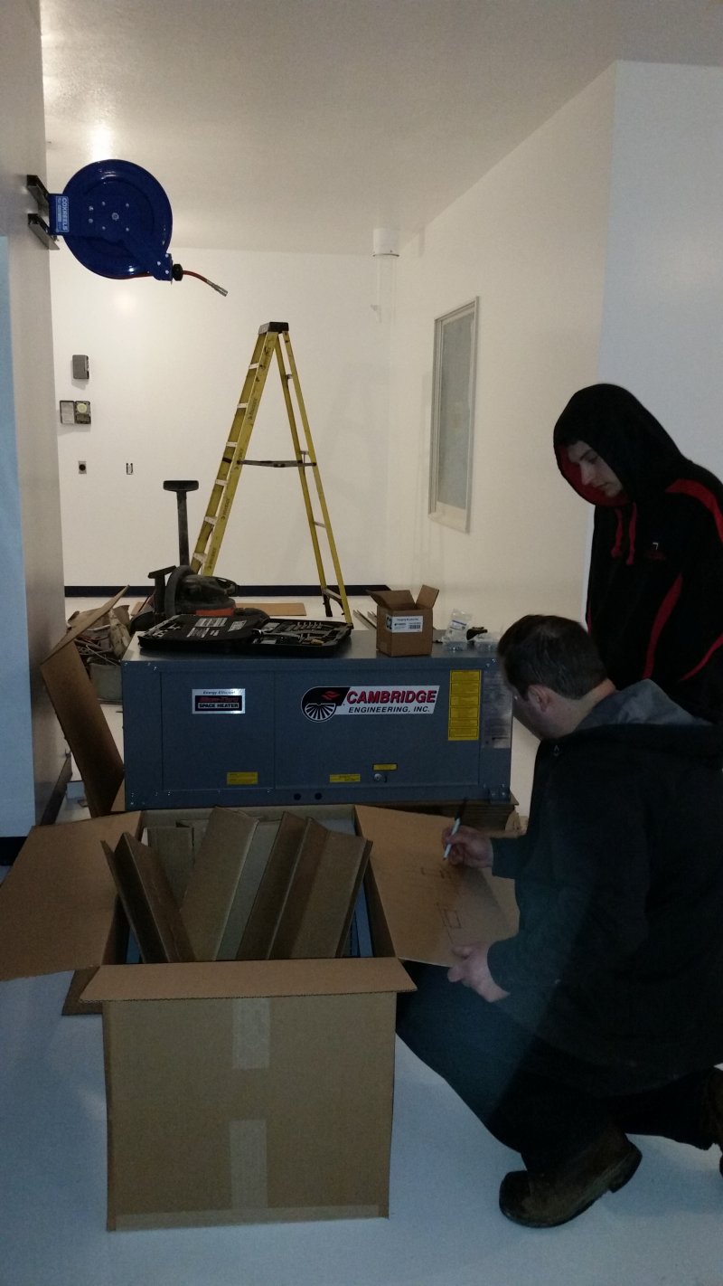

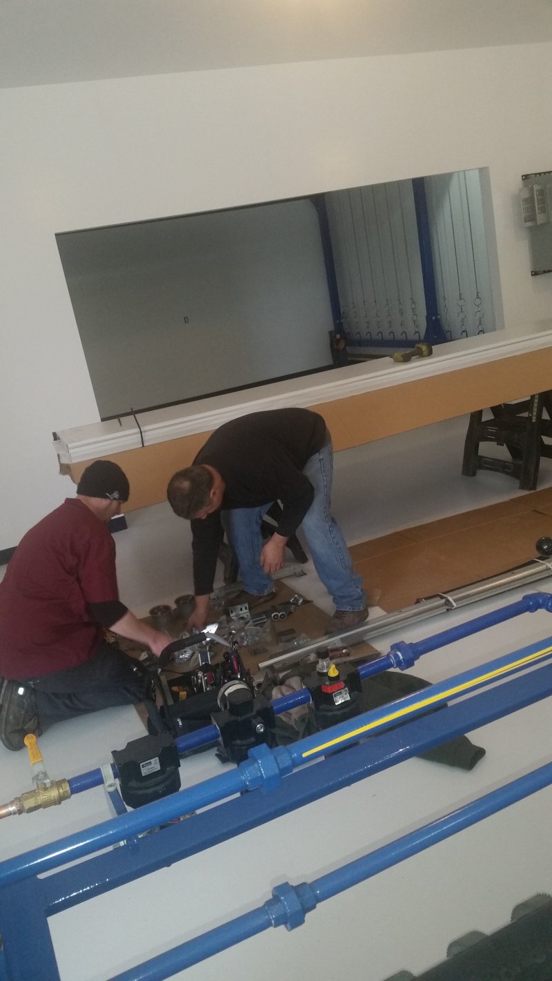

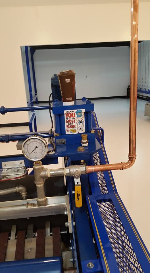

Back on the Cambridge Unit installation:
Waiting on some parts still on ordered and will be back on it next week.

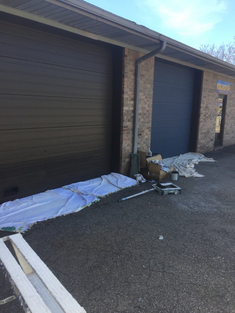

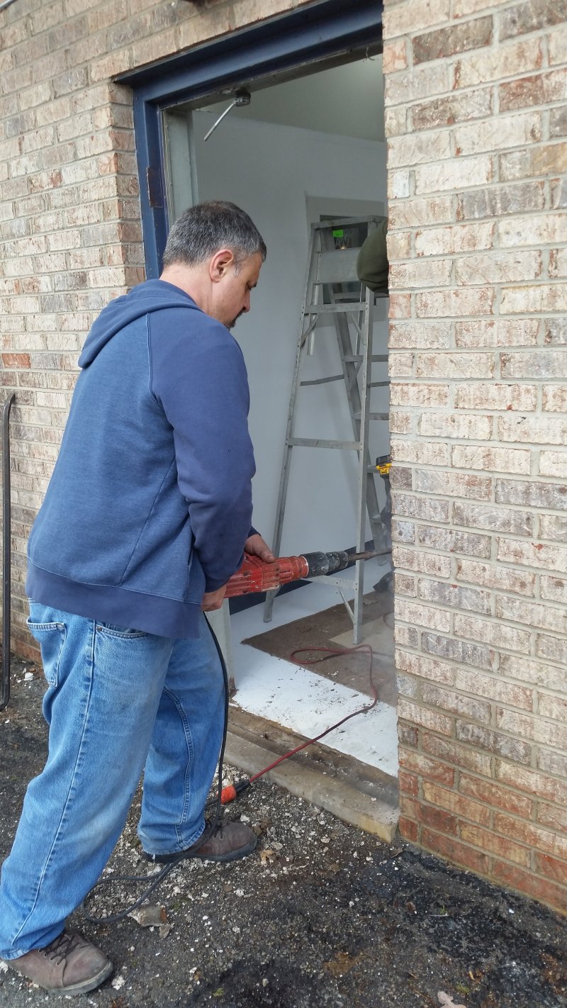

The weather this Saturday got above 60 degrees. Therefore time to paint exterior doors.
The Max Scherzer look to start things out:

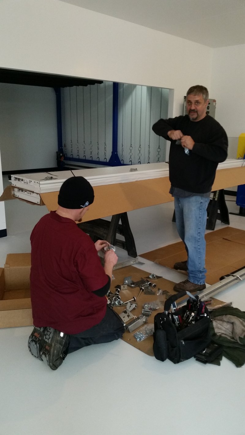

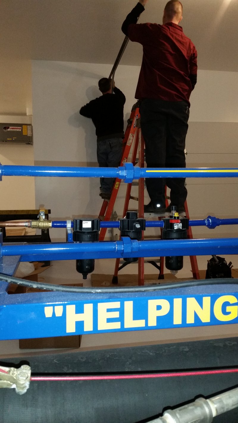

Now it is the electricians turn to do their thing. They showed up with plenty of fixtures!
