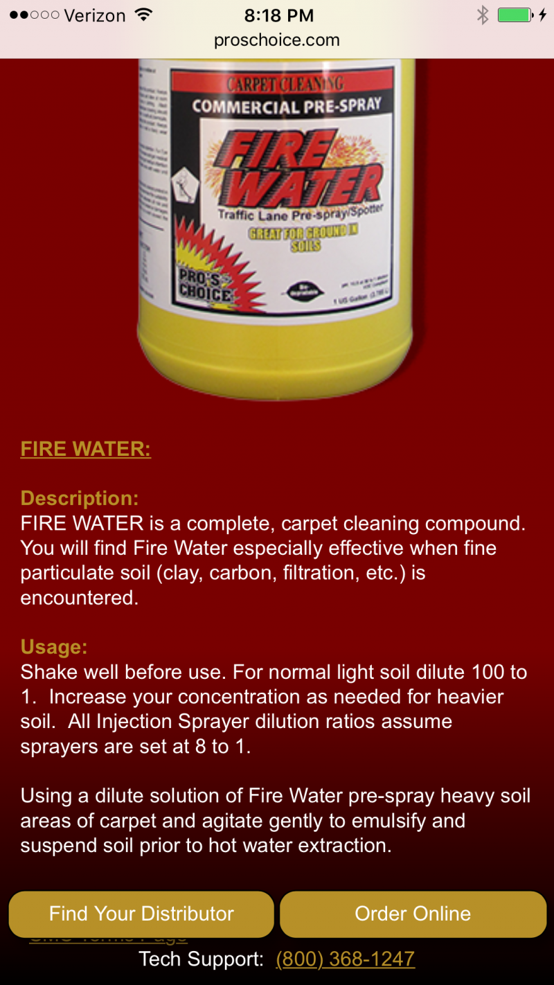

Anybody ever use Pro's choice fire water? Directions say for light soil dilute 100 to 1 assuming injection sprayer set to 8 to 1.
so how many actual ounces do i add to a 5quart injection sprayer with the 8 to 1 tip on it if I choose to use my injection sprayer
OR
sometimes if i get a real bad one i like to use my 175 with solution tank and carpet brush (shower feed) and apply and scrub at the same time so how many ounces per gallon would i use in this situation

I think 100:1 dilution is way too light. But whatever. I'd just start with 8ounces in your hydroforce filled with water. That'll be 62:1

I copied and pasted their email response to me, here it is
Hi Kevin,
If your injection sprayer is set at 1:8 you can add 8 ounces up to 24 ounces of product with the balance being water (with heavier soils get closer to the 24 ounces and decrease for lighter soils). Don’t exceed 24 ounces because you will encounter foaming issues. If you are using a 175 use up to 4 ounces per gallon (it’s okay to go a little lighter here with the added agitation so 2 to 3 ounces is usually fine).
That was a good response from them. I use a 7qt HF sprayer with an 8:1 or 9:1 tip. I wanted to know exactly how much I could get out of it so I sprayed it into 5 gallon buckets until the HF was empty. Turns out I get 12 gallons out of it. Knowing that made the math real easy for me.

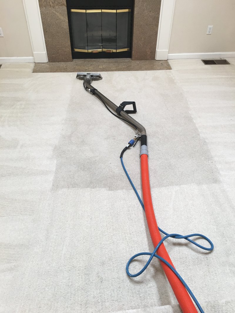

Used a bit of Saiger sauce today. I worked on this bone white piss soaked carpet for 8.5 hours today and cleaned 42 steps in this 3 story house. I'm so tired! Now I'm relaxing with some 99 Proof liquid love.
@Mark Saiger , it's about time for me to order more
So..
You don't see the streaks?
That should have been RE'd
That DamonWanding is gonna be the death of you....
Reactions: Steve Lawrence
Cleaning Professional
24,146
So..
I wasn't done, just snapped a pic real quick before i did any dry passes. I wasn't lugging a RE around that place . Every room was separated by hardwood. A real pain. I already worked 8.5 hours in that place.
You guys are worse than old hens.
