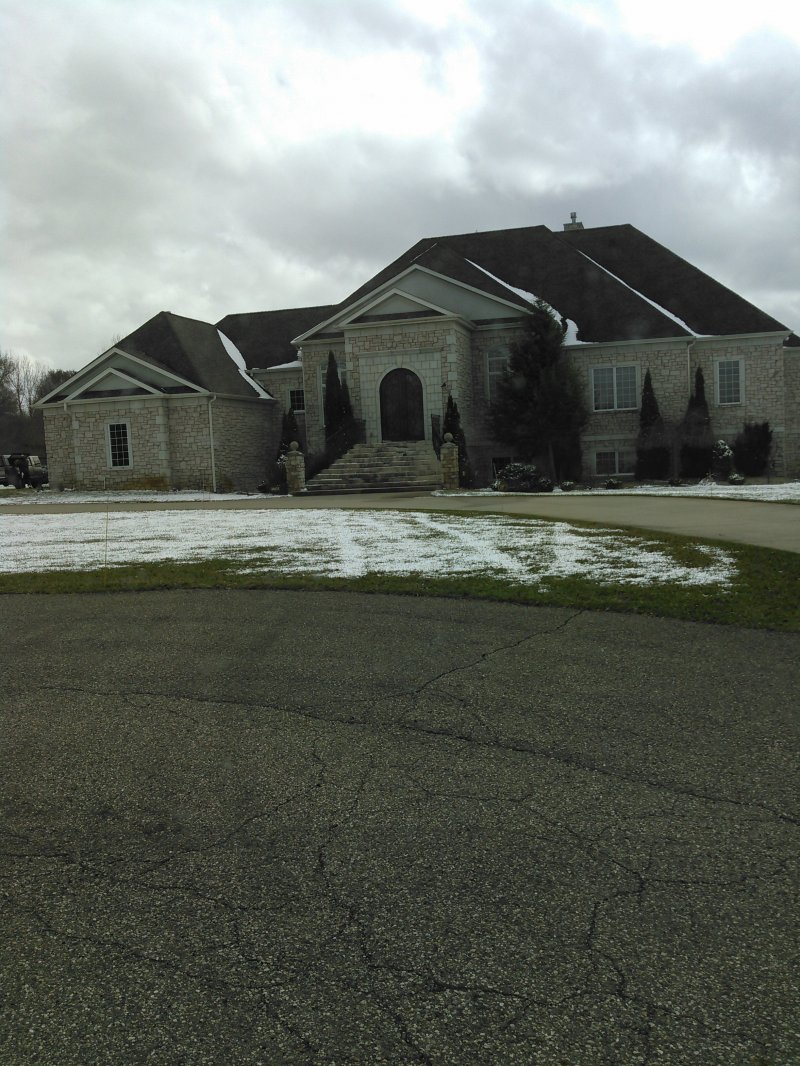

Mark Saiger what do you guys use to protect the floors from damage by hoses and what not?
Got a job that I need to cross about 50 feet of travertine that got chipped by the last cleaner. Close to my best residential job yet. Time to up my game some more.
I don't think a seal a door would work here, giant iron doors rounded on top, but it's on the list.
She got me from the internet. It was my reviews that made her call. A contractor referred someone else but she wants me!

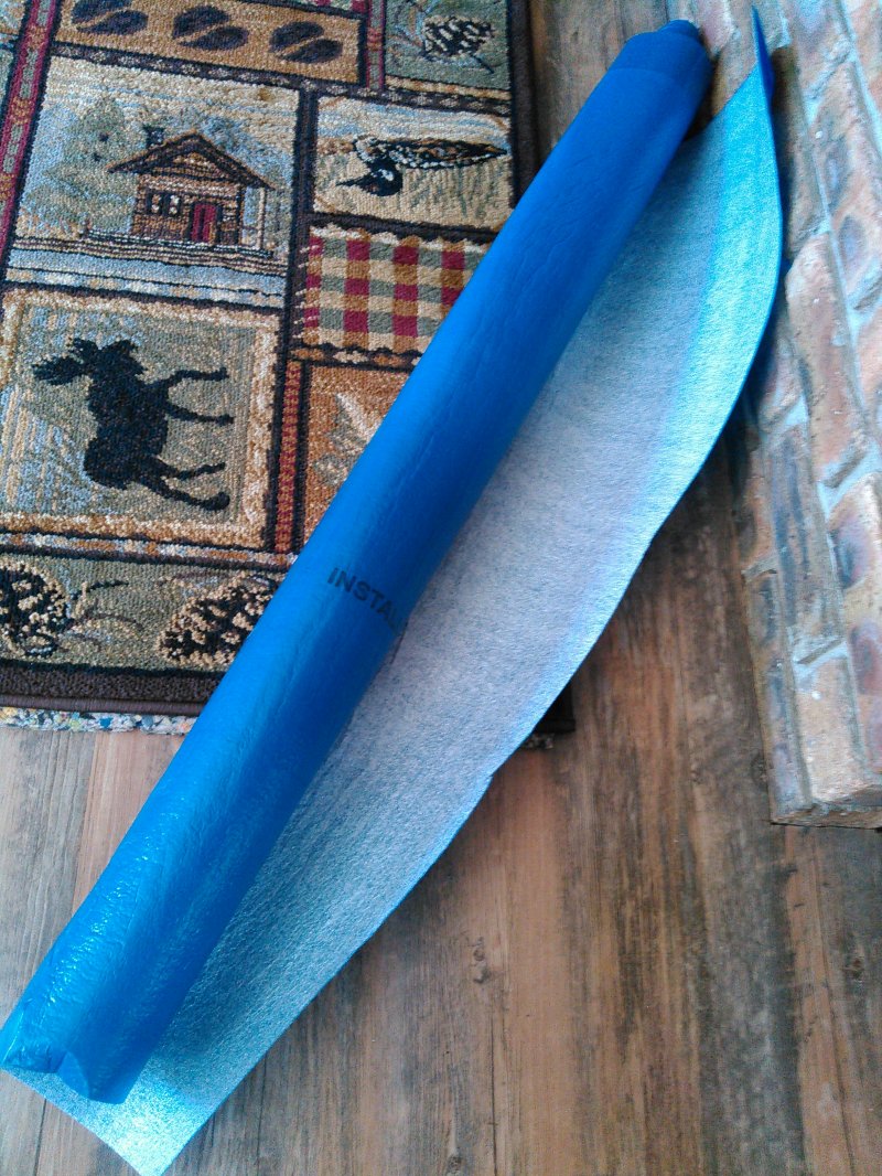

Canvas painter tarps
I want something with some padding and water proof.
Found something online I like but can't get pricing online. Thinking about something like the pad I used for my LVT.

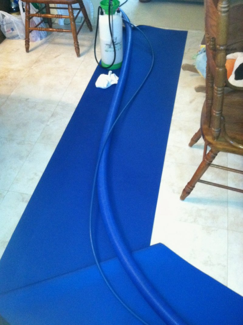

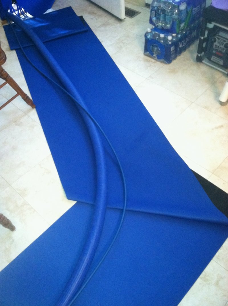

Yes, an end corner may flip up from time to time but other than that no movement. Roll and unroll quick and easy. They are made for the furniture moving industry.

I keep two 20ft. Long runners on van usually only need one at a time.

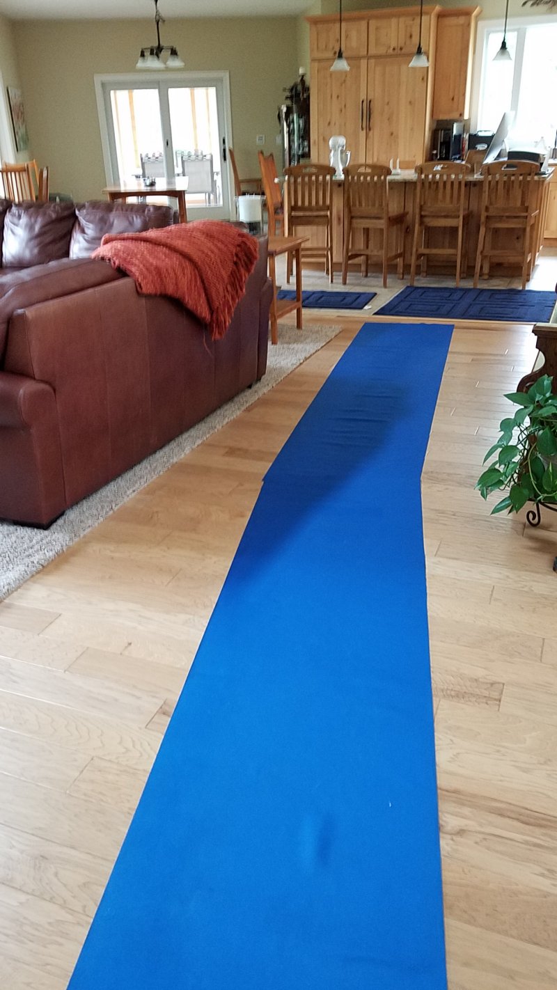

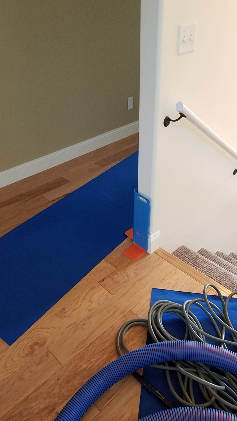

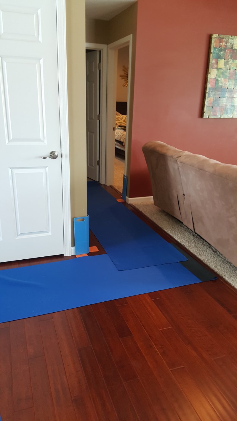

There is nothing better than Protect.
water proof
cleanable
packs up nice and tidy
looks way more professional than tarps and blankets
lasts forever

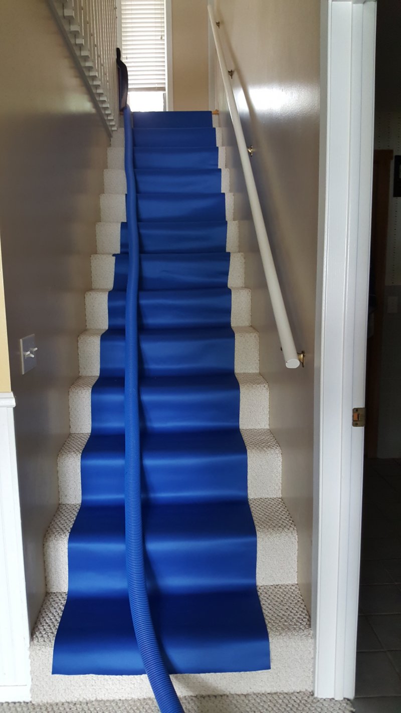

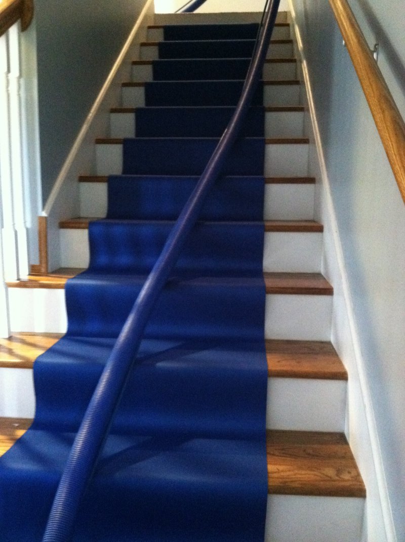

I have been using these neoprene floor coverings for some time now. We cut these 20 foot units down to 10 foot.
http://www.uscargocontrol.com/Movin...et-Shields/27-x-20-Neoprene-Floor-Runner-Blue
Also have some Canvas with Poly Coating Tarps for other types of floor protection at times when doing furniture, or more types of protection needed.
https://www.amazon.com/Essentials-4...-2&keywords=paint+essentials+canvas+with+poly
the Neoprene have been good for us lately

Stays put on stairs also. Can be purchased in 100 ft. Rolls, I just never need more than 40ft. cutting to 10 ft. Is not a bad idea easier than doubling over.
