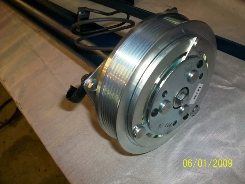

Dan, I appreciate the heads up on difference in model numbers, I did notice that. Yes I'm looking for "cheaper" clutch. I thought someone in the past said there was an a/c compressor clutch which could be used. It really doesn't take much to operate this pump at 500psi.
GeneMiller
Mar 24, 2009
3,541
Boca Raton
gene miller
Shane when mine went out I looked but never found one. I'm not saying they don't exist but I never found it. I ended up spending the money on the cat. They are basically the same except the taper of the shaft as an a/c clutch just 3 times as much. Good luck and let us know if you find one.
