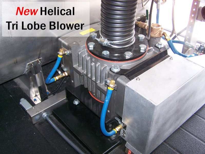

There are oil drain hoses available - makes future oil changes easier....

Gardner....YOU ARE THE MAN! I just logged on to ask the question as to where I get those. What a pain without them.

Get a 90 degree elbow also (though I don't know your set up) you will probably need it.. I should have done it long ago(still haven't)!!:icon_redface:
Reactions: dgardner
You will want to use a simple ball valve before installing that drain hose, or you will be wasting very high dollar ISO 220 oil filling that drain hose for no reason.
At 40 dollars a quart I don't want 1/2 pint of oil just filling a drain hose.

you can go to any hydraulics store and have a hose made meg. I have them made for all my oil ports.
Senior Chavez tu eres un whey!!!
If you do it like the picture above you will have nothing to worry about.
