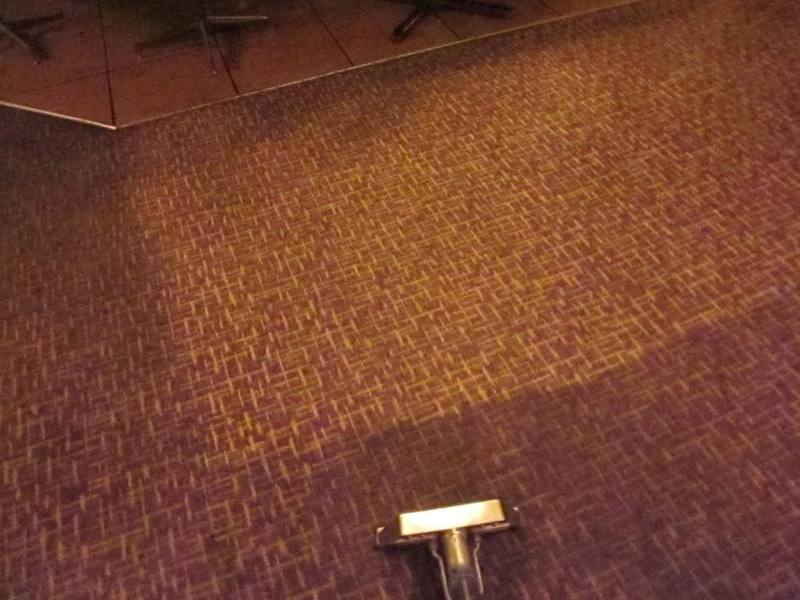

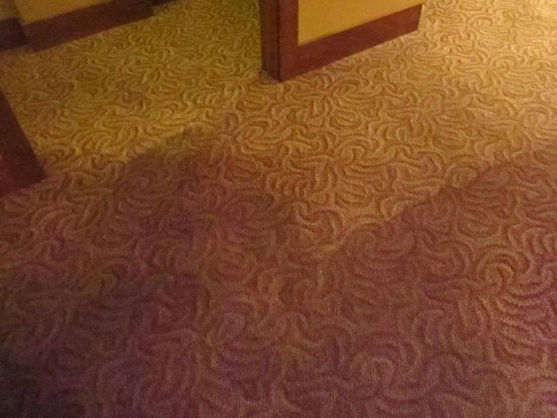

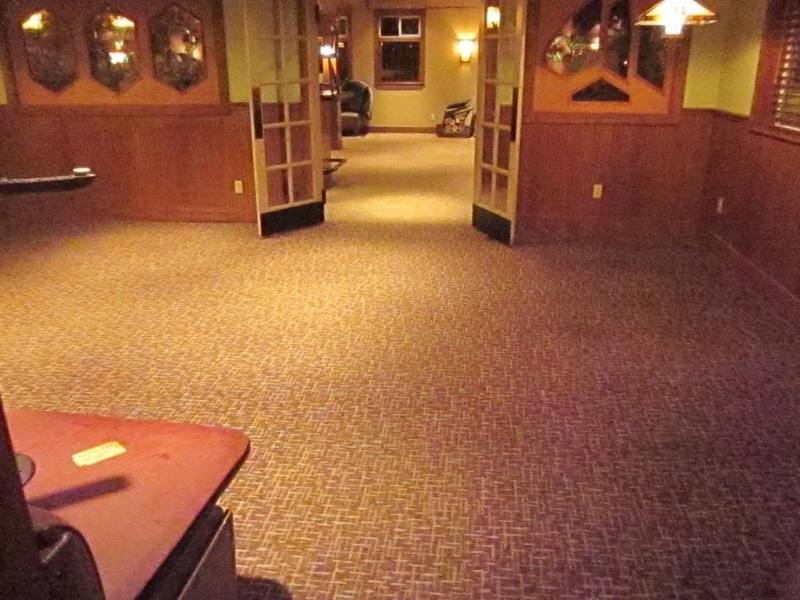

OK, it's finished and the combination of the Attack and the Liquid Slurry was great.As a final step I did mist over the whole place with my 2Ph Fibre rinse just in case. The slurry did not foam up in any noticeable way, no problems with vacuum. I think I'm going to use up the 2 jugs that I have and then possibly look for what might be better. But this time it was quite a bit easier than the previous times so I'm happy.
Thanks for your help!
here are a few pics
done!

Looks good but next time forget that extra step of spraying an acid rinse product on it.
Doesn't do a damn thing for it and might even leave a residue.
