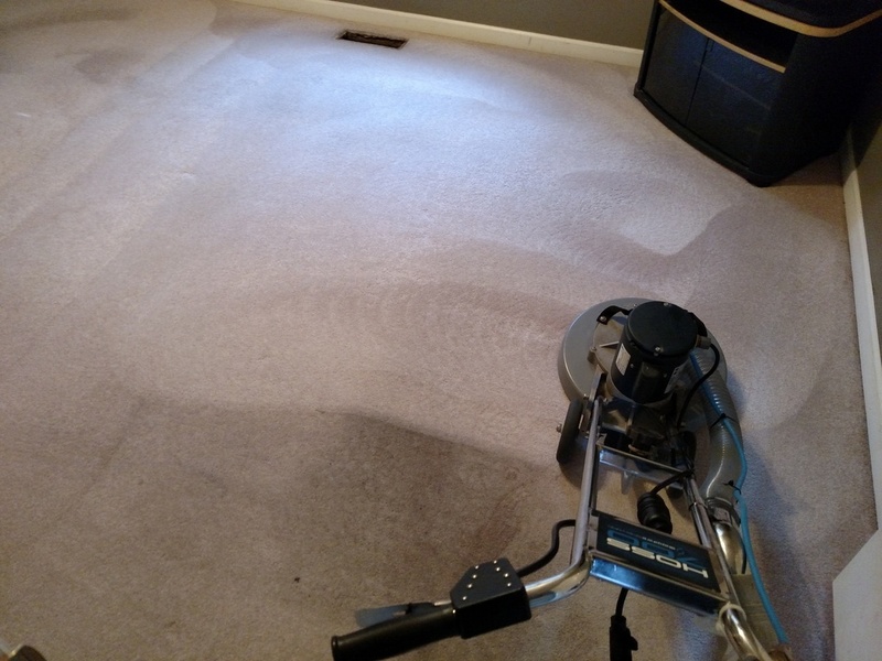

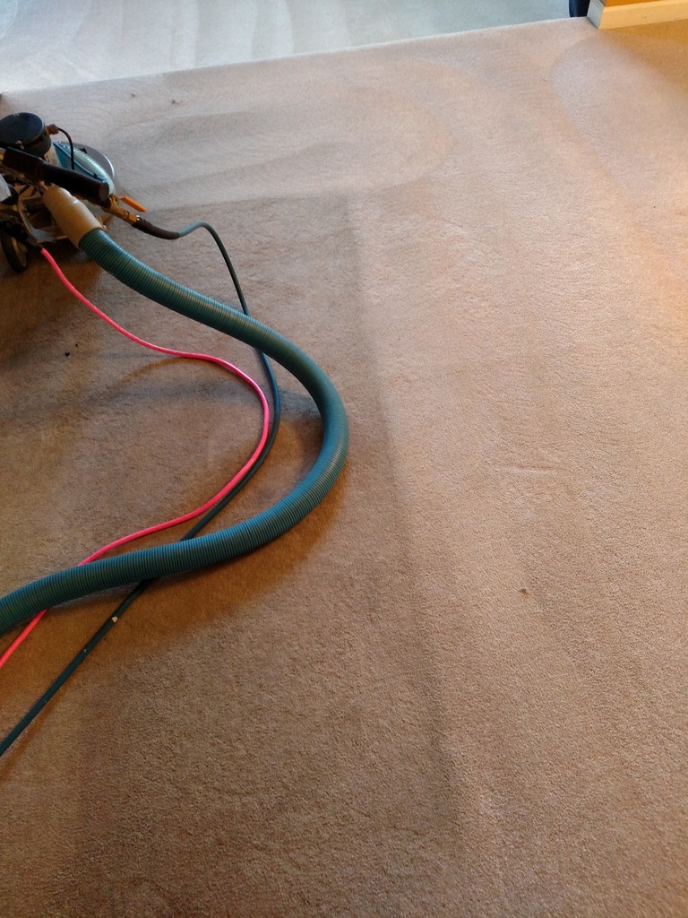

RE swirls- Hoss
1,846
BradFenstermaker
Flex with Citrus chased with Harvard Fury. Rinse is mixed about half strength
Home owner prespoted with purple power and awesome with a 4 ft brush. Lol
He said damn! This is gonna take awhile. Then called us in. Lol

what chems did you use on that carpet
Yeah we need to get you using clean free as your rinse, it removes residues, and it brightens the carpet up.

If you have a strong truckmount that has a good recovery. Take the orfice out you will get better results.
Marty you are the last person I thought would reference that to be his male part.
GeneMiller
Mar 24, 2009
3,547
gene miller
Looked on the back of a carpet after I cleaned it with the hoss with the large disc. I was running 500 and went right through. No way running running without the disc you aren't soaking the back. Doesn't matter how much vacuum you have. I also turned my spray bars to the max.
