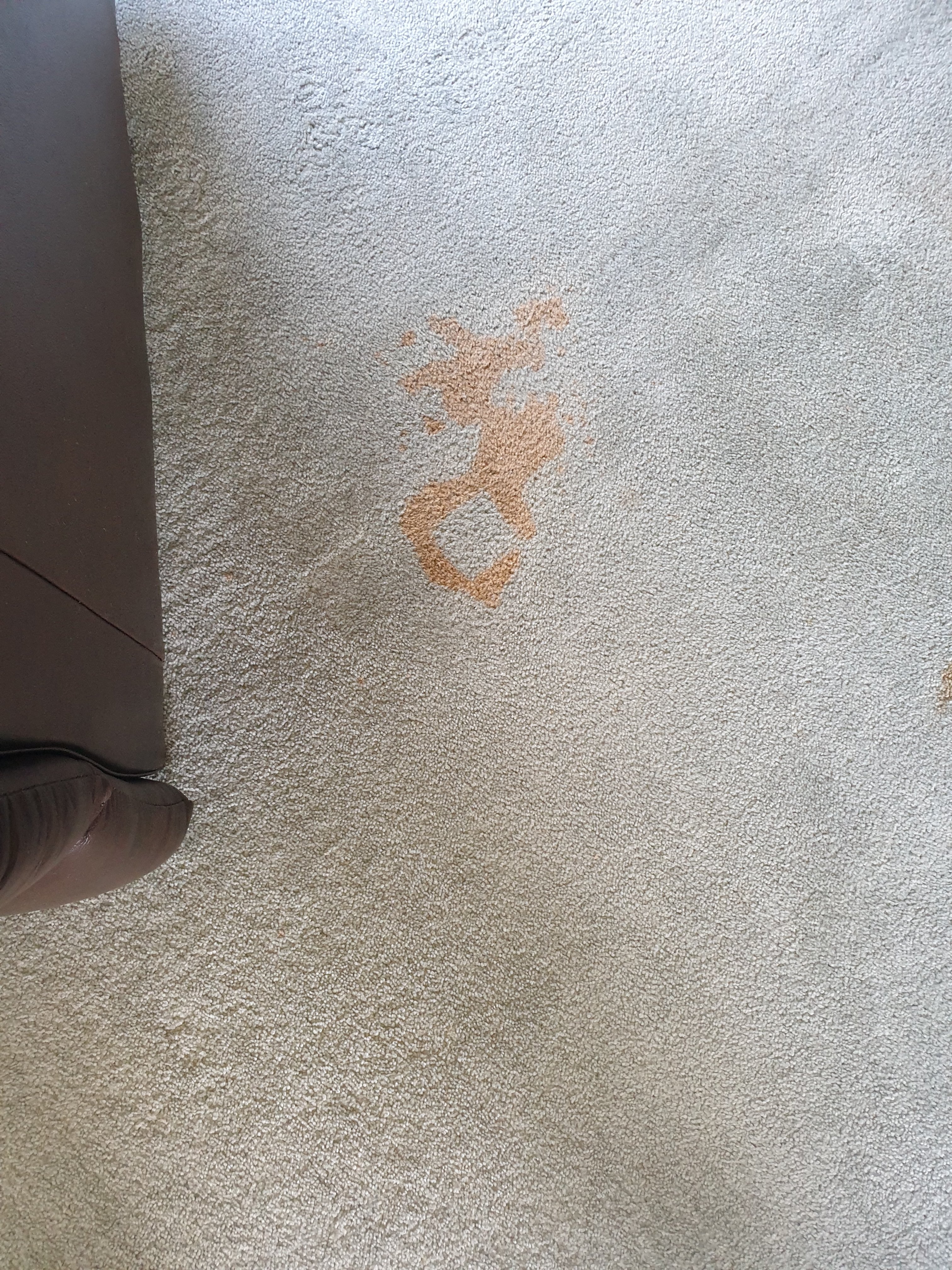

In preparation for our crews arrival, customer attempted to move small furniture. In doing so, she set a wicker basket, fake plant on
The back porch. Crew cleaned. Once they left she put small stuff back. 🤦‍♂️ Then continued to repeatedly move the plant to ensure it was in the perfect spot. Thus leaving not just 1 or 2 but 3 beautifully wicked stains.

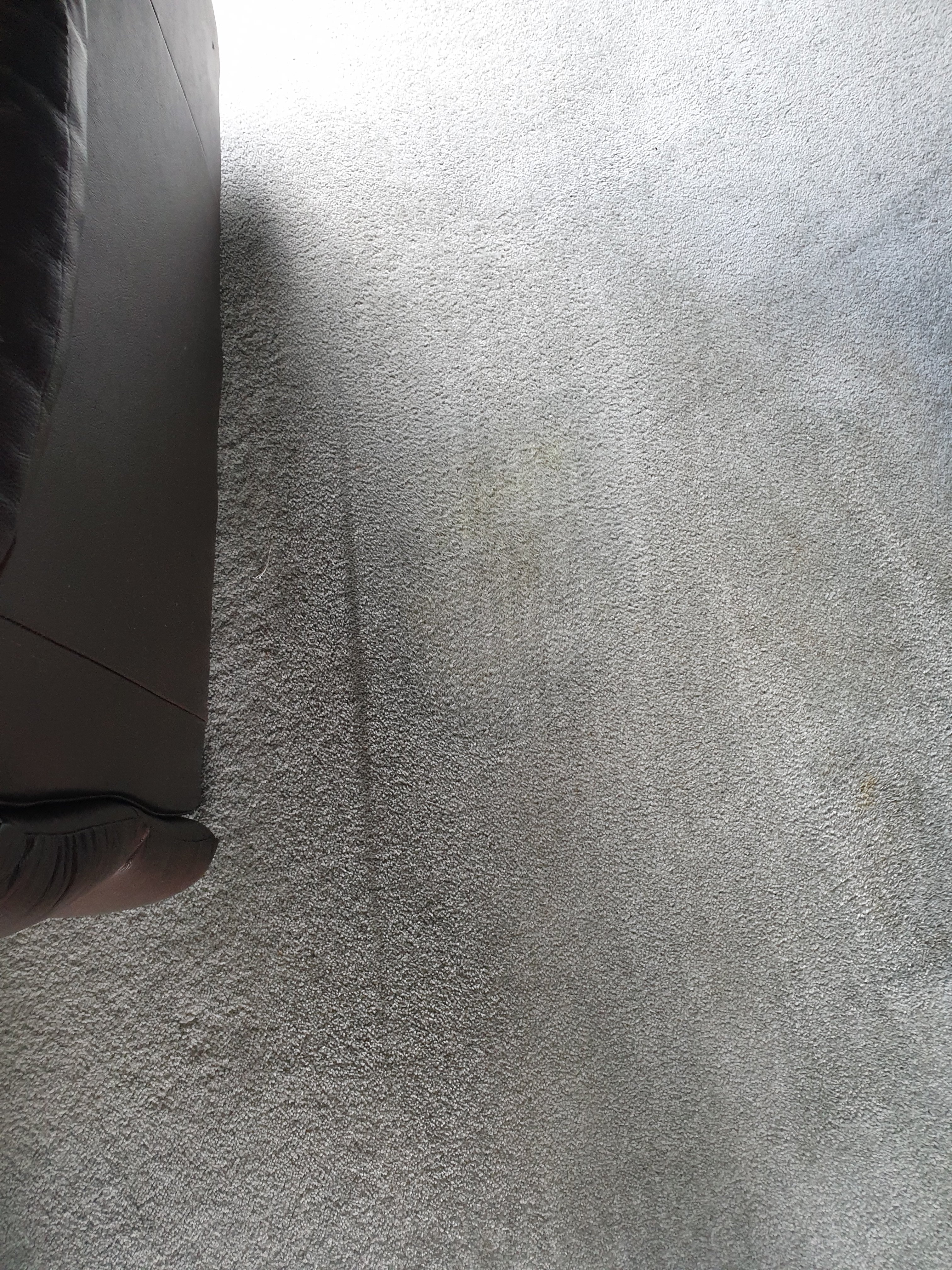

I spent about an hour on it yesterday. The lighter ones and the left and right damn near we’re gone (very difficult to see)... the worst one in the middle was probably 50% better but started to have color loss so I called it a day. She was happier with the result than I was but that’s better than the opposite way around. I’ve heard the UV truck come up and discussed by Cobb I think but don’t know anything about it or have ever tried it.

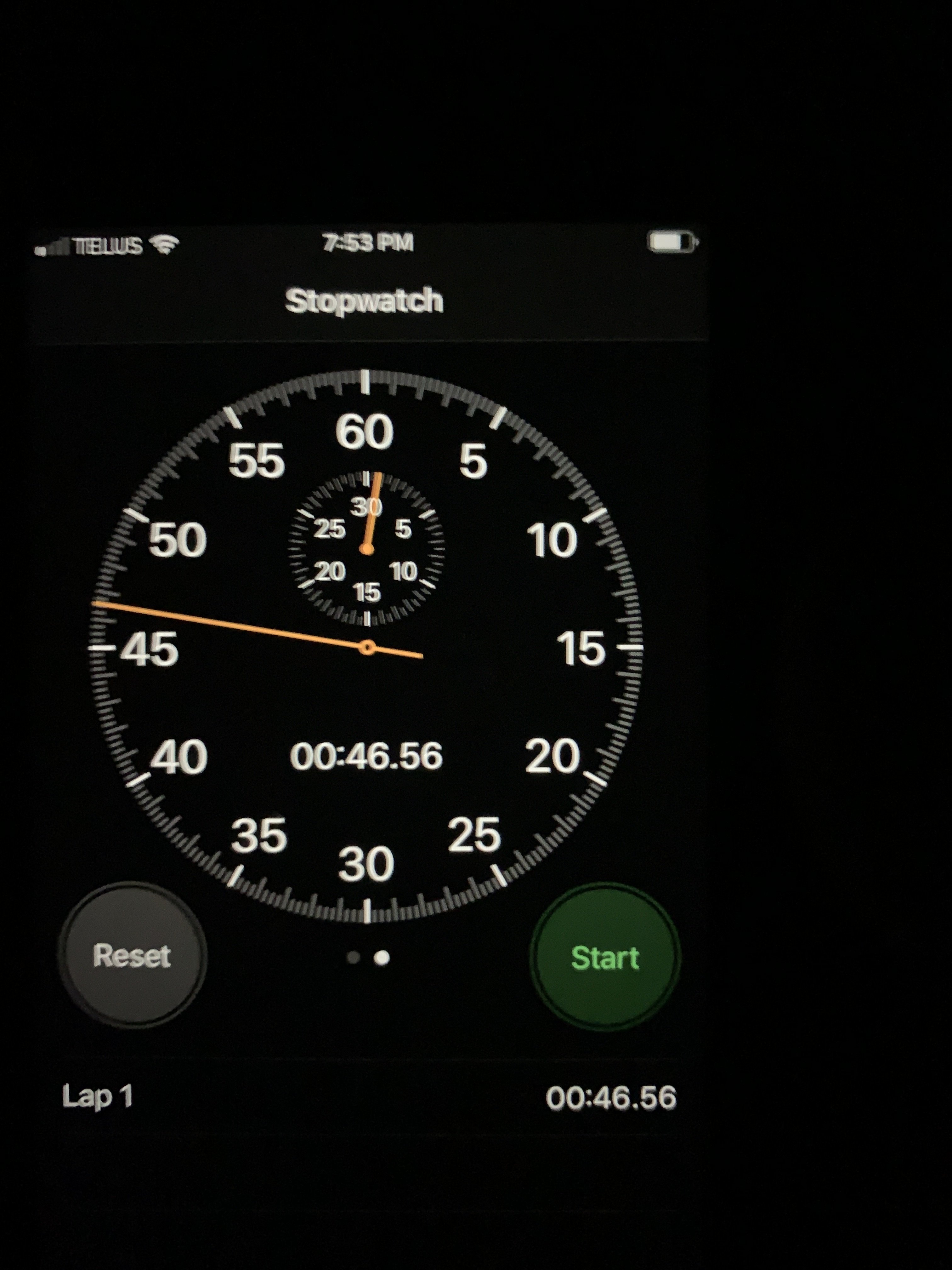

I know you were doing it one handed, but there’s a safer method that I like to do by folding the rag and preheating the rag with the iron before putting it on the stain, and when you put the hot side of the rag on the stain, it acts immediately when applied with the iron on top of that, causing the stain to go away in a shorter, safer period of time.

Yup, 48 seconds is long enough to melt some types of carpet....

I’m a professional. I don’t leave an iron on carpet for 48 seconds.

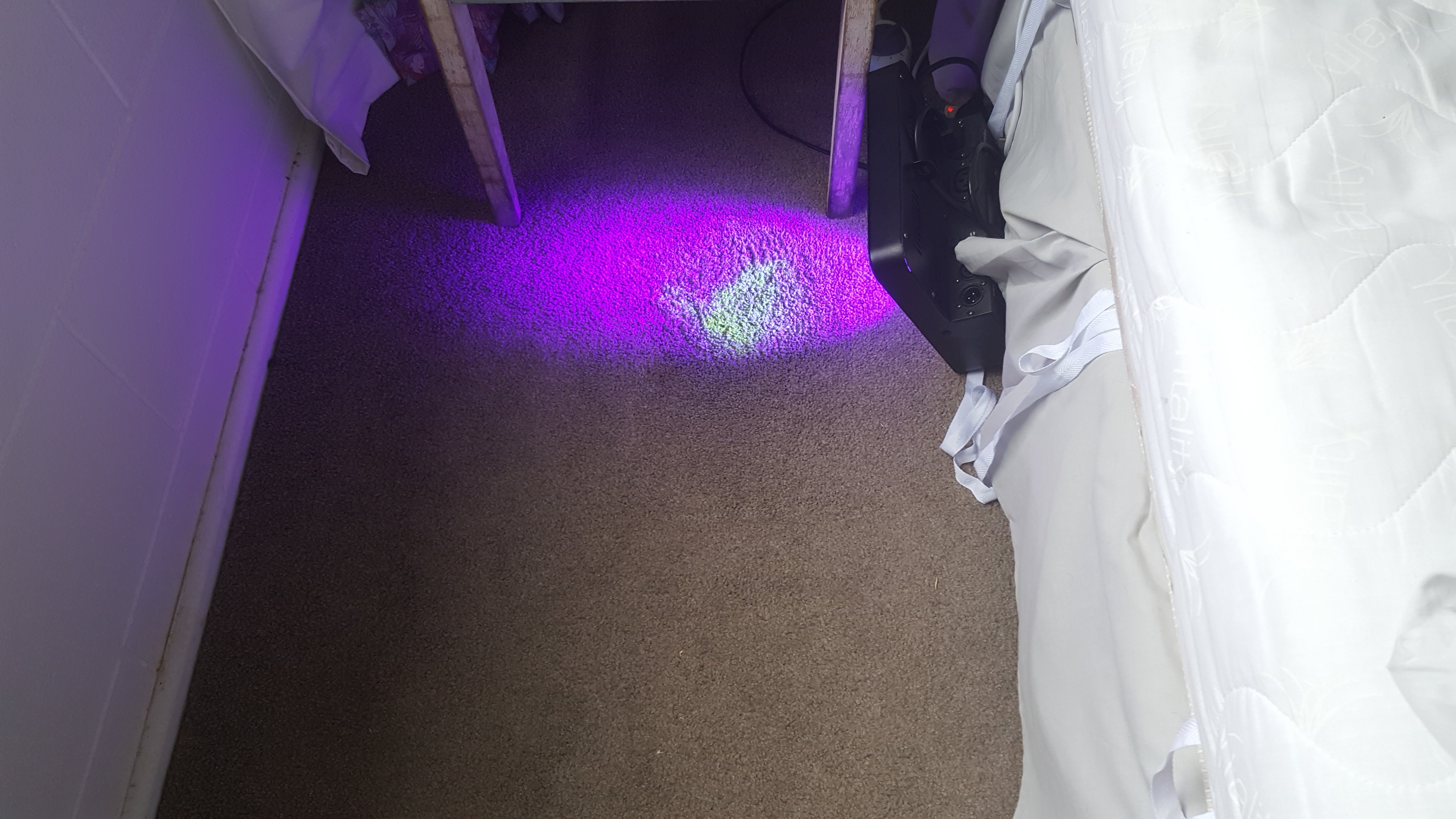

UV spotlight is only way I've pulled turmeric, you better have whole house to clean though cos it takes awhile
