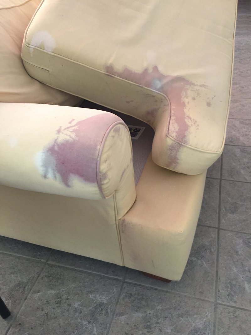

Can I get a reminder on how to treat red wine on a fabric like this? The white spots are my last attempt to remove a different stain. It was a red40 stain. How should I approach this new dilemma without weakening the color any more?

For all the guys that are telling me to use vol40...look at the white spots on the chair. That's from me using volume 40 last time I cleaned it. So volume 40 is on my list of things to leave in the trailer on this job.
