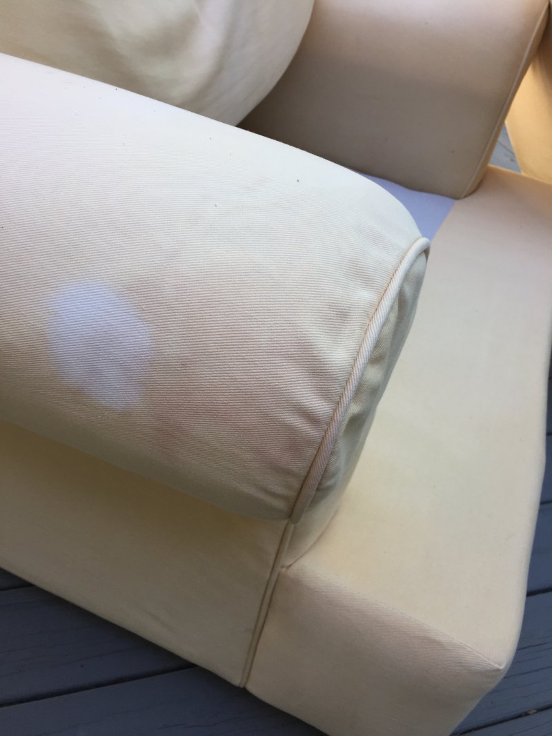

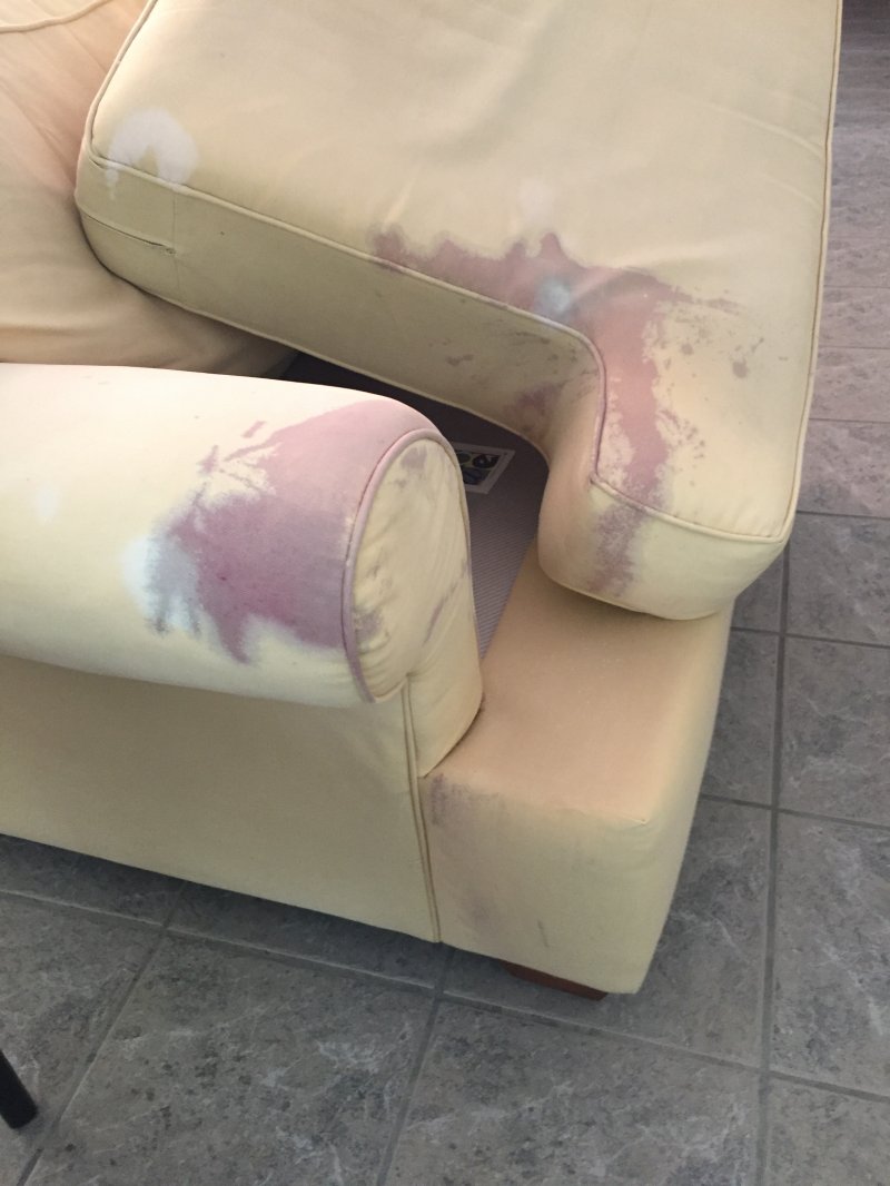

The white spots are my last attempt to remove a different stain. It was a red40 stain. How should I approach this new dilemma without weakening the color any more?
Since the 40 vol. turned the red stains white, I would definitely try a reducing agent.
We would use DC FiberBrite powder first on uphol, since it is milder.
If that doesn't work, then a stronger reducing agent like ReduceAll is required.

I've got some chemspec coffee stain remover that I'll start off with. What do you guys recommend on the dilution of it?
18,851
Lee Stockwell
Label directions as a starting point.
Inconspicuous place (if there still is one) as a matter of best practice. Start little to determine MO.

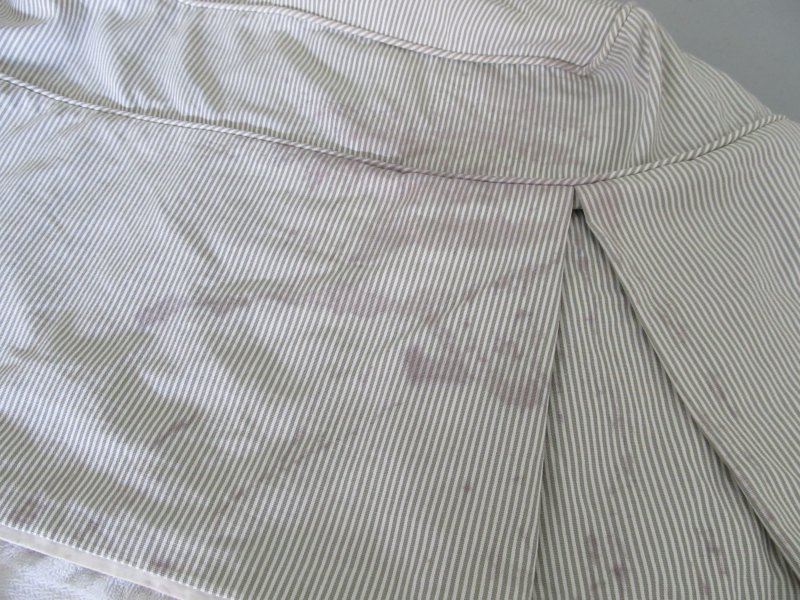

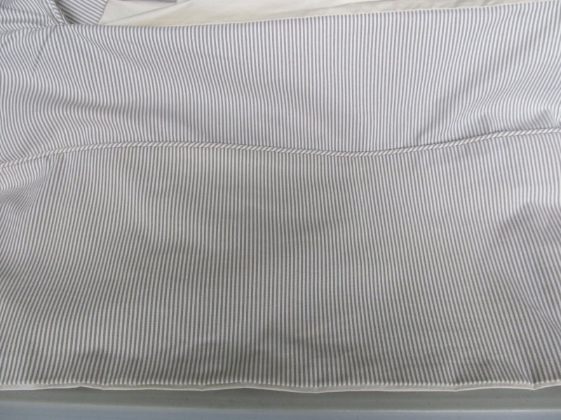

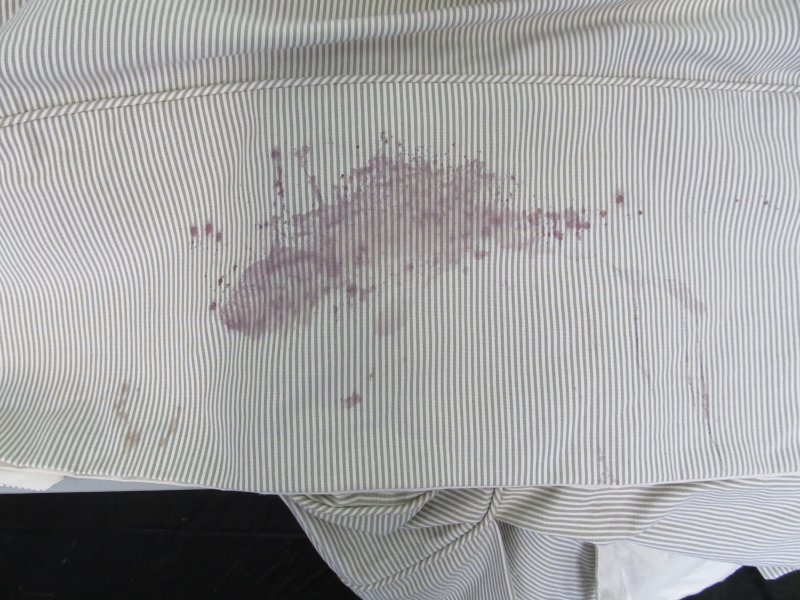

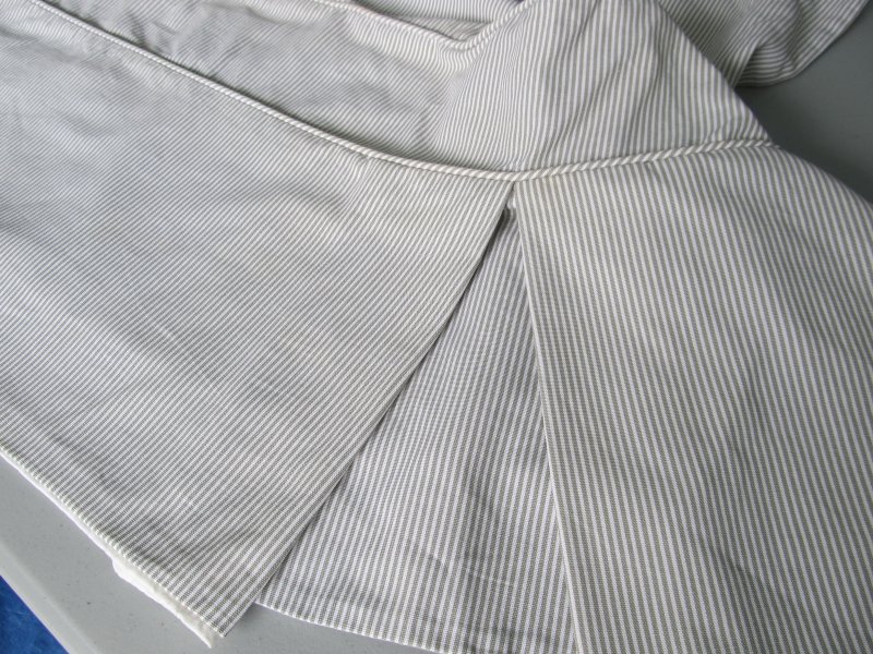

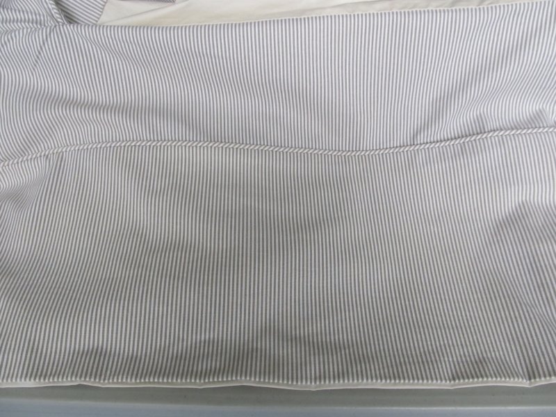

I tried all I had on it.
1. Treated it with acid based
rinsed
2. Treated it with fine fabric respray
rinsed
3. Treated it with browning treatment
rinsed, and treated it again
4. Put it outside in the sun with 3% peroxide
Instructed the customer to apply it again after it dried
Yes, I let all my chemicals dwell, and I got it to lighten up about 50% lighter. The browning treatment showed the most difference.
I'll have some pictures to show after it dries fully

Patience is often a necessary ingredient to stain removal. Maybe try the 3% peroxide again. Might also try the browning treatment again, although you did not specify what type of browning treatment it was (some are oxidizers, some are reducers, some are acids). Small steps with products that are not too aggressive but repeat as long as you are making progress.
Reactions: Jim Pemberton
14,415
It was Chemspec's liquid browning treatment. It's all I had with me. I told the customer to re-apply the 3% after it dries and if it keep getting lighter to spray again as needed.

Looks much better Matt. You are at the point where as long as the reducer is rinsed out, you can apply a product like Stain Magic or Eliminate. The 2 parts are peroxide and ammonia. The ammonia boosts the action of the peroxide and it self neutralizes. Light spray over the affected area and it should lighten up.
