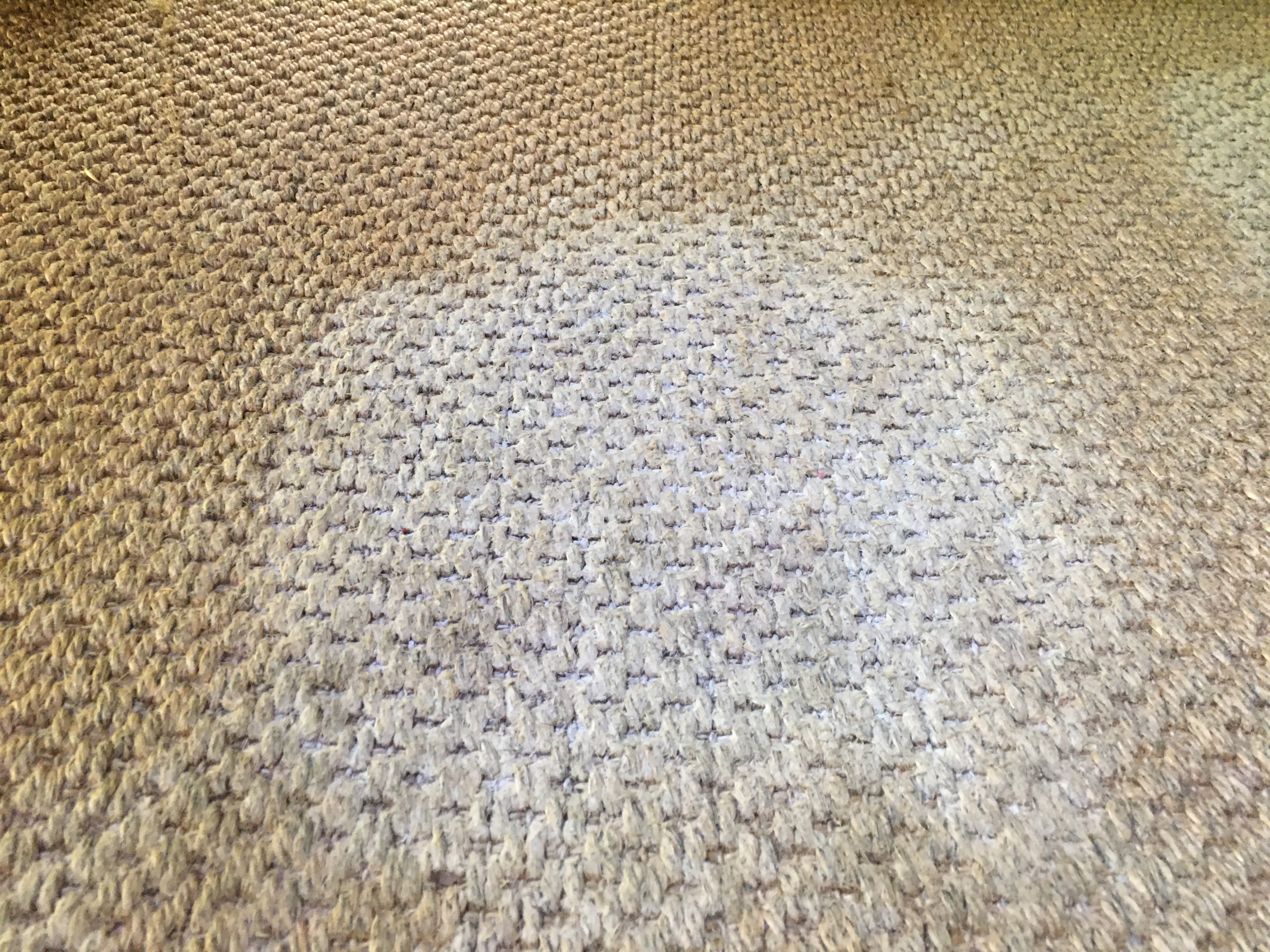

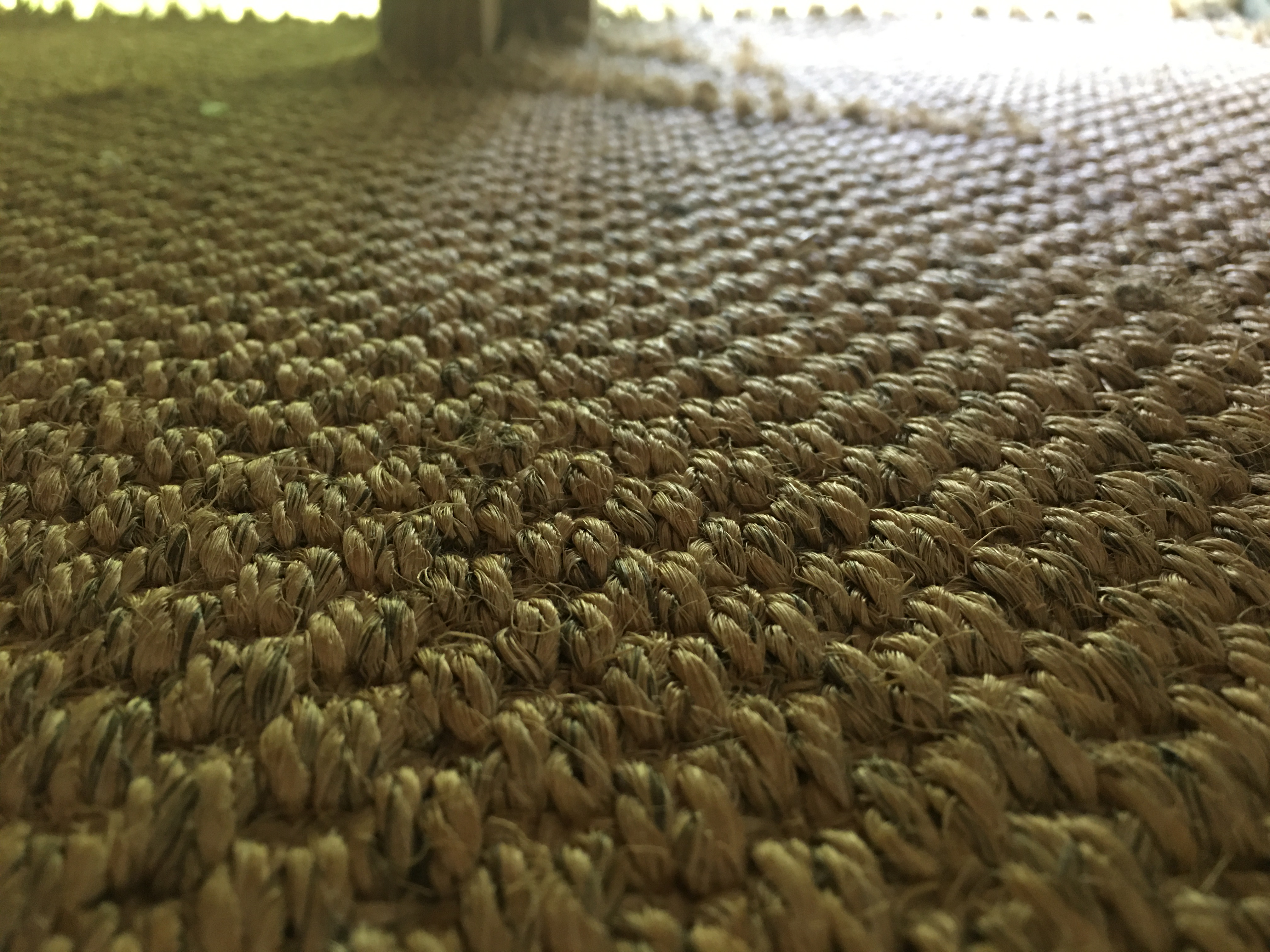

Burn test says jute. I turned the job down. I have to set up 300ft just to get to the door, then it’s just 2 small rooms. It’s not worth the risk.
F7D0717A-0881-4599-89AA-2479F2F8EDDC.jpeg 43573EDE-D244-46A8-81AE-B5F158FA9A3D.jpeg

Is the white what it looked like after she tried something herself? That's enough reason to walk right there.

Just curious...what’s the difference in a burn test with jute vs sisal?

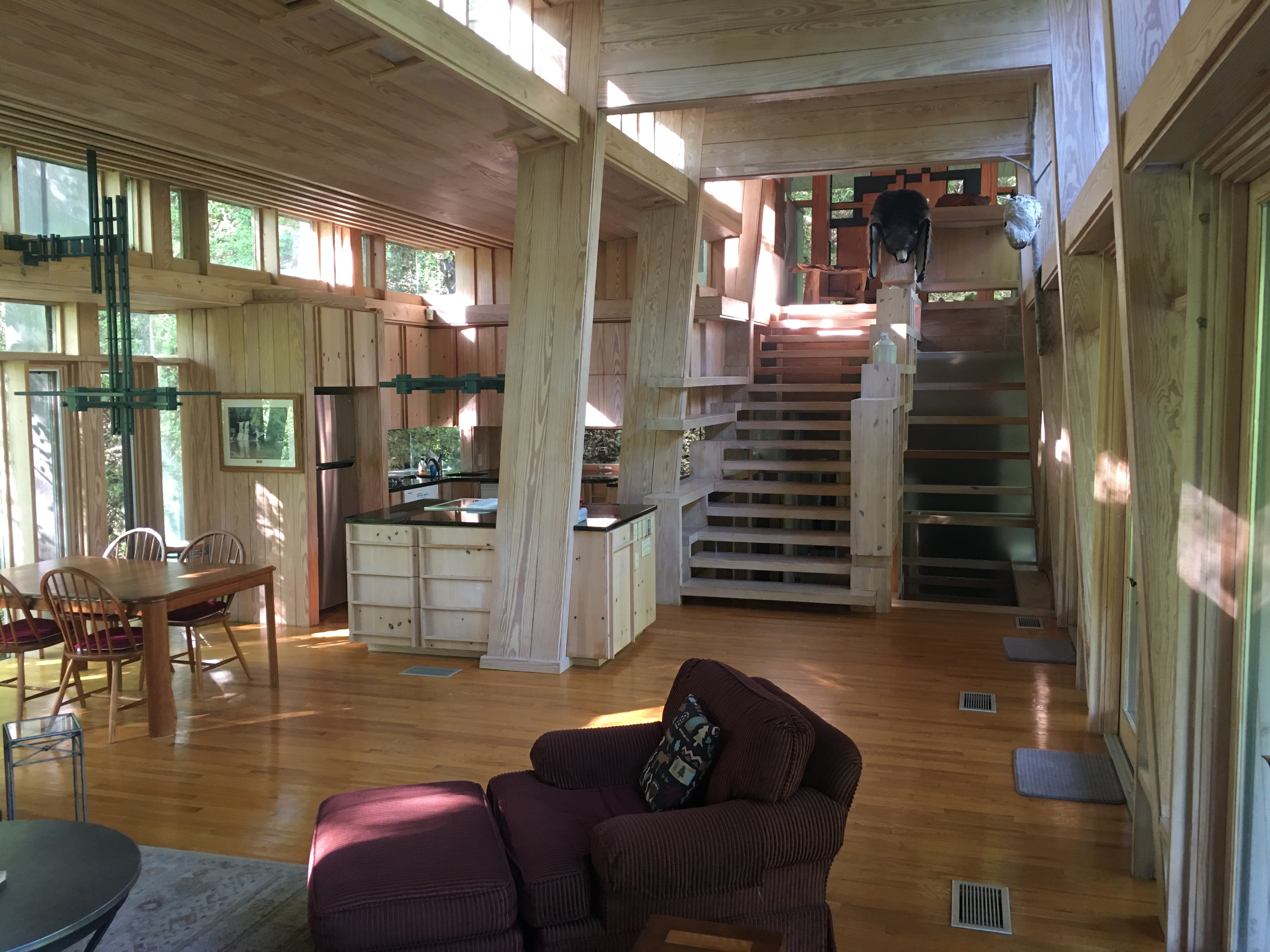

If she can get a donor piece/patch she could try that but it does look pre-fcked so best to walk away and enjoy the view.
I've seen them permanently stain from just water.
Nice Bear and Wasp Nest!

I gave him the number of the carpet installers I suggest. He said he might have a donor piece to patch if it's possible. Either way, I walked feeling good about the situation and gained his respect for being honest with what we discussed

they look and burn the same but feel different, sisal feels softer vs jutes quite hard feeling
Unless the jute has been "woolenized" by tumbling and bleaching. They mix the stuff in with wool and rug owners wonder why their wool rug wore out so fast.
An experience carpet installer will likely decline the work as well. That weave is difficult to work with - tough to keep seams cut across the warp from fraying.

If you wet clean it you can watch it shrink. It will pull the tackless strip out of the floor.
It has more grip than your bonnet driver, and the chemical mix that would do some good is both flammable and will eat equipment motors, so your only safe option is dry powder. Abrade what you can off of the surface and see if anyone will pay you for the results.
Disposable carpet for those with disposable money.
