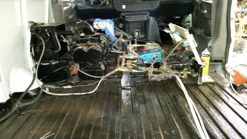

The old prochems take only a half hour as long as there is not a bulk head on the van. One of the easiest pumps to replace.
Even some of the new ones can be changed in a half hour or so.
11,537
Take 2 hoses off the chemical pump, spin chemical pump off pump. take 4 mounting screws off pump. Slide forward take belts off. Lift pump out?
I guess the harder part would be R&R the clutch plate?
The good news is I've only had to rebuild 2 cat pumps in 15000 hours so I guess they're pretty solid.
But ya it looks easy enough I'm sure a Butler owner appreciates the video.

If wasn't making this video could have done in about half the time actually...
But I can twirl some wrenches when I need to

It's a lot easier to work on the pump if you get everything else out of the way.
