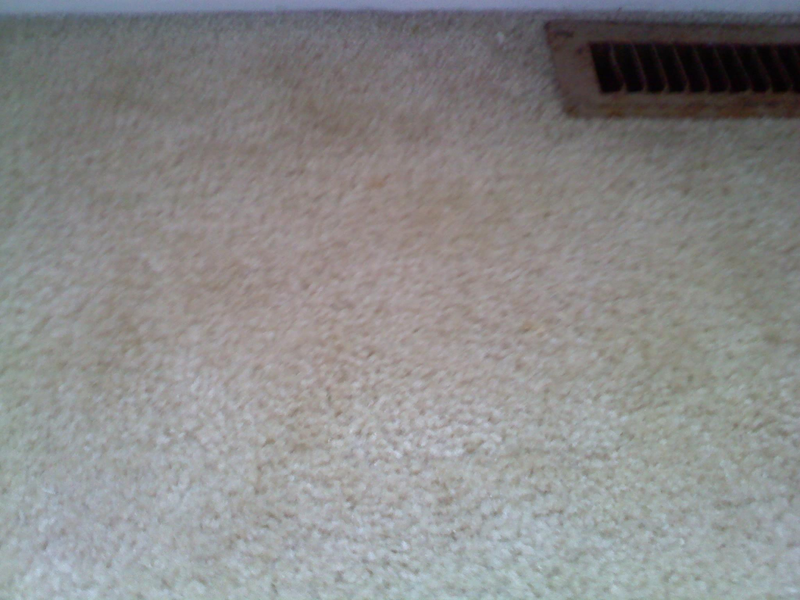

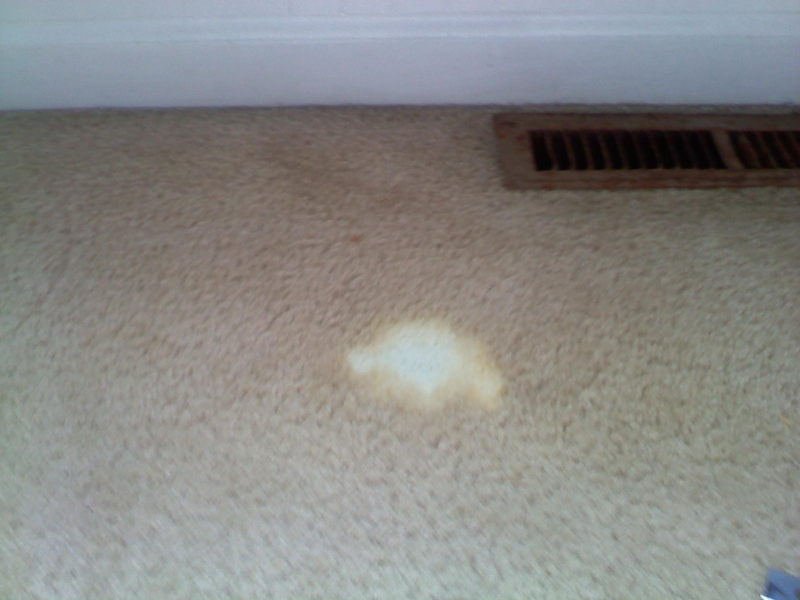

idreadnought said:I have several templates that I use. 4" 6" 8" and some rectangular ones. I could patch the carpet in those 4 places (if they fit my templates) in about 40 minutes or less. I use a Koolglide iron and would charge less than a hundred bucks for all of them. I paid big bucks for my templates, Ok, Ok, I got them all for about 10 bucks. I went to a metal fabricating and sales center and picked through their scrap pieces to find my templates made out of aluminum. Pencil money
