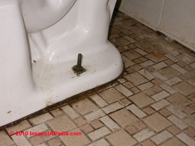

The guy that installed the new toilet didn"t insure the tank was tightened down.... (Joans nephew)...
So it wasn't sh*t water after all..
kinda odd you didn't notice water on the floor then.
two places a tank can leak..thru the bolt holes that secure it to bowl and thru the tank/bowl gasket.
when bolt hole leak, it drips all the time .
At gasket, when you flush .
Both conditions you see water on floor around the toilet
.L.T.A.
49,918
.L.T.A.
