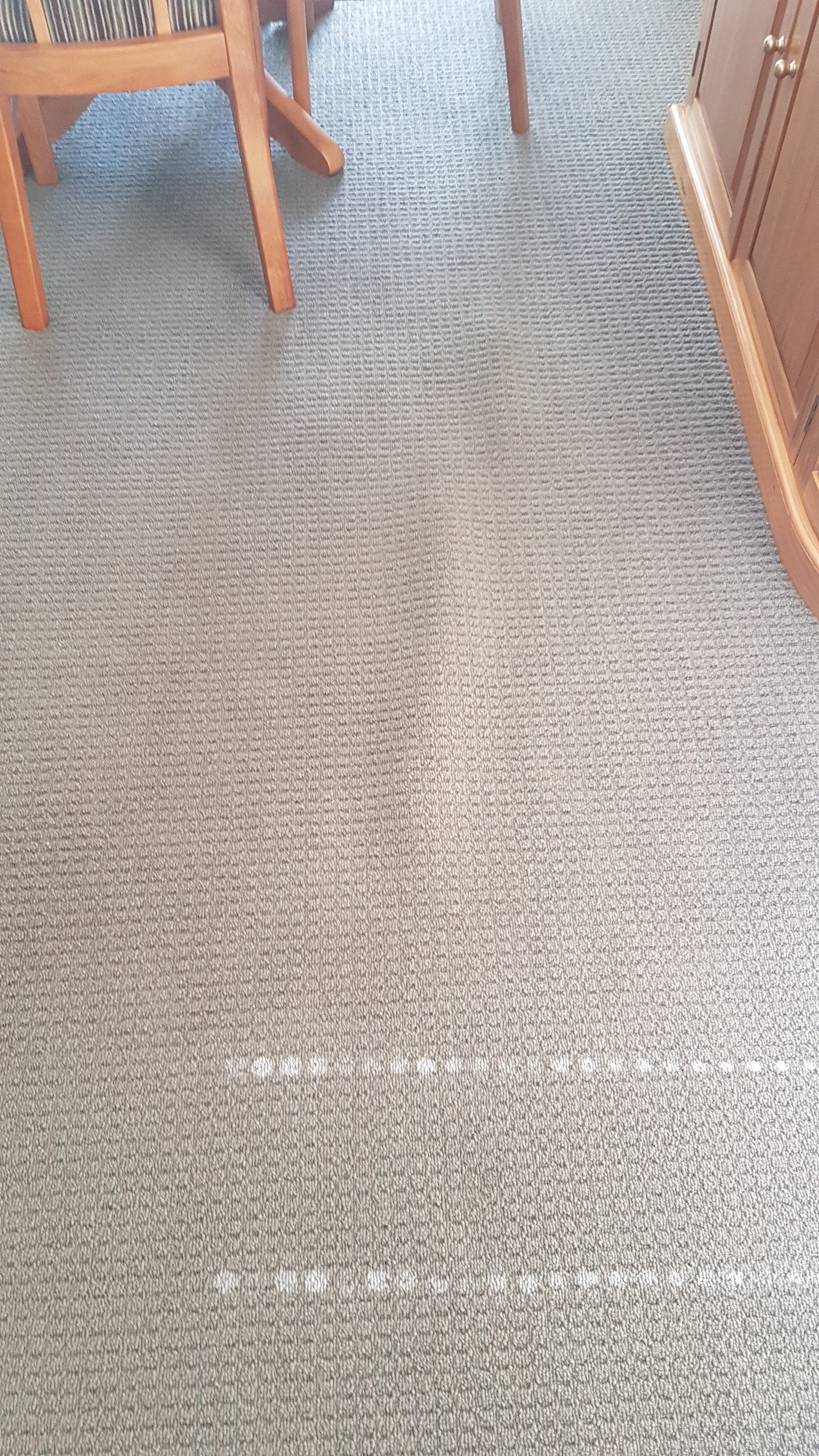

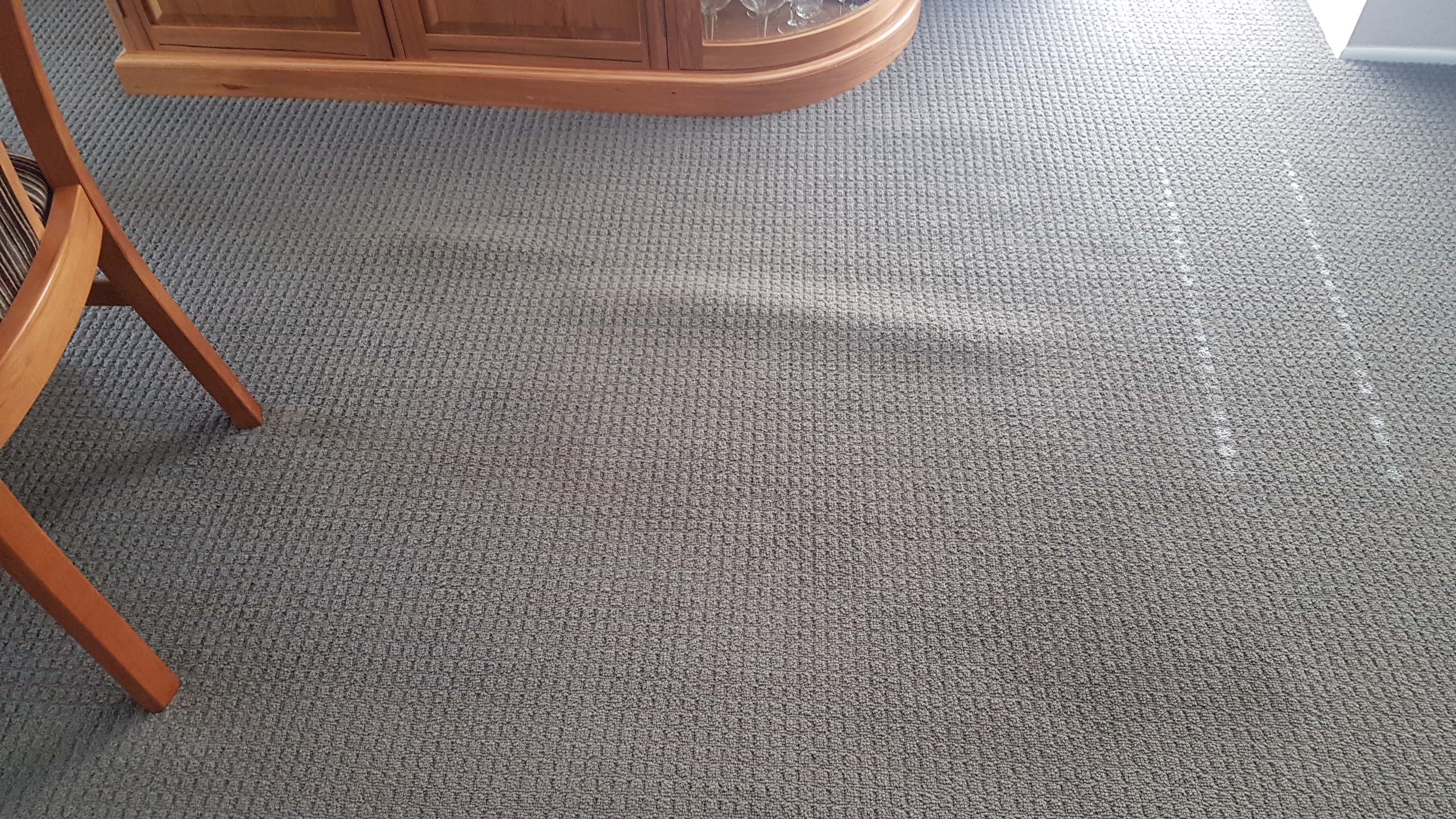

Hi Everyone
I was called to a house on Friday after a cat knocked over a Galileo thermometer which broke, spilling an oily substance on the carpet. I flushed the area out with prochem power solvent, rinsed the carpet out with water and gave the area a clean. I couldnt smell/feel any of the oily substance once I had finished.
I had a call from a the customer this morning to say the carpet has rippled. Photos below, I would appreciate ideas on why this might have occurred. It is a wool carpet with a jute backing. Standard domestic installation, tackless strips and stretched into place.
I am returning on Wednesday, once they have cleared the contents of the cabinet, to lift the carpet and inspect the backing. I am hoping that I can rectify this by simply re-stretching the carpet. I don't think the carpet has de-laminated but wont know this for sure until I lift it. The concrete floor over which the carpet is laid is quite uneven, maybe this has something to do with it.
Would appreciate any feedback.
Thanks
Gordon

I've never witnessed this with wool carpet, but I've seen it a few times with synthetic. It should lay back down. I've heard people tell me the cause is the backing being different than the threads, it not being properly stretched, and something else I can't remember.
24,146
Man, this kind of stuff can be stressful. People have unrealistic expectations. Carpet with age stretches and when you put moisture into it, bam! Hopefully it lays down on it's own in a few days. I'm sure sliding that china cabinet around doesn't help much.
Newman
Aug 1, 2008
1,069
Chris Newman
I am assuming that cabinet is big and heavy. Heavy furniture acts like an anchor not allowing the carpet to move naturally after cleaning.
Not really your fault. The nature of the beast. should be fine with a stretch.

It's difficult to tell in the pics but the last one looks like the surrounding area is still wet
May have overwet the area and caused the backing to swell
Remove the cabinet and try to stretch
If it delaminated , it's possible the combination of the oils in the thermometer and or the Prochem solvent caused it
Tough spot, either way you have to make it right
At least if you attempt a stretch you can blame it on the thermometer
Good luck!

I have seen something similar that happen a few times. It was probably a substance similar to Odorless Mineral Spirits in the thermometer and that is causing the carpet backing in that area to swell. If you have dealt with OMS in the past, you know it takes a while to dry, especially in the backing of the carpet. Your cleaning did not cause the problem.
I would stick an air mover on that spot and leave it for a few days, maybe even a week or more. It would be better if you can get that air flow under the carpet, but placing on top works, it just takes longer. Explain to the customer that the "oil" caused the issue and because it got into the backing it will take a bit of time to evaporate out. That really should be all that you have to do.
Do not re-stretch the carpet until you have tried something like what I described.
Oh and tell them not to use any candles or open flame in that room or area while the air mover is running. It looks like a living area, so they shouldn't have a gas stove or gas clothes dryer, but those also should not be used in that area. The evaporating OMS will combine with the oxygen to give the room or stove or dryer (and the clothes in it) a burnt kerosene odor.

Did you
Pull up a corner and check the backing?
Is something g they’re telling you?
It will probably flatten out in a day or two
If not weights and a carpet syringe with some latex glue

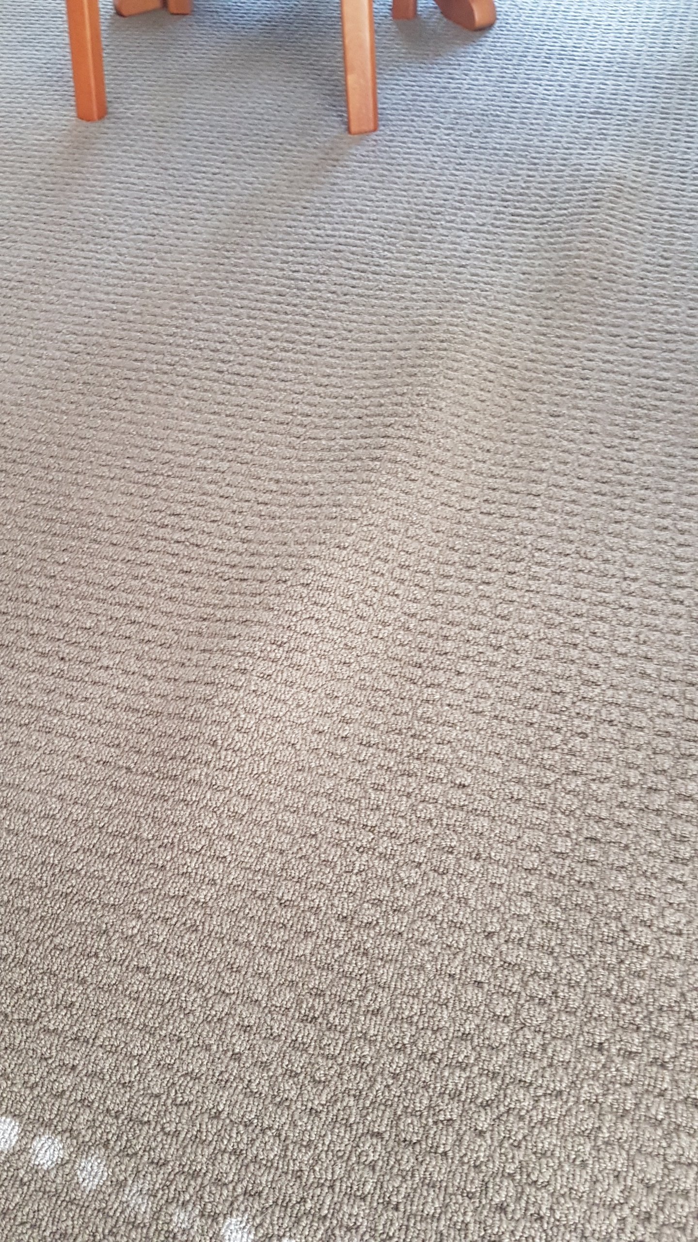

Thank everyone for taking the time to respond, I appreciate it. I agree it is important to let the carpet dry before attempting a re-stretch. I will let you know how it goes

From the looks of the pictures, I can see a slight ring around the bump.
What they spilled combined with your heroic efforts, probably caused the swelling, you probably know but jute left to wet will brown out bad.
Also if you look at the backing it would be a reddish brown color if it’s jute.
I’ve come across a few jute backed carpet recently they were real old.
Hope it’s polypropelene and settles on it’s own.
If it does you may need to do a light mist and towel on and water ring.

You know the backing is jute. The next question is; the secondary or the primary or both?
The carpet looks like a contemporary style, so it may have a jute secondary over a polypropylene primary, which would make it act just like every synthetic you've seen. Even woven wool carpet can have synthetics in the backing and will grow with moisture.
Delamination is a concern, which could be due to the original oil or your solvent. If you do what Mr. Hanna suggests and the carpet still has ripples, you may have to work some new latex into the backing before doing a re-stretch. Otherwise the delaminated carpet will come apart when you put stress on it.
I'll keep my fingers crossed, since you would have to do quite a bit more work to keep the pattern straight. The pattern will skew if you restretch that area only.

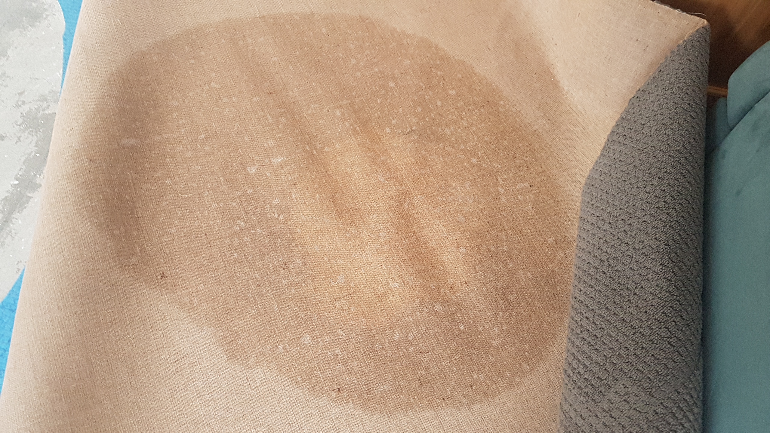

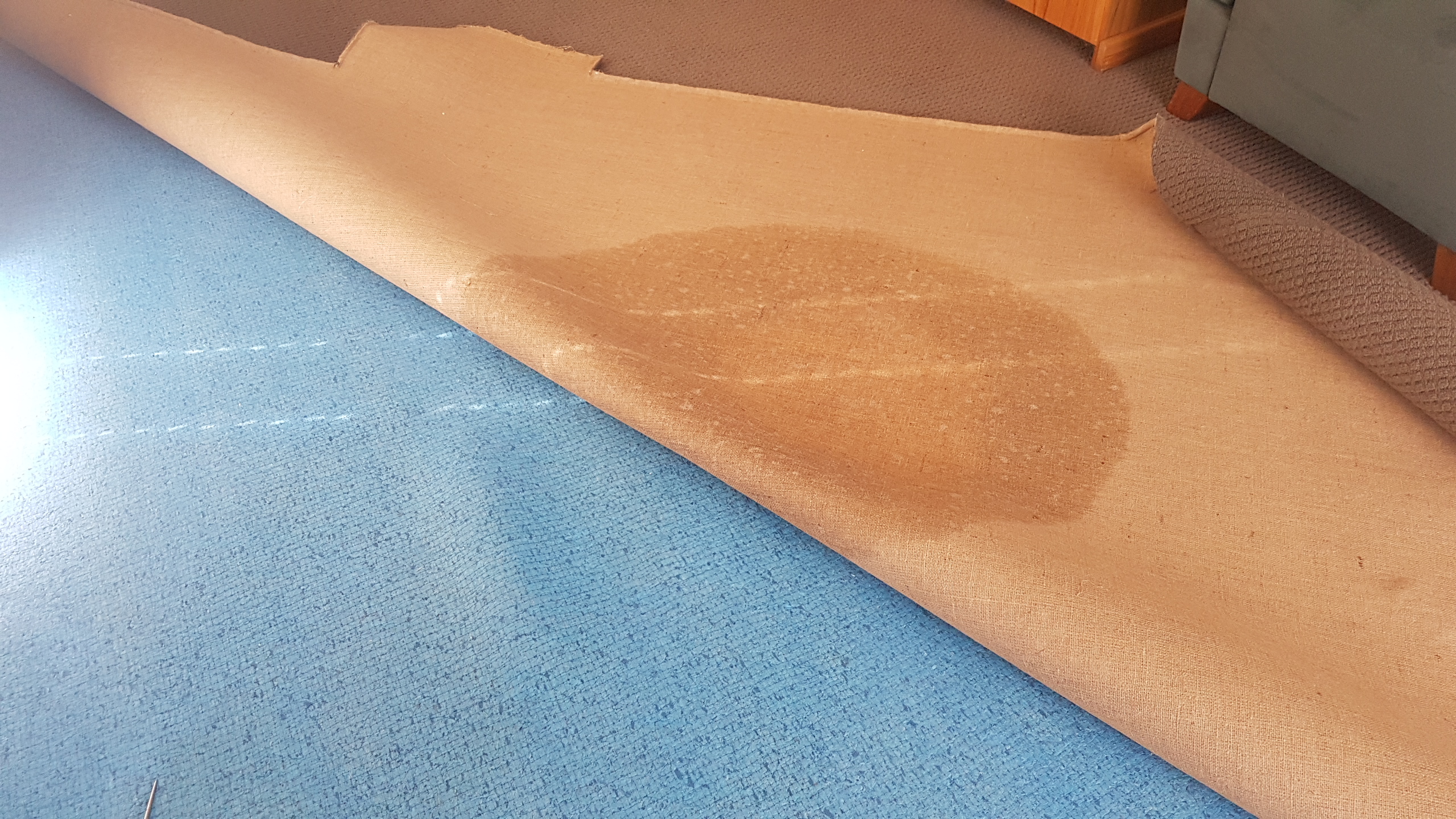

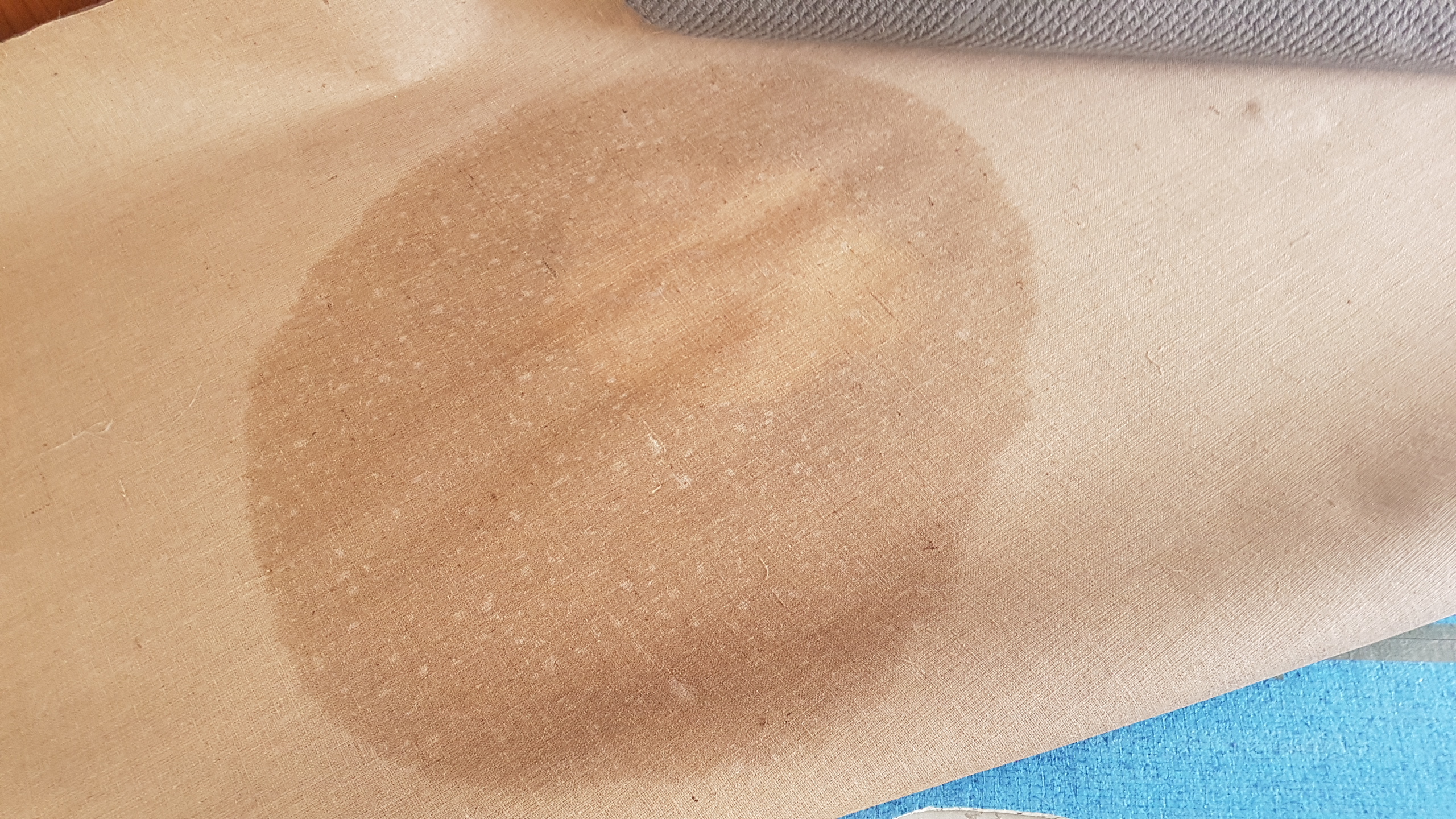

I went back to the house today, lifted the carpet and inspected the backing. Photos below.
The carpet is still damp as was the underlay. I have cut the underlay out, folded the carpet back and left an airmover to dry it out.
There is no obvious sign of delamination. It does look to me
like the backing of the carpet has swollen or distorted, causing this rippling effect.
For two reasons I suspect the rippling was caused by the liquid in the thermometer rather than the power solvent that I used:
1) There is an area with a slight orange colour in the centre of the wet area. This area smells like the liquid in the thermometer and also happens to be where the worst of the rippling is located
2) I have used power solvent before to flush out oil spills, on similar types of carpet and not had problems with rippling.
I will go back early next week to reassess. Hopefully it is dry and the ripples have gone. If not I may have to make a call on when to re-stretch it. However this would be a last resort, it would be difficult not to distort the pattern to some degree.
For future reference does anyone have suggestions on how to remove oily substances from a carpet without using solvents?
Many Thanks

14,632
I think this one situation is where both sides of the carpet needed attention. It's not like urine where you can flood it with your product from the top side only. If you flooded the area with delimonene, it'd never rinse out properly.
If I were you, I'd suggest knee kicking the carpet back to place after it dried, and if it needed power stretching, then they'll have to fork out hiring that job out, or if you power stretch, I feel they are partly to blame and should pay you part of your fees to cover cost to come out and time. If they're not understanding about who's fault this is, then I'd do as they wish and fire them as a customer .

Man, some jobs you just wish you never had. I've learned from this thread when involving oil spills always admonish the customer of the possible pre existing damage. Oil is no joke. I once put a stupid Glade-plugin on a dresser. The oil leaked out and removed the finish. It cost me $500 to have that dresser refinished.
Everytime I see one of those Glade things in a house, I curse.
One of the issues that he needs to be concerned about is cellulosic browning. The jute has been exposed to moisture for prolonged time.
It will be beneficial to let the wet area dry upside down, so if there is browning it will wick towards the back.
As silly as it may sound, I found out that sometime laying a flat heavy object on the buckled area, helps it dry and stay flat as the tension in the fiber decreases. Just make sure if you do, to leave a large flap at the edge [In other words don't create a crease (pressed down folded area) that will need to be taken out and is not as easy as you'd think.]

Likely the liquid was glycol. I have had good success with it by cutting out the soaked pad, putting a subsurface extraction tool on the backing and flushing from the face with water from my pressure hose, then clean as normal two days later
J Scott W
Oct 16, 2006
4,061
Jeffrey Scott Warrington
Yes, glycol.
I did like Scott Turnkett. Used really hot water. Misted carpet with a diluted citrus sovlent first but not so much as to harm the latex backing.
