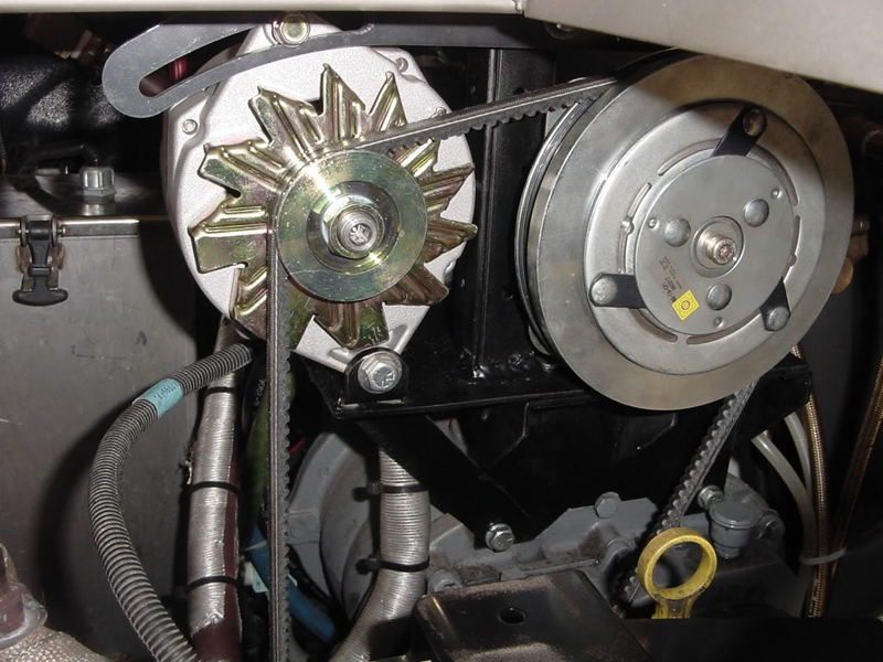

Shane T
Nov 7, 2006
1,663
Waukesha, WI
Shane Tiegs
When you rearrange the pulley system consider driving the Cat pump directly of the engine instead of the blower. It will reduce the strain on the blower belts so they will not have to be tight. I did this to my Powerclean Victory and have increased blower belt life from 400 to over 1000hrs and still going.
I did have to put a larger pulley on the alternator as this small one caused slippage.
