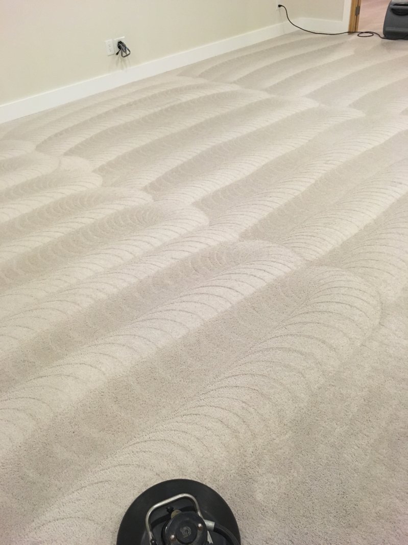

Unlike the super enthusiastic youngens like Russ, who left their competition in the swirls. Or Marky Mark- the world's most documented, enthused, exceptionally good willed, hyper cleaner.
Some of us old (we've seen it before oh so many times types) wonder: Will a brush on a machine that rotates at about 300 rpm (or whatever) cause damage to the carpet. Will it untwist the heat set yarn, particularly yet not limited to low heat set carpet. Yes I know it is lubricated with water, but is that enough? A shampoo brush is lubricated with water and shampoo and no real heat. Big difference.
