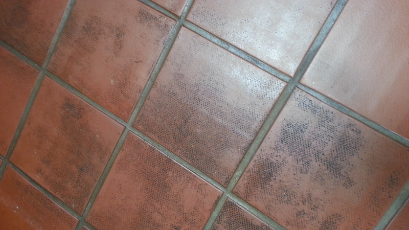

rug pad residue..
114,141
you guys see this much?
it also damages wood floors, glazed tiles and any finished/waxed flooring.
I give the Nomuv speech about twice a week these days..
caused by this sort of crap.
My blog about the issue..
114,141

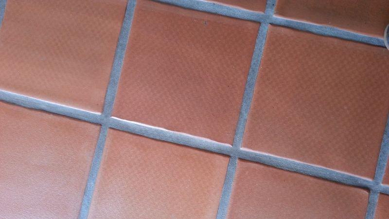

I was able to get the residue off the lower picture.
Top pic Is not so much a residue.. like Ron said appears to be off gasing discoloration
