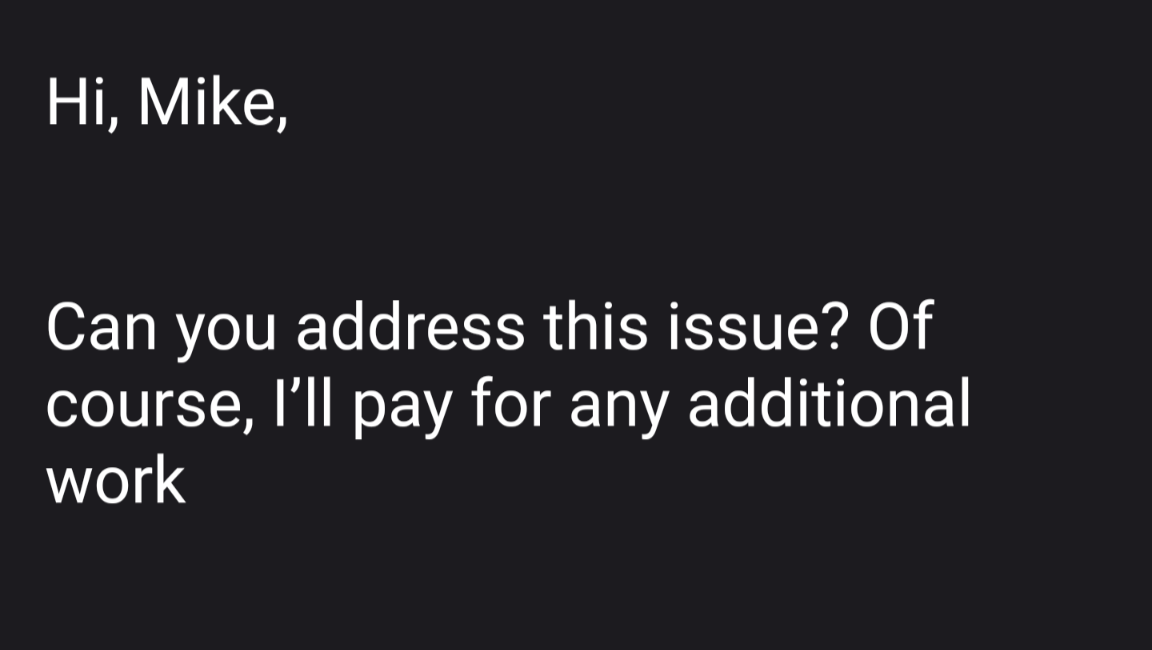

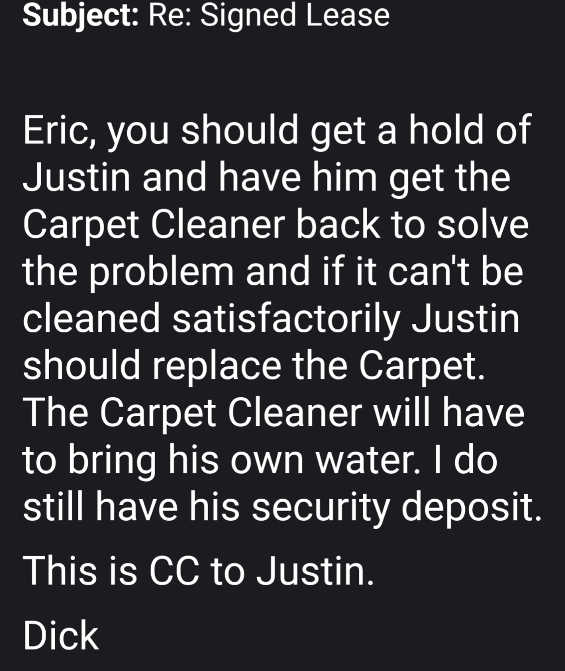

Two banana sized sos showed up under UV inspection.
I couldn't smell anything.
Padded as normal.
What would you do on the return visit?

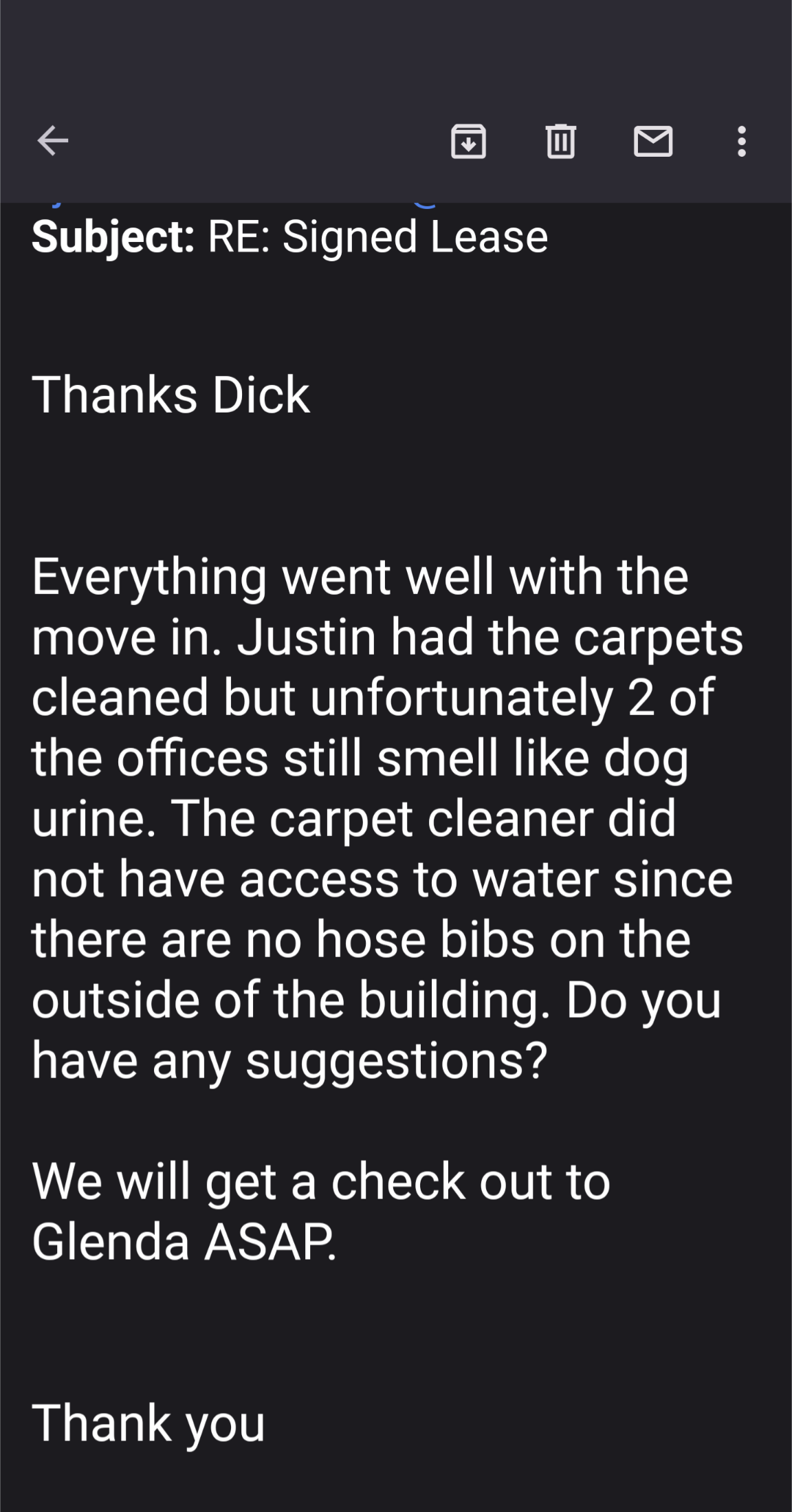

I'm unclear on a few things:
"Two of the offices still smell like dog urine"....Urine in an office carpet? If this isn't a veternarian, WTH is a dog doing in there? (Besides urinating)
Glue down or stretched over pad?
I know how you feel about urine decontamination, so I guess it is also a question of what you want to do versus what you can do.

lawyer's office
Glue down, 25 yo
I am only willing to spray some Cide on anything that glows, and walk away.
I'm still trying to wrap my head around dog urine on the carpet in a lawyer's office.
Are you sure it isn't human urine from when they get the bill for their services?
That much urine (banana sized) on a glue down carpet is going to need a sufficient amount of product applied, pushed down into the backing with your wand with no vacuum hose attached, then extraction after it has had time to work (however the product of your choice works).
If you just want to do what you've already done, and they seem open to replacing it, you have your answer.
