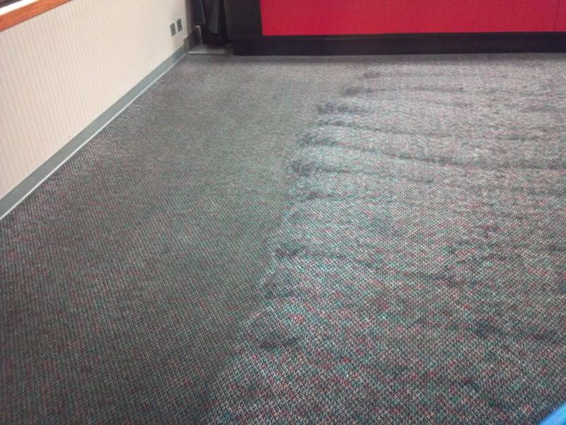

On filthy commercial carpets, we use our RX 20 to clean, but we are having problems with it leaving 'stripes' in commercial glue down carpets. We find the same thing with our Rotovac 360i in filthy residential carpets. Is there a way to avoid this or remove them?

I failed to communicate. The lines are not dirt lines, plugged jets, etc. The lines are due to the carpet pile being stood up in one direction according to the rotation of the head and pressed down in the other. The pile is up down up down up down, leaving an appearance of a striped pattern.

On residential they just brush right out......
On CGD..thats just the way it is...every rotary will do it...after a few vacuums and being walked on it normally sets back down.....
the direction the head is spinning is what does it...the head is spinning clockwise and when you go to the left you are going against the spin and it is pushing it up....
you can work it so this does not happen by working backwards from the furthers point and start on your right and go left..bring it down past that cleaning line and go right...bring it up to the cleaning line...over lap 1/3 and go left...this will set most of it one direction....but to be honest..its not worth it..it all goes back and I have never had one single complaint about it....

ohh like this??
like jim said...it is what it is....
even on res carpets you can kind of see it
