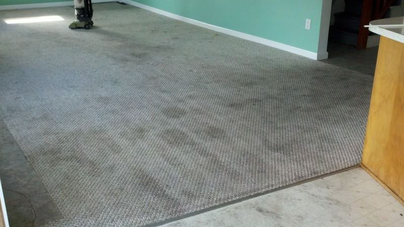

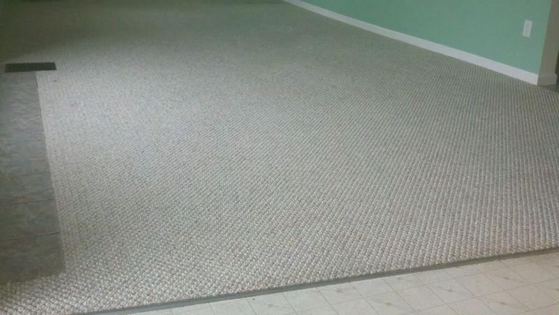

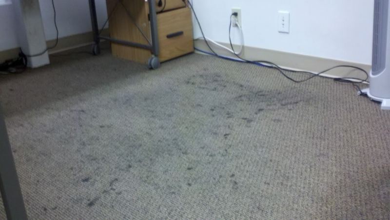

Les sent me a 2lb sample of the blue S&G. I used as directed.. I was amazed, it removed caked in shoe polish, coffee stains and other unknown stains with no problem and NO BOOSTER.
Trashed Green was used as directed. Berber always make us look good.. this job was for a property management firm I gets me a lot of work. I expected some wicking but when I spoke with him a week later he said it still looked great.
ALL JOBS WERE SEBO'D prior and had 15-20 minute dwell. This is not a side by side comparison, but both products work well.

8) Nice.
I could get those results, but like you I would expect some wickback.
What did you use for a rinse?

I use a fresh water rinse.
I was very suprised that the berber didnt wick back at all.. kinda figured it would a little bit.
I wish I took some more pics of the S&G cleaning, but it was a commercial building and people started to come to work. But the carpets were trashed all over like that with shoe polish and coffee. Les S&G got it all out and they loved the cleaning. Thank Les.

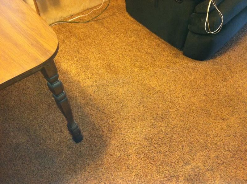

why is the clean pic of the S&G in cepia instead of color like the first one. That could hide alot of dingyness in the carpets changing that picture. ultra pak traffic clean will do the same thing, with no SEBO and no wickback. never had wickback issues on big loop residential type berber carpet.
I think it was when i downloaded it off my phone it changed the color of the second pic.. Its not meant to hide soil or anything like that. You can call it user error.
There are a lot of products that would get the carpet cleaned, the point is the results for these two products. You are more than welcome to create your own Ultra Pak before and after thread.

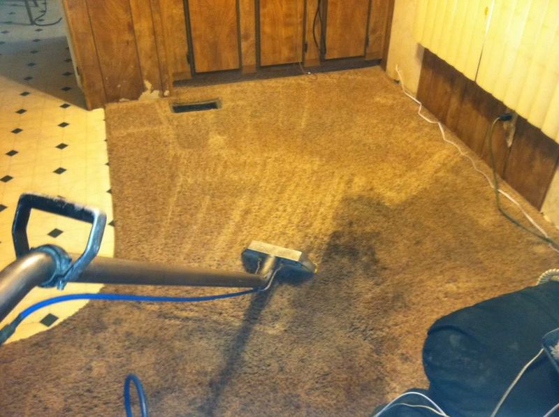

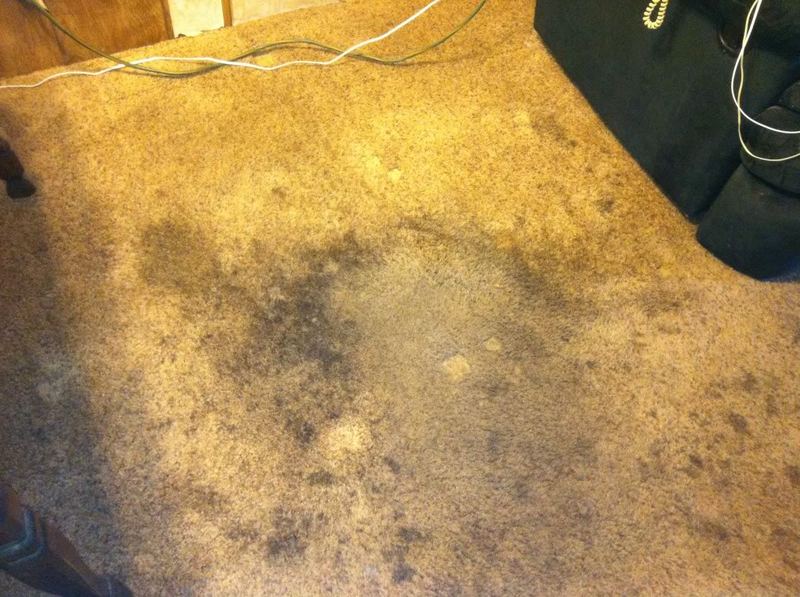

Nice pics
I was wondering could You do this with a pad???
S
I a have no extenders on this wand currently and a banana glide from mytee hybrid, same jet setup You use. 1.5 110 in the middle and 95 on the ends
I have 1/2 extenders but havent used them lately also I pulled the glide and left the extenders and got some bad streaking on my carpet.
I would think with the glide the 1/2 inch would be fine with out the glide be careful.
Yes if you pulled the glide then the extenders have to go. Personally I think the wand unglided will clean 10 times better 90 percent of the time. There are situations that the carpet will clean better with a glide. My glided wand almost never streaks, but the picture you posted (shag polyester carpet) has been notorious for streaking with my glided wand unless I go over each area four or five times. That is one instance where a rotary would shine.
S
I'm 48 with hand that are all locked up I went glideless for 10 years! no more!
But Ya I believe it doe lift the carpet better in most cases
