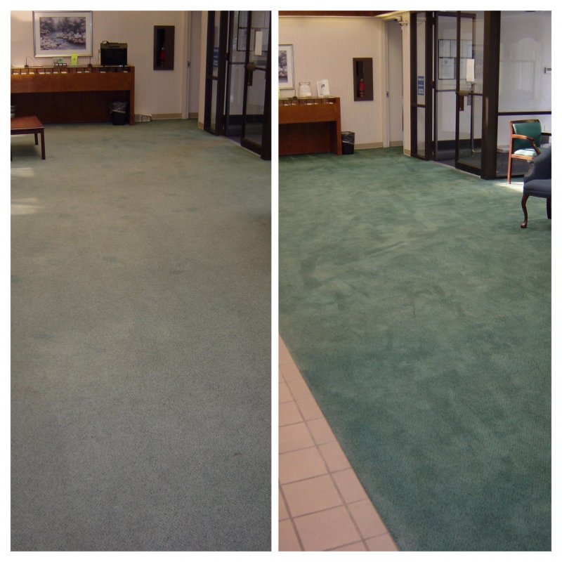

Glad to hear that it works well. If it's not rinsed from the carpet and neutralized it's going to wreak havoc, however, as is true with any high pH product.
As an example, look at the entryway of this bank carpet that we did a ColorClean on (a process that cleans and restores the carpet in one step). Color has been bleached out from use of high pH traffic lane cleaners that weren't rinsed out and neutralized. We get heaps of business from these types of products.
Not knocking the Sauce here. I'm sure it performs well. People's comments are a testimony to this. I just hope people realize the need to rinse it out and neutralize it after its use.
I'm not calling BS. I'm just saying a photo of a carpet that's 10 years old and a photo of a carpet that's just been dyed? Doesn't prove high ph fading. Was it completely even? where's a picture when it was installed originally?
How many jobs have we done using the same products only to move furniture after a move out and not see all this color loss?
Not saying it can't happen but sun fading is more prevelant then high ph color loss.
I've seen color loss from home air machines with ozone treatments. Or chlorinated water in a swamp cooler causing color loss.
How often do you have pictures of carpet that you clean when it was first installed?? :hopeless:
Sun fading is absolutely not as common as color fading in traffic lanes from high pH chemical residues. It's quite common, yes, but not nearly so much as chemical color fading/loss.
Commercial settings...those aren't carpet cleaners.
Dem's Jan-it-ors, part timers that could care less about carpet cleaning. Its just one more chore forced upon them. They hope their walk behind breaks just so they don't have to use it.
High ph color loss my azz! :winky:
My point is you clean the same carpet for over 10 years they move out and carpets that have never been cleaned because a huge hutch covered it looks the same as the carpet you've been cleaning the last 10 years.
Reactions: Todd Millar
11,495
I wasn't saying high ph doesn't do it either but you picture doesn't prove or did prove it.
But your professional opinion on the other hand does carry weight.
But your professional opinion on the other hand does caries weight.
Thanks for the feedback. I appreciate your comments.
