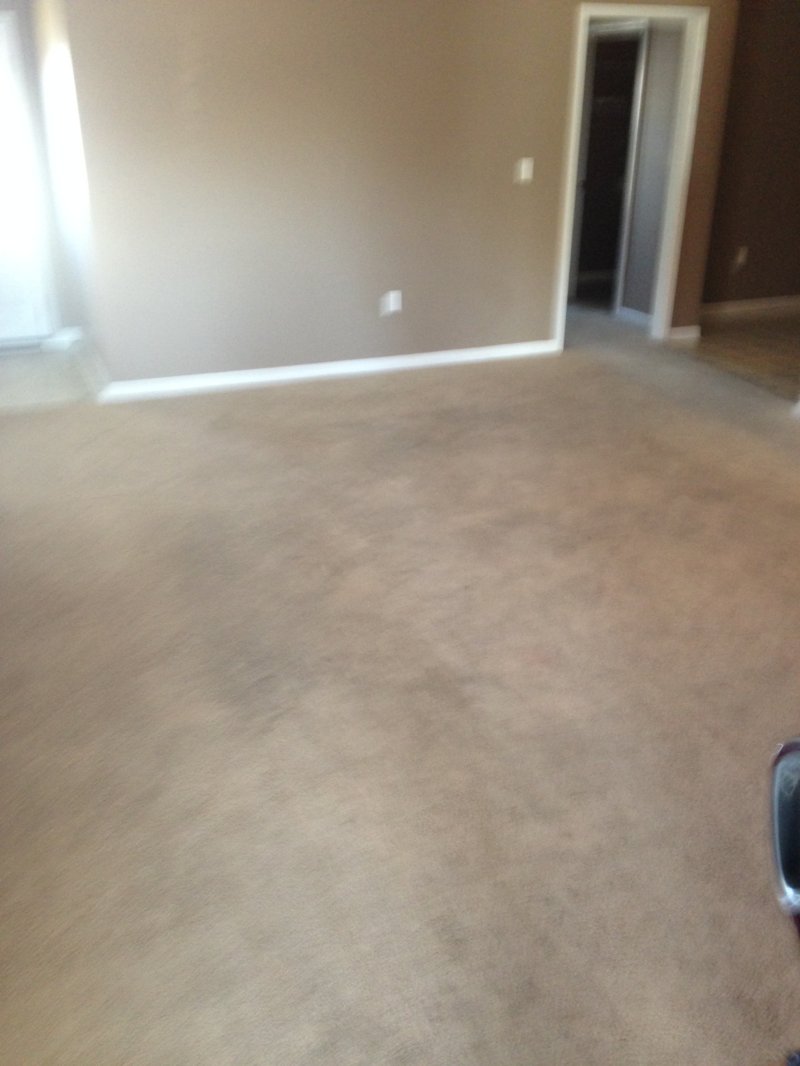

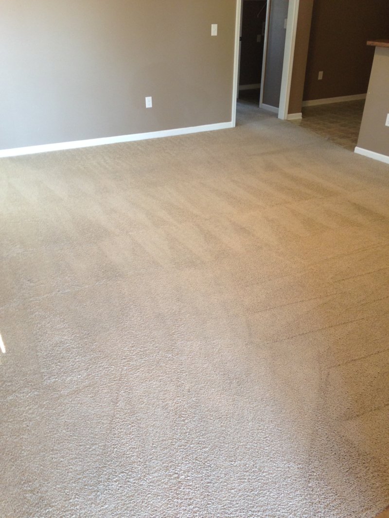

Really pleased with my results today using Saiger Sauce. Here are my before's.
