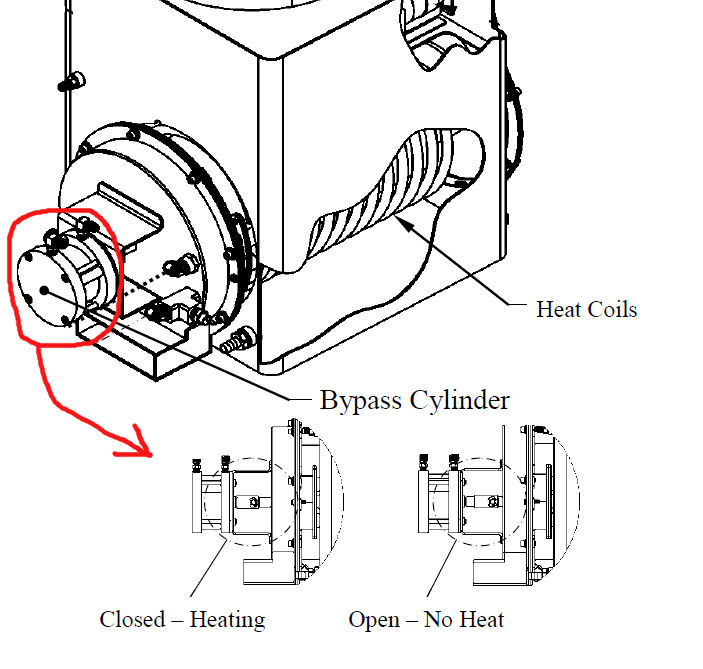

Fellow owners, you are aware that the Bimba valve will not engage if the system is not under load and running at 70% or more?
In other words let it RIP when you're prespraying oif you want mega heat for the first room...
If not a smaller 370 may never catch up if you're heavy on the trigger from the get go..

What's a bimba?
11,559
Cap off the in take and put it under load it will heat faster

Ohhh, and yea. Lube the bimba...
You can also get cracks in the plastic tubes going to the bimba and blower(i believe) that can cause it not to get the 7hg it needs. That was a tuff and very frustrating one to figure out...:(
Screw driver as last resort...

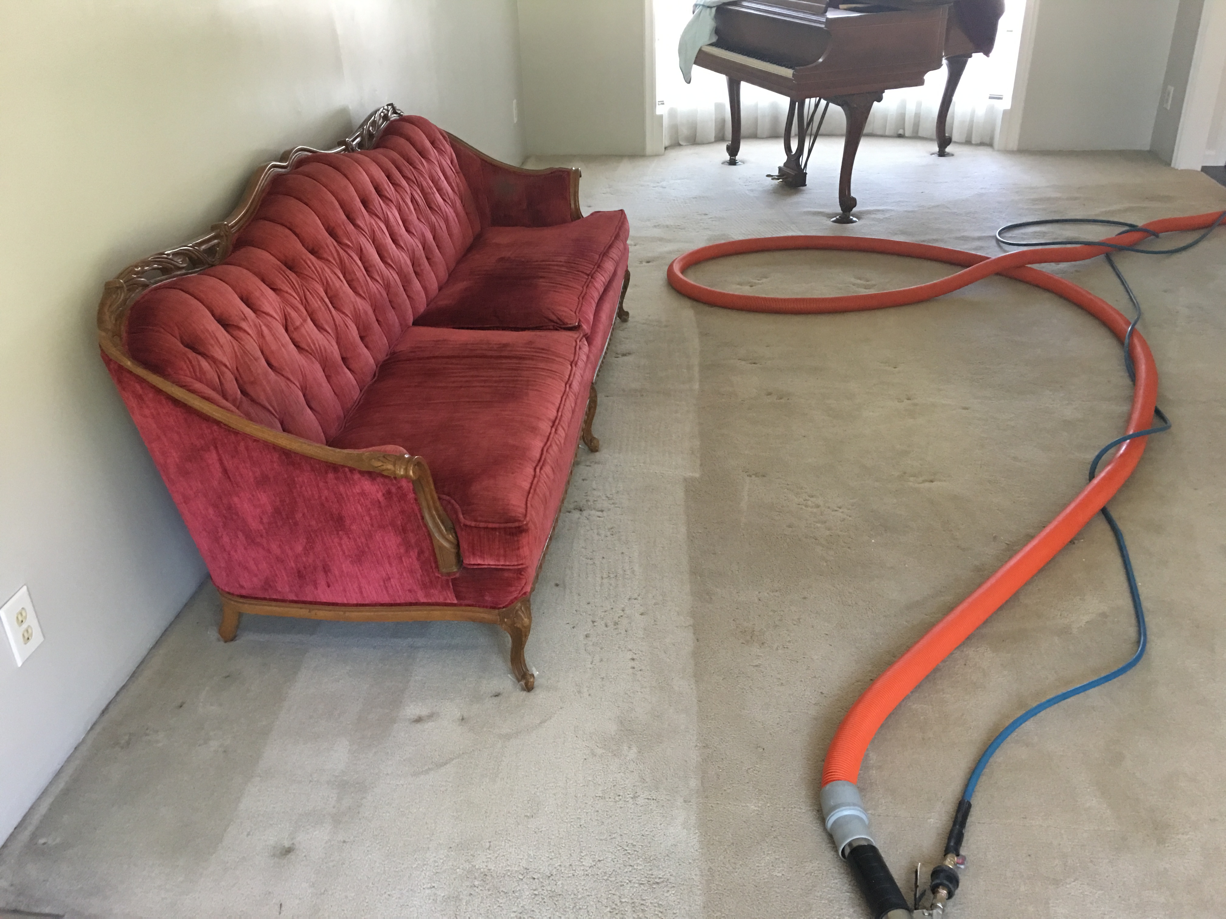

My first job today took me 5 hours. It was a nightmare MacMansion. 40 year old carpet that hadn't been cleaned in over 10 years. The lady got mad at me when I refused to move her Piano and washer/dryer. It would have required me to unhook all the water lines, gas lines, and dryer vent lines. Screw that!!!!!! She ended up calling a friend to move the washer/dryer. The piano stayed in place. I think they both found out what a pain it was and in the process they scratched up the linoleum. I'm so glad I planted my feet and stood my ground. I usually fold.
7,040
Don't you have a 360i BH?- If not get one.
Or do you like doing it the difficult way?
