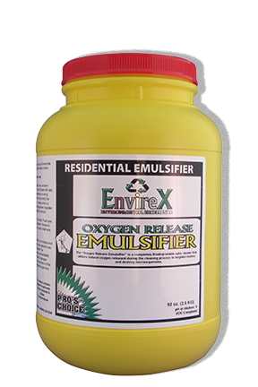

OXYGEN RELEASE EMULSIFIER
Description:
The “Oxygen Release Emulsifier” is a completely Biodegradable safer cleaner that utilizes natural oxygen released during the cleaning process to brighten textiles and destroy microorganisms. When used as directed, “Oxygen Release Emulsifier” will give you a cleaner, brighter, fresher, residue free clean. “Oxygen Release Emulsifier” contains no solvents, no butyl, no surfactant, no soaps and no chlorides.
Carpets cleaned with “Oxygen Release Emulsifier” stay clean longer because no residue is left behind to cause re soiling or contribute to chemical sensitivities.
Usage:
For Truck Mount extraction concentrate, dissolve 1 lb.(approximately. 3 cups) “Oxygen Release Emulsifier” Powder into 5 gallons of water and set flow meter at 6 to 8 GPH.
For portable extractors, dissolve ¼ lb. (Approx. ½ cup) into 10 gallons water. “Oxygen Release Emulsifier” may be used as a pre-spray solution prior to cleaning. For pre-spray solution dissolve 2 oz. “Oxygen Release Emulsifier” powder per 1 gallon of water and pre-spray heavily soiled areas prior to extraction clean.
IMPORTANT:
To achieve best performance, cleaning solution temperatures should be from 150 to 200 degrees F. Higher temperatures will achieve greater oxygen release for better brightening and microorganism kill rate.
We use this on our portable jobs and love it.

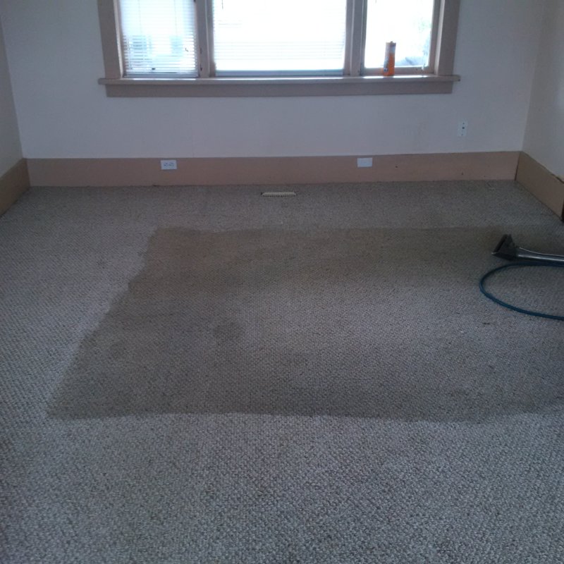

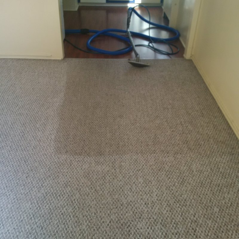

heres what Procyon plus powder can do. 16 ounces in hydroforce and 2 ounces per 5 gallons in portable
