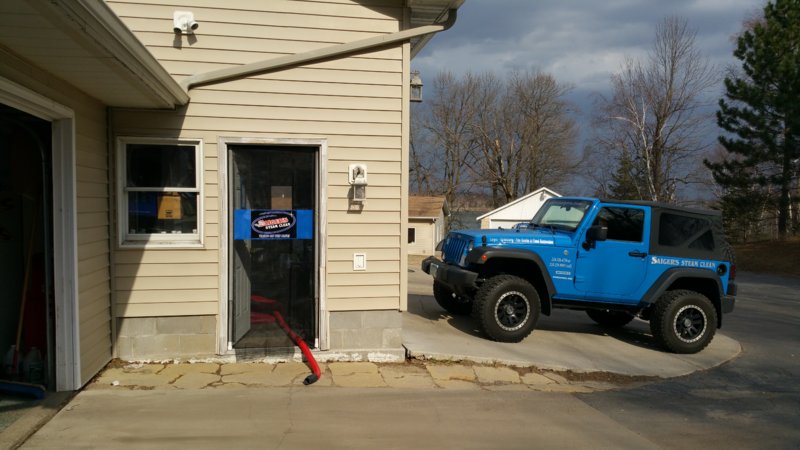

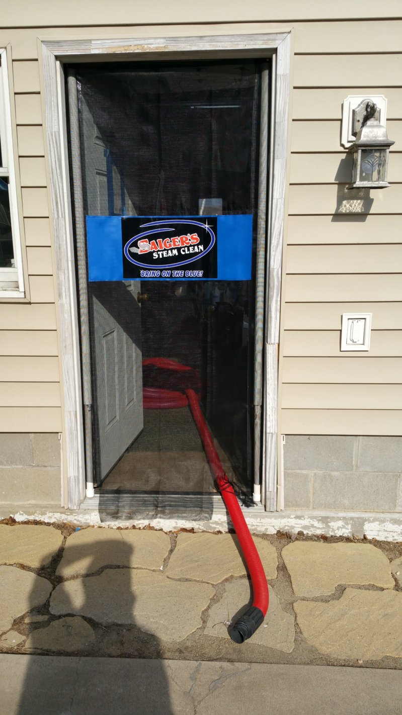

I always have kept the door shut as much as possible. Now with the Seal a Door it keeps the house too shut up.
We run lots of air movers and speed dry the carpet. The Seal a Door keeps all the humidity in the house. The windows in the house are fogging up and the carpets are drying a little slower.
Anyone else notice this?
11,200
Or get a Super Screen.... :)
http://mikeysboard.com/forum/index....er-screen-by-seal-a-door.278718/#post-4362686
It the time of year. Moisture condenses on the windows because the elevated humidity up against the cold window glass acts as a condenser.
Try blowing your airmovers at the windows to keep the moisture from condensing.
