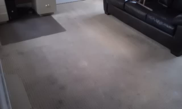

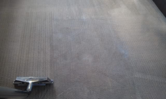

Had a carpet today with "oxyclean" residue from the maid. She swore she only used water and the homeowner believed her..... :shock: What looks like spots from a light is not - lights turned off. Worst I have ever seen.
Some dirt from the residue
Too bad, was in a 2 million dollar home. Most dirt value, but still a nice place with ruined carpet.....
