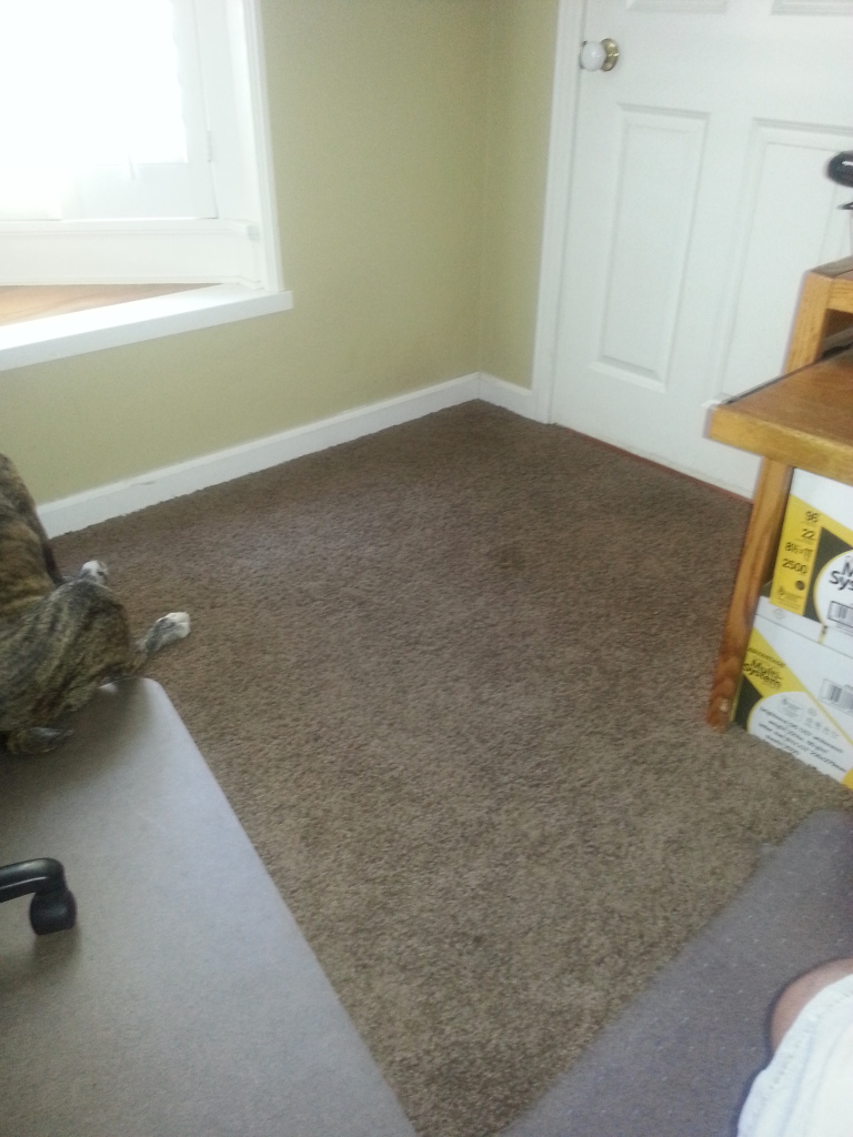

114,139
No crushing here, I could lift those mats and it would the same, 3 dogs on it all day long.
and yes, that is a pee pee spot.
