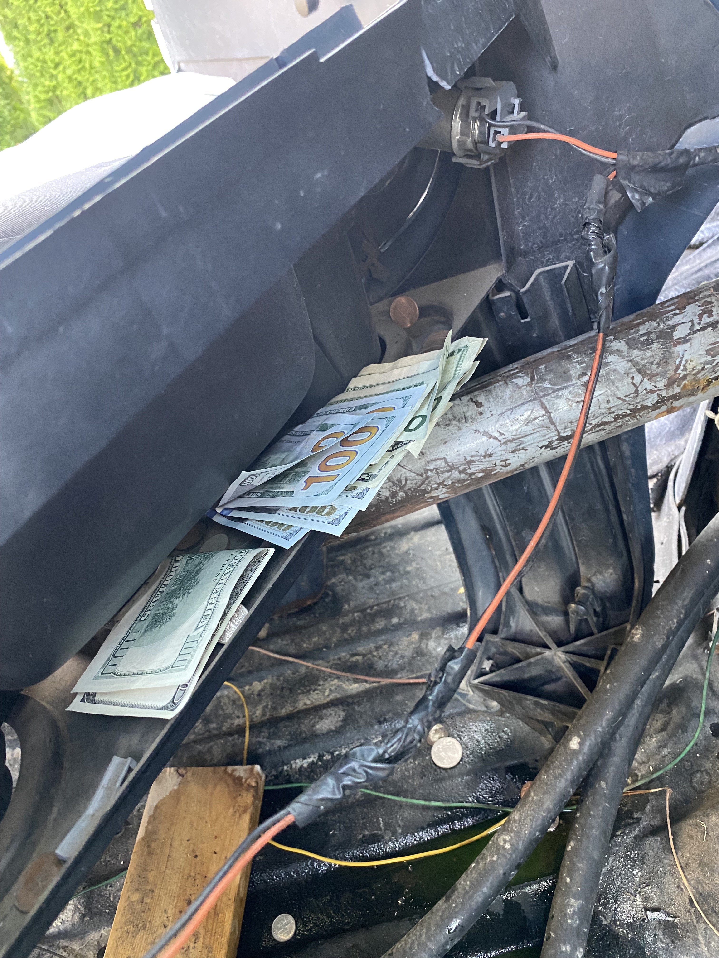

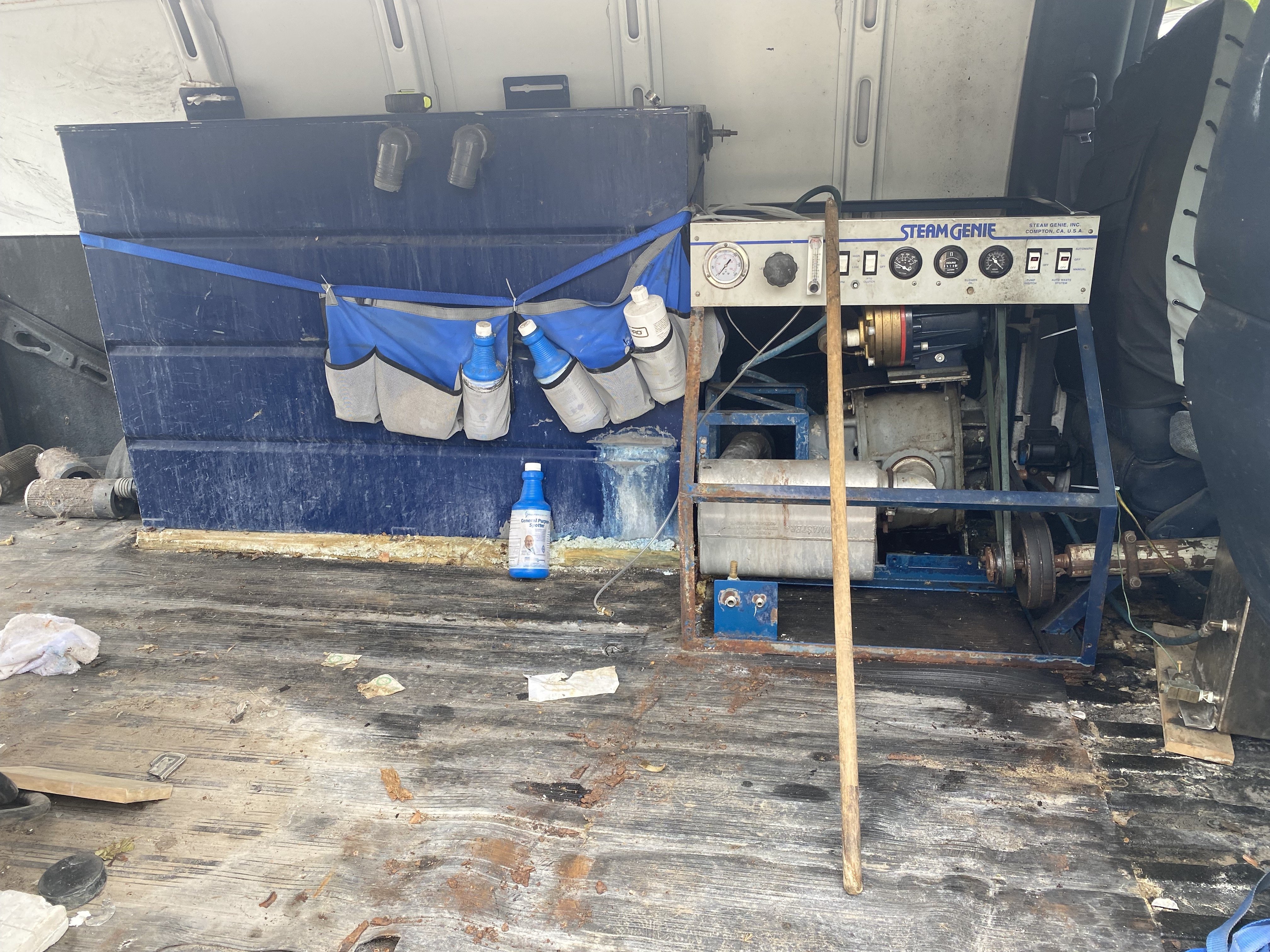

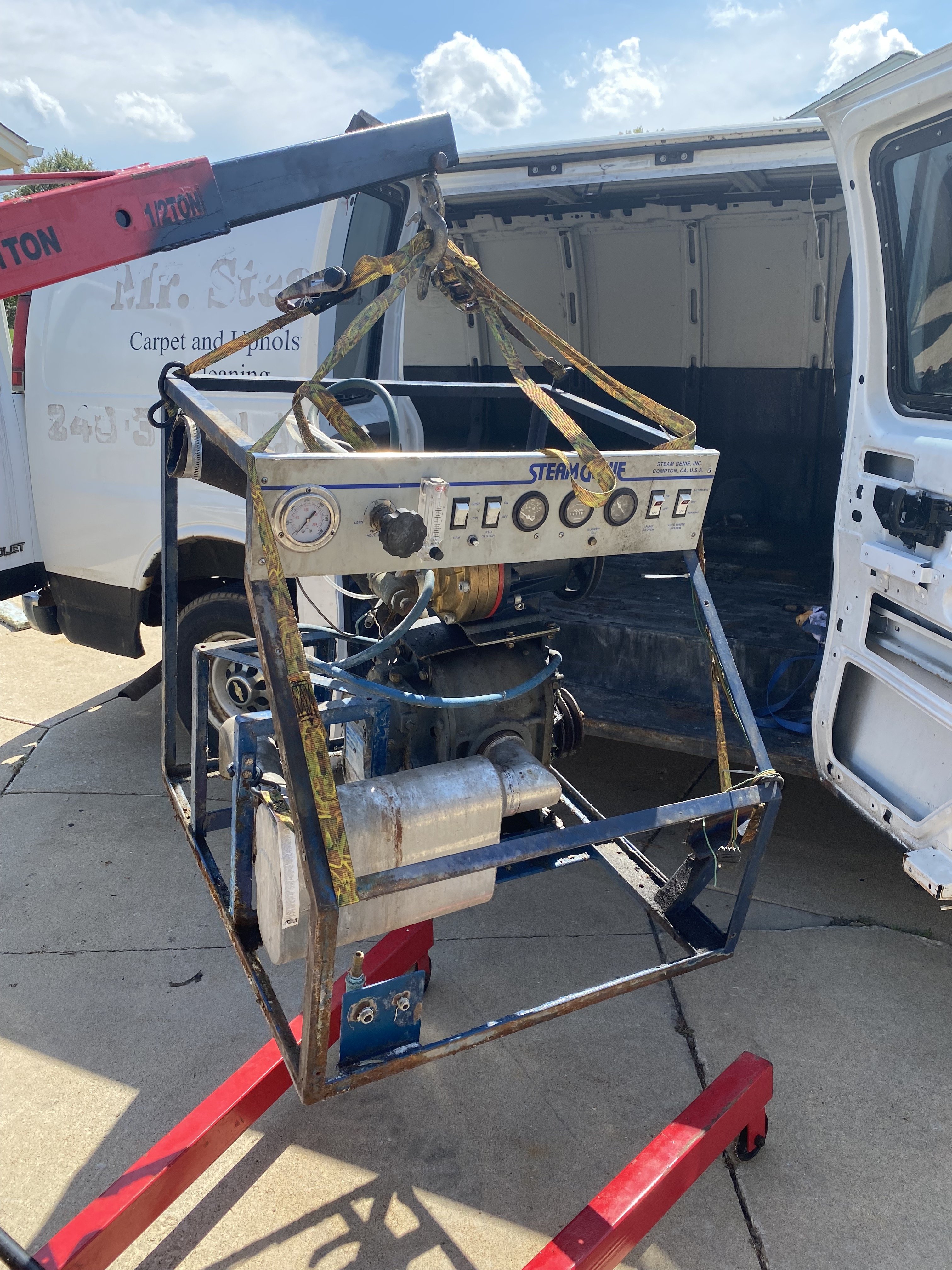

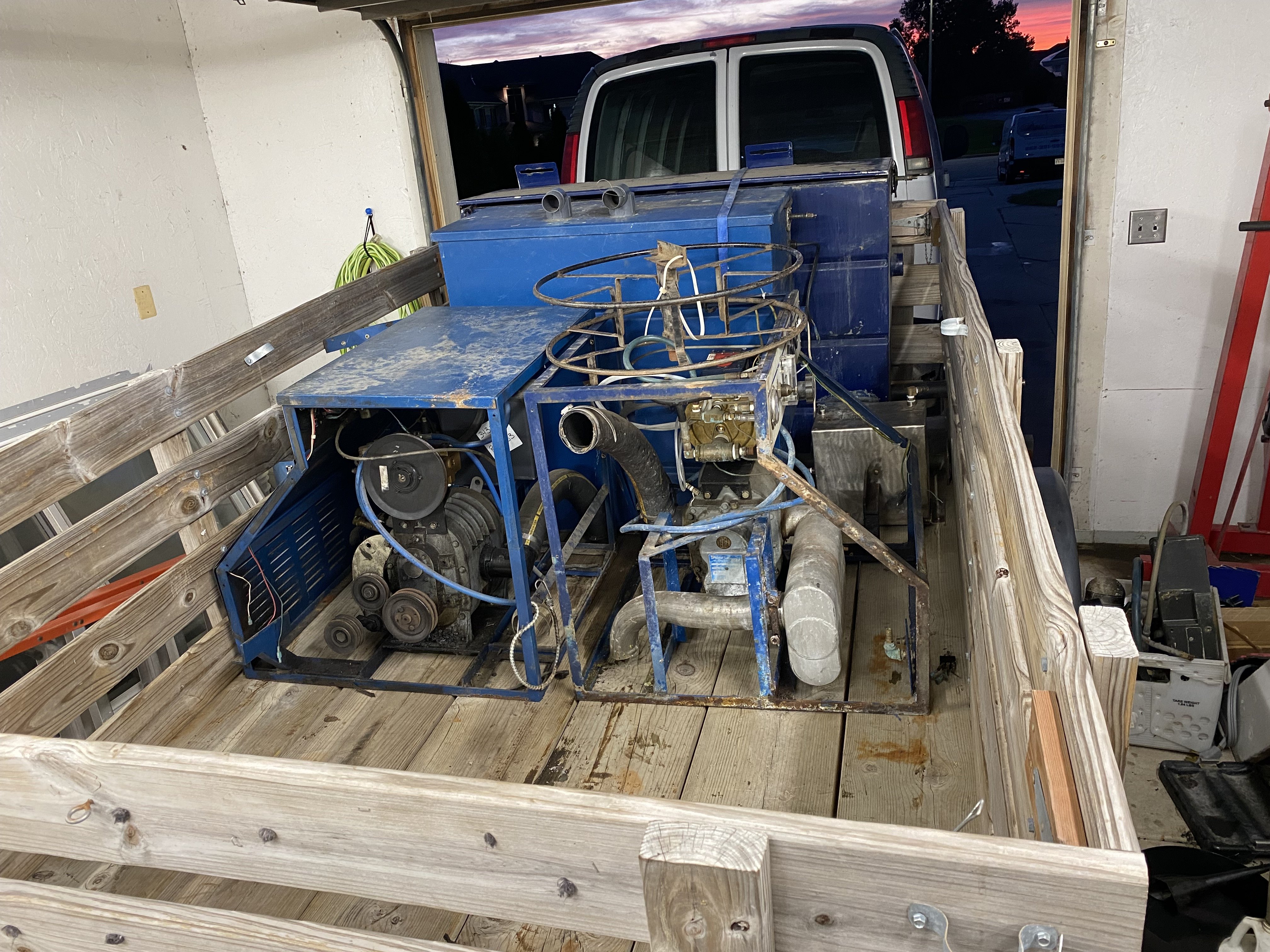

It took Keith and I about 2 hours to pull everything and then drive that (heap of a van) to the scrap metal.. They gave me $1,000 for it, plus I found some money behind the center console as well.. Thanks Bawbby or Crash..

I seriously can't believe someone was doing work what that van up until Bawb got it.. The receipt book with dates in it was classic..

Sounds to me lik YOU owe Fred a cut....
Wait till I show CRASH the money shot....

So Nate....as you can imagine...I couldn't WAIT to send CRASH that picture....and he sez that was his hiding spot and he wants his cash back.....he DID sound a little ill after
Seeing the pic.....

We washed/sucked out the sh!t with Apex machine with a Devastator filter on it.. Inside looked Bawb new..
Keith was pretty shocked and impressed when he actually seem how simple of a machine it is.. I offered him 1, but he bleeds Prochem.. Plus the Ford Transit's aren't compatible as of right now..
I mean if you have the will and a lot of money, you can make it work.. There is only 2 outfitters who mess with the Transits to add a T-case and PTO.. Need a redneck who can make it work for peanuts.. :winky:
