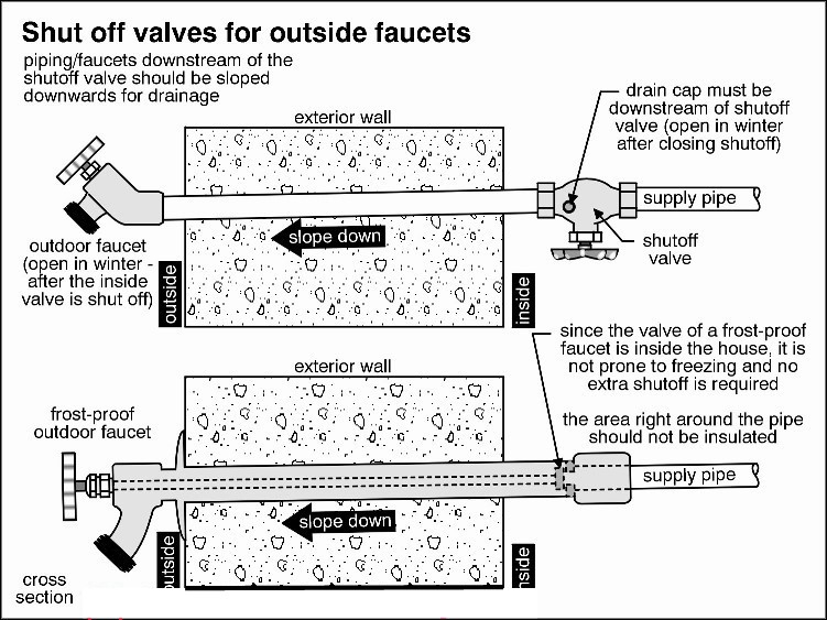

I know the faucet well....
They are frost free..
Often when a hose is left connected in cold weather, water will not drain from the neck of the valve. Freeze and break.
It will only leak when turned on.
So, I always.. Year around connect, turn on, kink hose and listen. Often besides hearing you can feel the hose does not back up pressure. A sure sign the neck is leaking.

Many frost free valves have the knob right on the front.. so the shaft can extend back..
Non frost free have the knob on top, or at and angle.

Reason it froze and broke is because often a hose was left connected and the water was not able to drain from the neck of the valve, after the stopper.
Take the hose off, all the water drains from the valve..
Works much like one of these..
image.php
The valves are ever stamped or printed, Remove hose in freezing weather.
I'd say 50% of my clients don't.
The thin brass ones break easy.. The heavier more common ones stand up a bit better today.

The valve is designed to shut the water off 12-18" back into the wall or building.
yeah...I get it now.....well a couple post ago....
just counter-intuitive.....I guess at first I envisioned the ability to close the line in two places with the one valve..independent of one another..not sure how the fook I though that would work :oops:
