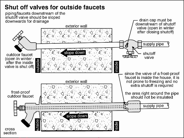

Steve T said "Buy a female cap with a rubber hose washer inside that will thread on any faucet bib. After tightening the cap on the hose bib briefly turn on the faucet slightly and listen closely. (You can also keep your hand on the faucet to feel the vibration of running water.) If you can hear (or feel) running water the faucet has an internal rupture inside the wall. Turn it off immediately, inform the homeowner and find your water supply elsewhere."

Often when a hose is left connected in cold weather, water will not drain from the neck of the valve. Freeze and break.
It will only leak when turned on.
So, I always.. Year around connect, turn on, kink hose and listen. Often besides hearing you can feel the hose does not back up pressure. A sure sign the neck is leaking.

"Surprise! So-called “frost proof” water faucets will freeze and split internally if a hose is left attached over the winter. However, this hidden rupture won’t be noticed until AFTER an unsuspecting cleaner hooks his hose up and turns on the faucet. So while the carpets are getting cleaning upstairs the home’s lower level is being inundated from the ruptured tubing hidden inside the wall. (Don’t ask me how I learned this!) Time to change your procedures …
Bonus TIP: Be very cautious early in the spring time with an outside hose bib that appears to have had a hose attached to it all winter. Very likely it is an “accident waiting to happen”. I know I did way too many “free water damage losses” and replaced too many hose faucets that the homeowner was sure had “burst due to your cleaning pressure”.
So be very, very careful and test all water faucets with your cap until later in the season when the home owner has discovered the broken faucet on their own when watering their lawn. After all, when the home owner floods their own home it then becomes a PAID water loss that you can make big money on!

so what did you end up doing to fix the problem???? this was a rookie mistake pure and simple. myself and everyone I teach is taught to freeze check the faucet. just hook up the hose kink it turn on the hose, listen and feel if you feel the water flow stop when the hose is kinked its fine, if the tone of the water flow doesn't change you can feel water still flowing you have an issue. just last week I cleaned for a neighbor and family friend. she did not tell me the faucet was bad, but I checked it then went in an asked if there was a problem with the faucet she confirmed there was. fortunately it was in an unfinished basement and it didn't matter that a 1/2 gallon of water spilled out. they had just left the faucet unrepaired for the last couple years.
