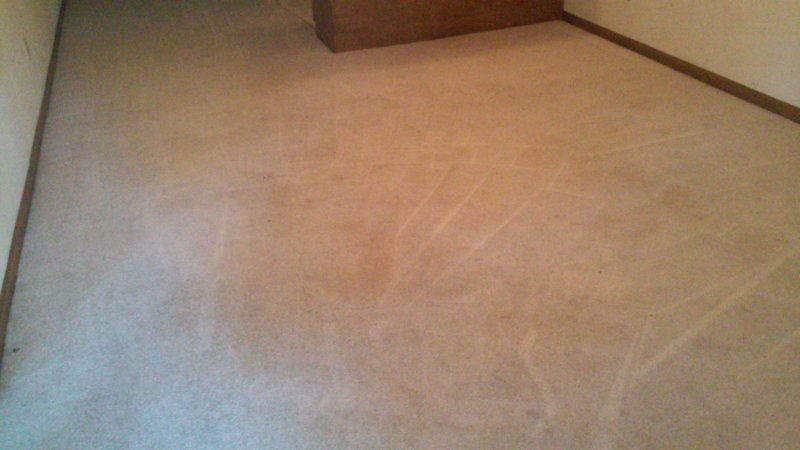

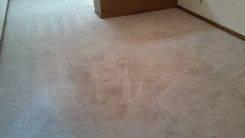

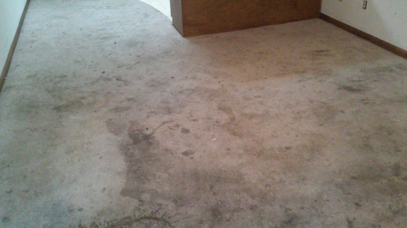

I had to do 2 HWE on this one. I tried the blue and grey post bonnet, and it didn't touch it.
This is where we need to charge a restoration price vs a normal cleaning.

The water that came out of my waste tank the 2nd time around was just as black as the first time. I was considering cleaning it a 3rd time, just by the way the waste water looked, but it was just a rental, so I left it as you see.

that job I posted on here was scrubbed with both a red pad and a brush on a 175 two different times
So you had great agitation. Your flushing could be improved with a RE or a Zipper.
BUT maybe it still needed two cleanings??
