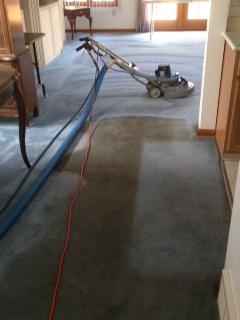

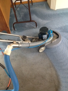

Soil Overload job today. A fire restoration job. Had to clean twice from the amount of pre-fire soil.
Used a mix of hot Grease Eraser and Flex. Finished off with a wand flush stroke, vac stroke. Good thing custy had a/c on full. It was 95/90 temp/humidity. Hoss 700 at 600psi.

We've all cleaned carpet that is literally "overflowing" with grime.
HWE alone will get 3/4 of it out and the rest comes you to haunt you as it dries.
VLM alone (get 5% out and push the restv tiki the bottom)and it looks good for a bit longer but looks dull and lifeless once the check clears.
Are there any manufacturers or iicrc gurus promoting a proper multi step process?
Vacuum, aggitate or Rotary extract, let dry then buff or bonnet clean? Why is that so hard to sell, not only till carpet cleaners but to the carpet owners?
No, instead we have giant truckmounts that can suck all the way to China and miracle microfiber pads that can hold 50 gallons of goo in a quarter inch of foam..
Its all about shortcuts...
When there really isnt one in an overloaded situation.
