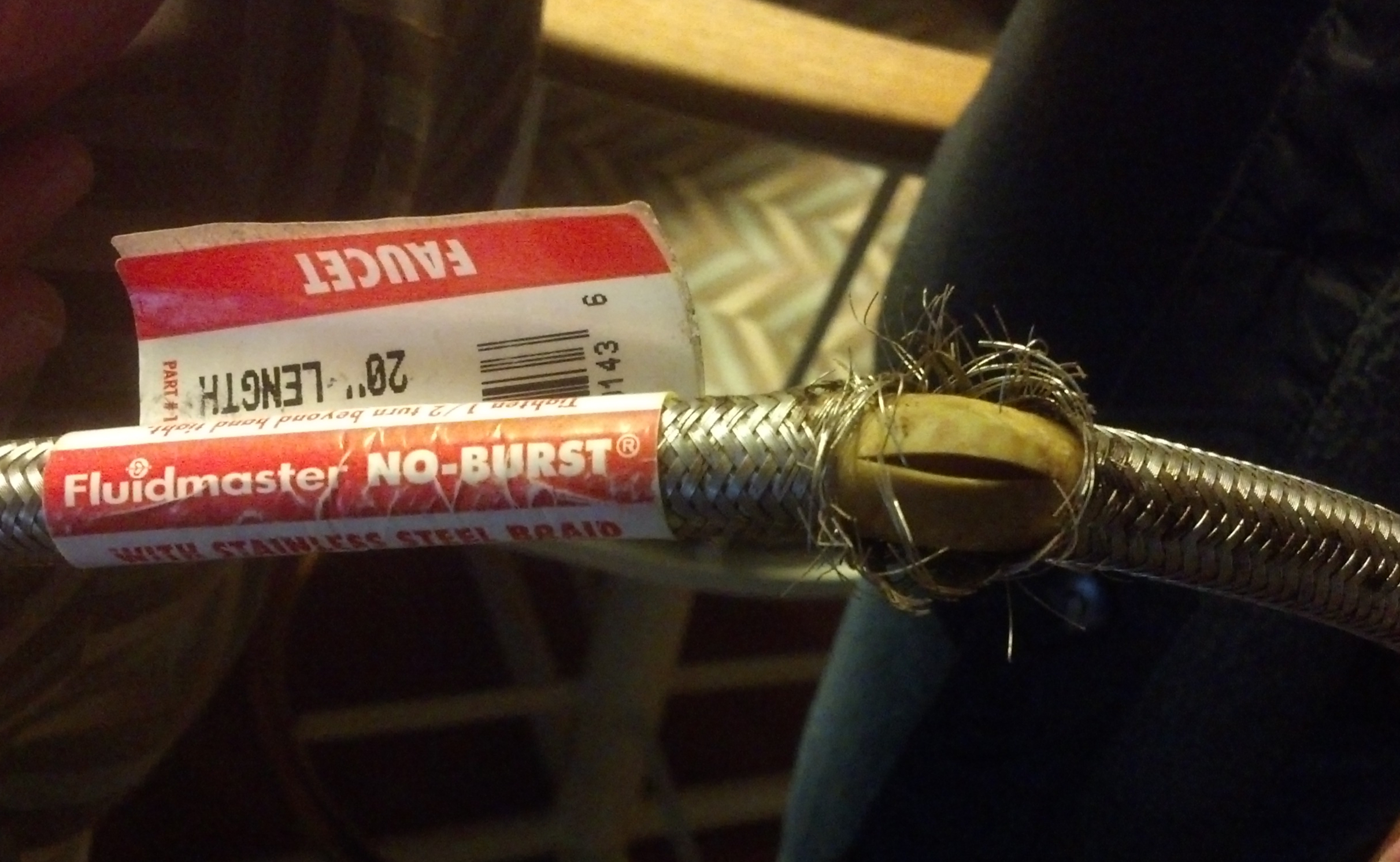

As strong as steel braid is, it is not bullet proof.
If water with cleaning or rinse solution gets between the braid and the liner, it corroded and breaks. At least that's what happens with black death.
This is a hot water hose to the washer at WDR loss we did a couple of years ago . State Farm used to hand them out to their insured. At least until they figured out they had liability in doing so. :biggrin:
We had to snap a picture. "No Burst" lol
