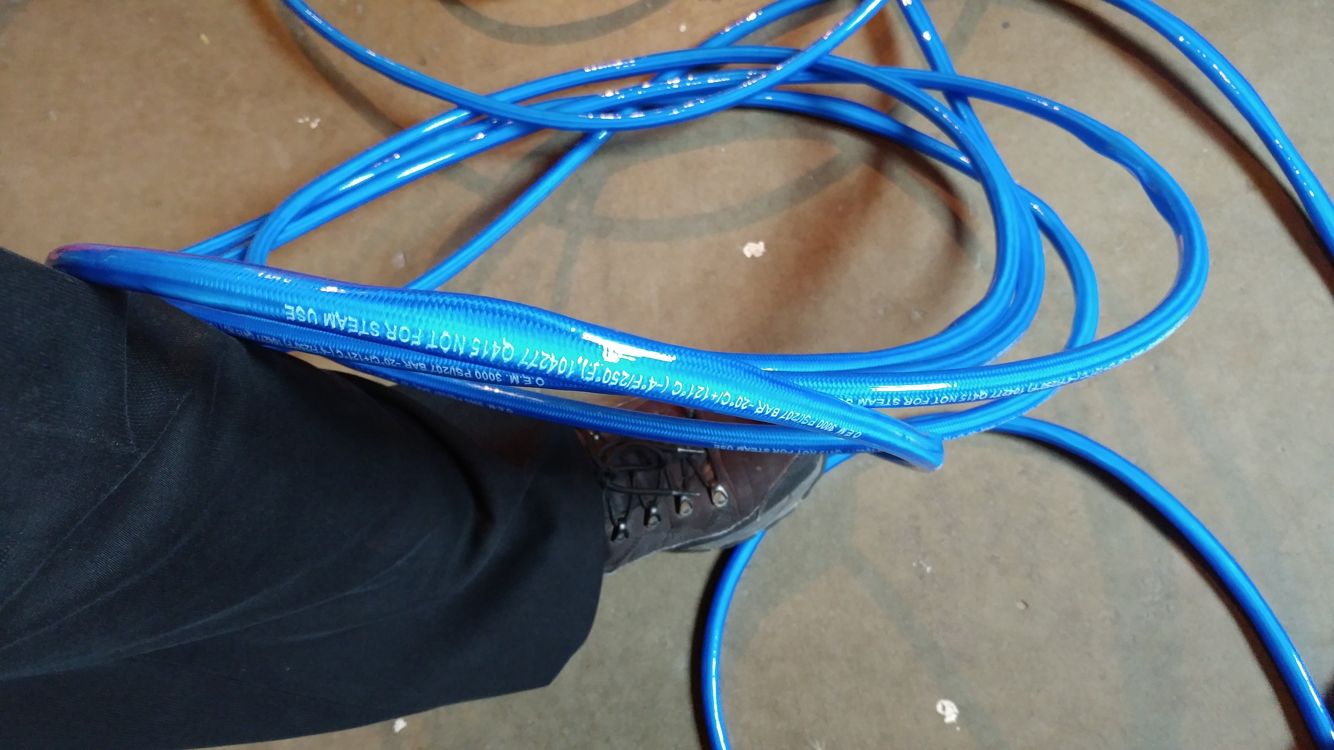

Yes, this hose says right on it, Not for Steam. My thermostat, that activates my dump valve for cooling, failed. I was getting well over 250F at my heat exchanger. It really spiked one day and I was blowing steam. It bubbled, or bubbed :winky: , the outer wrap. The hose itself seems to fine yet.
I do like the weight and the flexibility of this hose. The outer covering gets a little sticky so it doesn't slide well on itself, but it lays out nicely. No coiling.

Click on upload photo, pick photo,
After it’s uploaded hit full image
Ron Werner
8,726
Ron Werner
There, that was easy.
You can see how the outer covering has blistered away from the hose.

It is an issue. The question is what temperature it actually reached.
Ron's Quote " I was getting well over 250F at my heat exchanger. It really spiked one day and I was blowing steam."
We have been over 250'F with several TMs for 6 months and not seen any blistering.

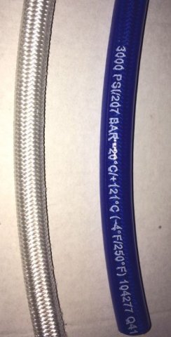

What's the burst test rating on these hoses Larry?
And I think you guys are a little over paranoid about the steam. Which hose is stronger when it's rated at the same max temp if it exceeds it's maximum capacity? Both are rated at 250f. Hydroforce's steel braided or This thermoplastic hose? Keep in mind that if it's that hot, the steel braided has already burned a line in the carpet

I would be very concerned about Ron Werners hose. Think of blowing up a balloon, when you initially blow it up it takes alot of effort, subsequent times it is much easier. That hose will not take the same heat and pressure that it initially did. With Ron's hose there would now be two strikes against him if he continued to use it. (1)Not to be used for steam, as the Desk Jockey said we market steam cleaning. (2) you would be using a hose that is visibly damaged, if someone was to get hurt from it who do you think would be on the hook?

Rare that a steel braid hose will burst but not unheard of the ends popping off as it softens from excessive heat.
They burst frequently due to inner tube failure & rusting of steel braid (black death) .
We had one customer who has blown quality crimps off of two different wire-braid hoses the last few days.
One of the hoses we tried was rated at 275'F @ 3000 PSI.
That is a sudden release with more potential.
Excessive heat will damage any hose.
P.S. Burst test on quality new hose is over twice rated pressure.
Our new blue hose is 4 to 1 or 12,000 PSI test at manufacturer.

Ron needs to cut off the damaged end & recrimp.
The hose takes industry standard 100R7 crimps.
I just talked to Ron
His problem came about when his John's Custom HX sensor failed and let the unit get too hot for too long. he has a "blister" at the machine end of the hose which he is not concerned about. He feels the clear cover has nothing to do with the integrity of the hose, and if it were to blow, it's at the machine where (maybe) no one will get hurt.
Larry is correct, Ron should cut off that section of hose.
