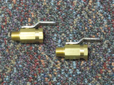

I got one of those at the local supplier because I asked the lady what is your best valve
Sucker cost $28 and lasted a month before it became worthless (couldn't connect my tools). So I just order some cheepos and accept their limitations and change them out when they fail in 4-12 months.
Like these from ebay:
Same experience as Art. What a waste of money are those valves.
