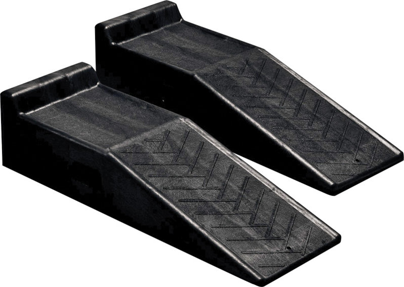

I had problems with my tanks smell but, it did not have an access hole in it, so it was hard to rinse out. After I made an access hole that made it better to get at to rinse out. I also got some auto ramps to help with angle some.
Try some of these.
9,766
Try some of these.
Just don't trust those while doing work under your vehicle... Not my picture...
