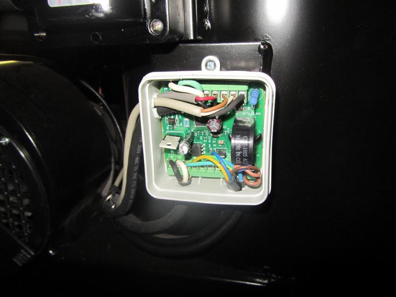

Something you do not want to see on your new truckmount.

A circuit board made in China that controls all the electric functions of the machine. :confused: It craped out with today less than 40 hours on the machine.:madd: I was able to bypass the pump clutch and clean without heat. Luckily it is covered under a 90 day Warrantee . :oldrolleyes:
I bought an el Diablo because I thought it was simple easy to work on based off the Steamway. If / when it goes out again I’m going to bypass the damn thing which will be a PIA working off the candy ass wiring diagram from Masterblend. :madd:

Send me a copy of the wiring diagram and maybe we can come up with a more reliable circuit.

That circuit board looks like the control board for the:
1. Heater flow switch,
2. Temperature Thermostat
3. Oil Burner Fan
4. Oil Burner Solenoid
5. High Voltage Ignitor Transformer
6. Pump Clutch Switch
Remember the 90 day warranty on electrical items.

I have experienced very few problems with the oil fired heating system on the steam way. In fact the only part that has ever failed is the flow switch which must be replaced every 200-300 hours. I have seen much more problems on the HE units with mechanical / electric failure which generally involve proprietary parts.
There are defiantly some problematic parts on the Steamway like aluminum waste, water box and chemical tanks and oddball plumbing.
The El Diablo seemed to have improved and simplified the Powermatic. I still do not understand the need for the circuit board.
