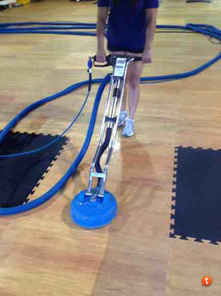

Also try it on gym floors. The interlocking mats. I clean a couple gyms an they love it. Sell em in sanitizing and charge more than t and g.
