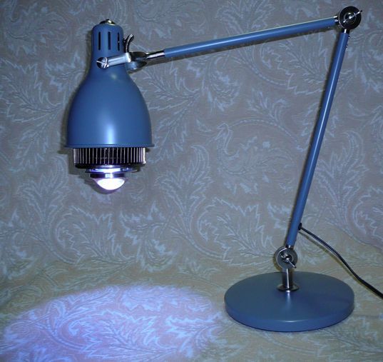

Florescence can be removed by strong Oxidizer AND a strong UV light.
It would take one of these to do it relatively quickly:
