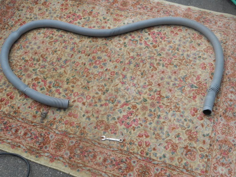

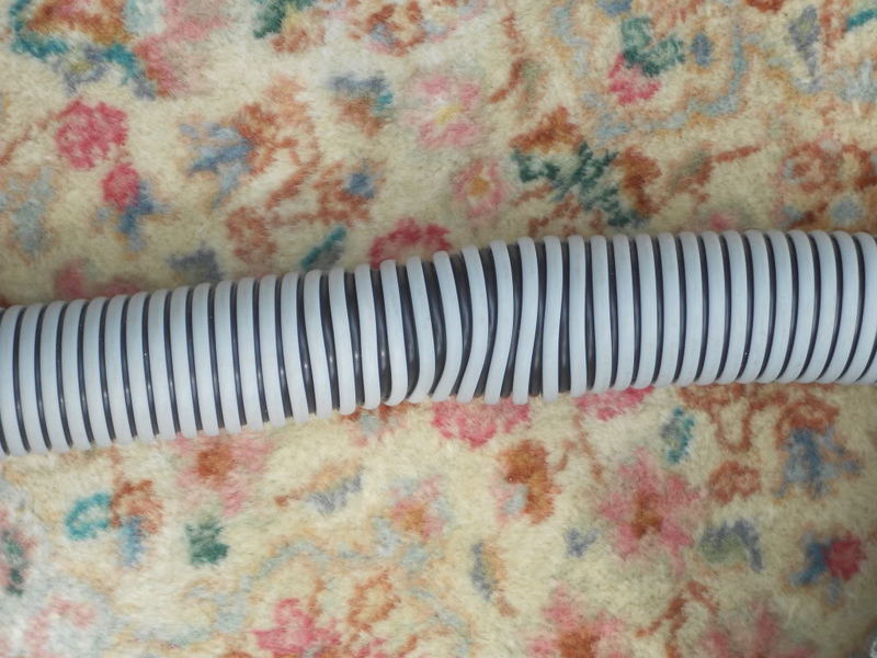

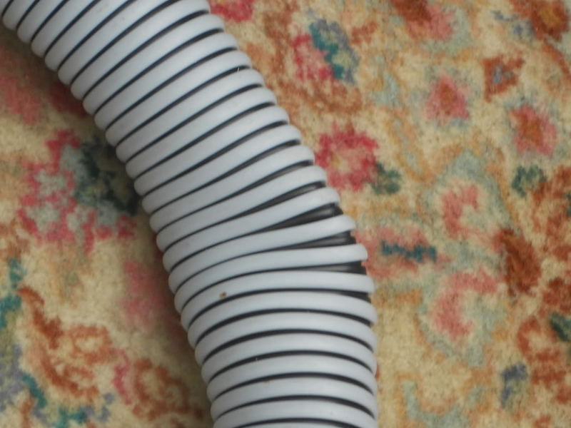

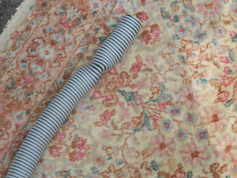

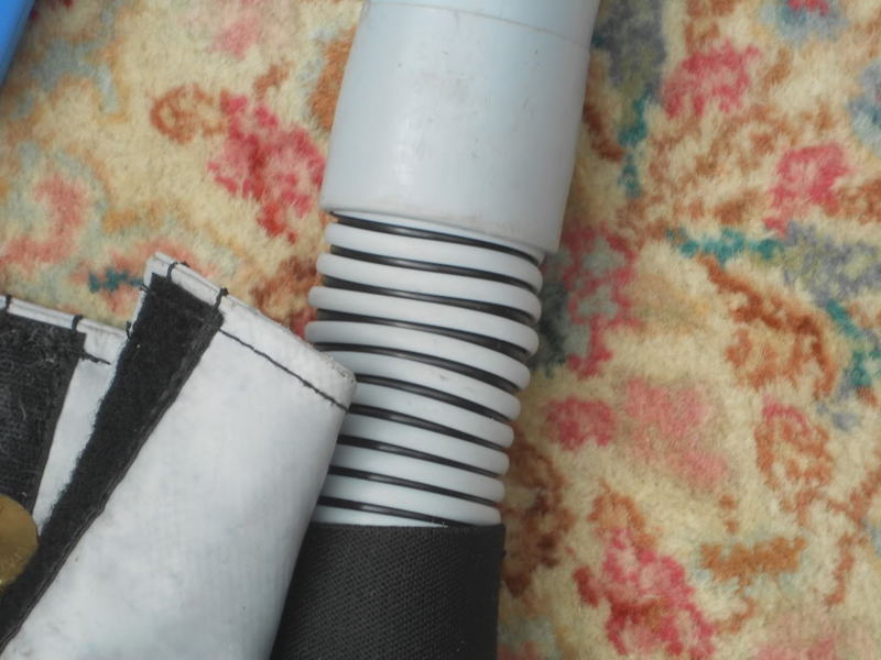

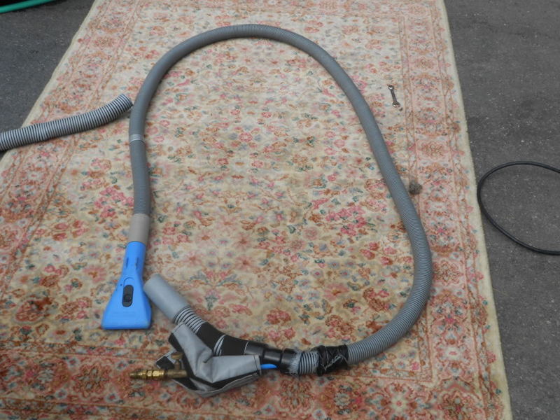

Had to pull apart the drimasters and switch hoses. I am at home today with a sick kid so I decided to start going through some of this stuff. SS I need a new , better hose. The Drimaster hose is smaller and the SS isn't working as well now. I was thinking of putting a 2 inch hose on it today instead
