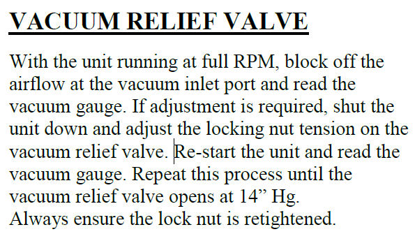

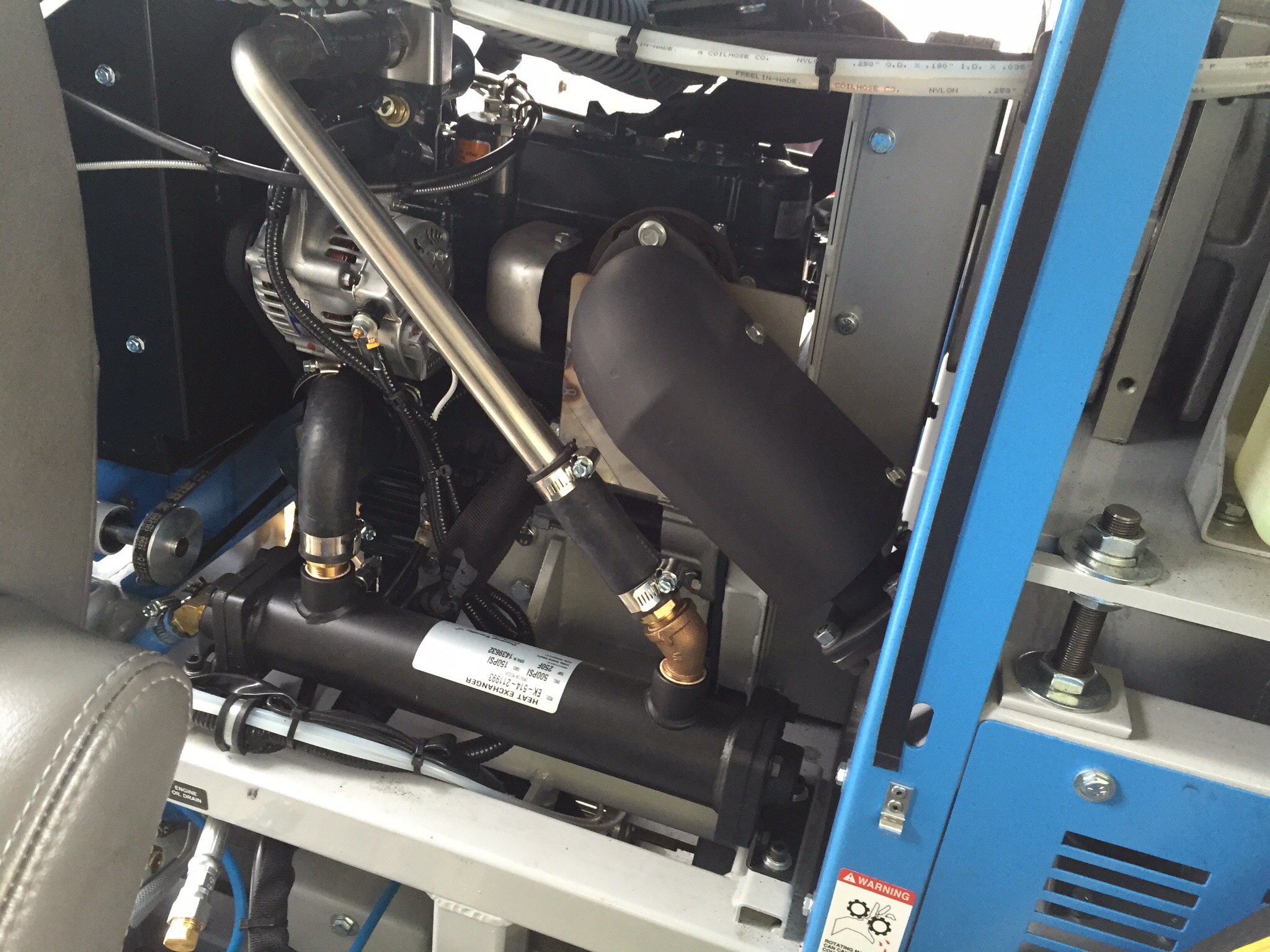

Well I ran it a couple days I noticed a little problem, the vacuum sealed completely at the machine will ramp up to 12 to 13 hg and the relief opens and stays there, When cleaning with a 100 2.5 and 2 inch hose with a Ti wand holed glide sealed to the floor the machine sits between 8 to 9 hg.
and you can hear its relieving at the machine lots of air through vacuum relief, so I tighned it up a little last night, I got it up about to 10hg on dry carpet with the wand sealed to the floof. Sounds alot louder at the wand now to.
I was thinking man my ti wand went from being awesome on my 405 to a feather on this new machine.
gonna clean with both wands today stock westpac with hybrid GG, and Ti.

From the SS570 manual:

11,260
Well they apparently toned down the heat mine will hit 240 atm then it dumps hot hater out a hose under the truck, probably because when I saw Toms his thermostat was hitting 280 @ the truck and I got 220 ATW, But I'm guessing they've had a few problems with the crazy heat. When I get to 14 to 12 hg it will hold 240 all day.
Tom told me to add washers to the relief spring to get it to tighten up more right now completely sealed it sits at 13.5 hg with a 100 ft of hose and a wand it holds at 10 hg and sits ar about 195 atm.
I took a butter chip put it over 1/2 the holes on the relief and bang with a 100 feet of hose and wand on the carpet it pops up between 12 to 14 and has alot more air flow atw then the heat goes to 240 and doesnt drop.
Gonna put some washer in the relief tomorrow tighten it up so I dont have to use a butter chip.
Gonna put some washer in the relief tomorrow tighten it up so I don't have to use a butter chip.
the hose under the truck might be off of the radiator cap on the water tank....if that is the case then the pressure valve is allowing to much pressure into the tank and it is releasing the pressure...once it does this it will effect your heat.....

We did a commercial job new years eve at 6am it was 20 degrees outside this morning 17, at 630.
Once we had both machines going 6000 sq ft job, the SS570 held 195 atm with a 6 jet 12 flow ti wand, the 405 175. So yes in the frosty cold I get more consistant heat with ss570, better vacuum too at 225 feet from the machine.
