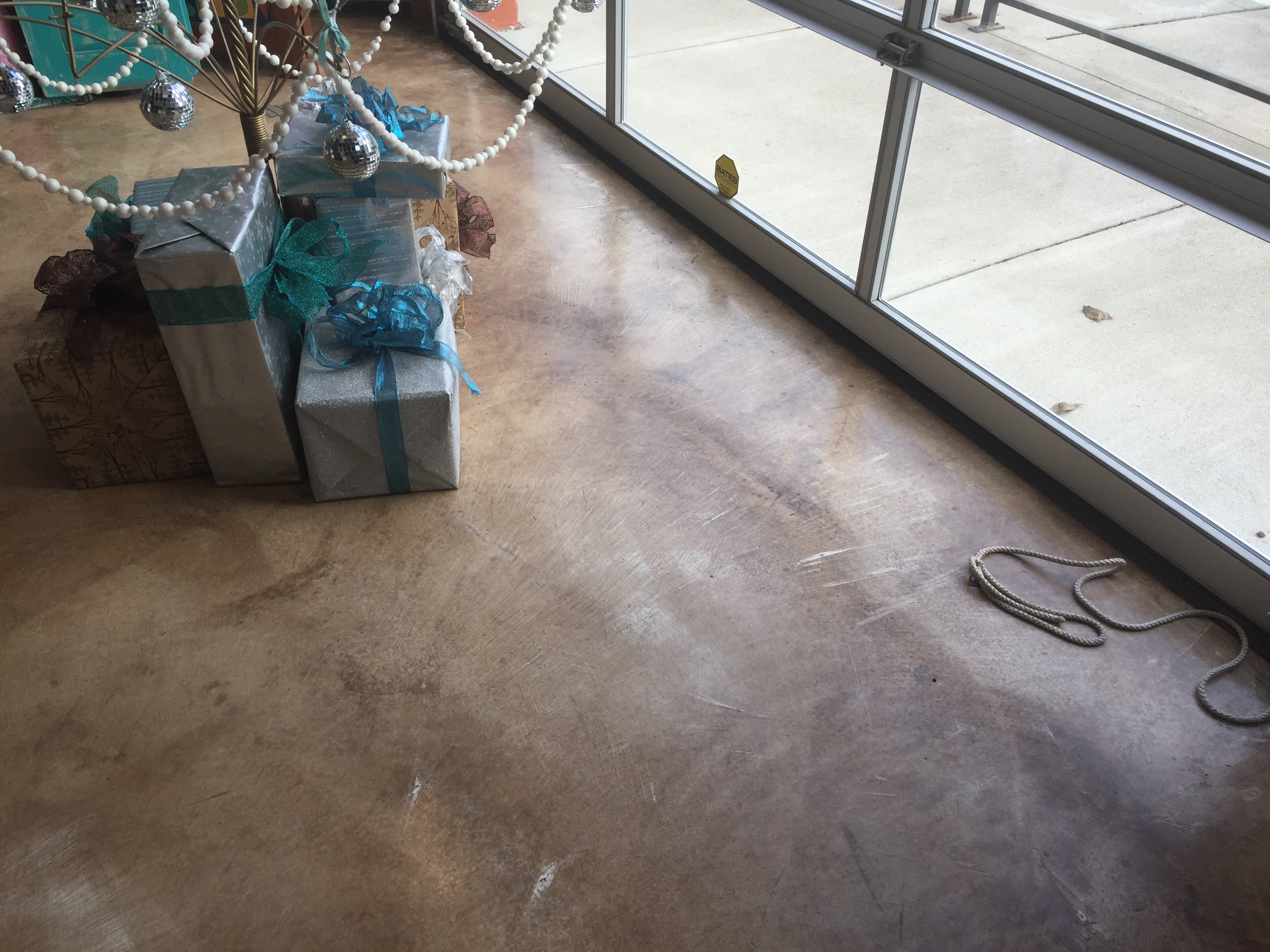

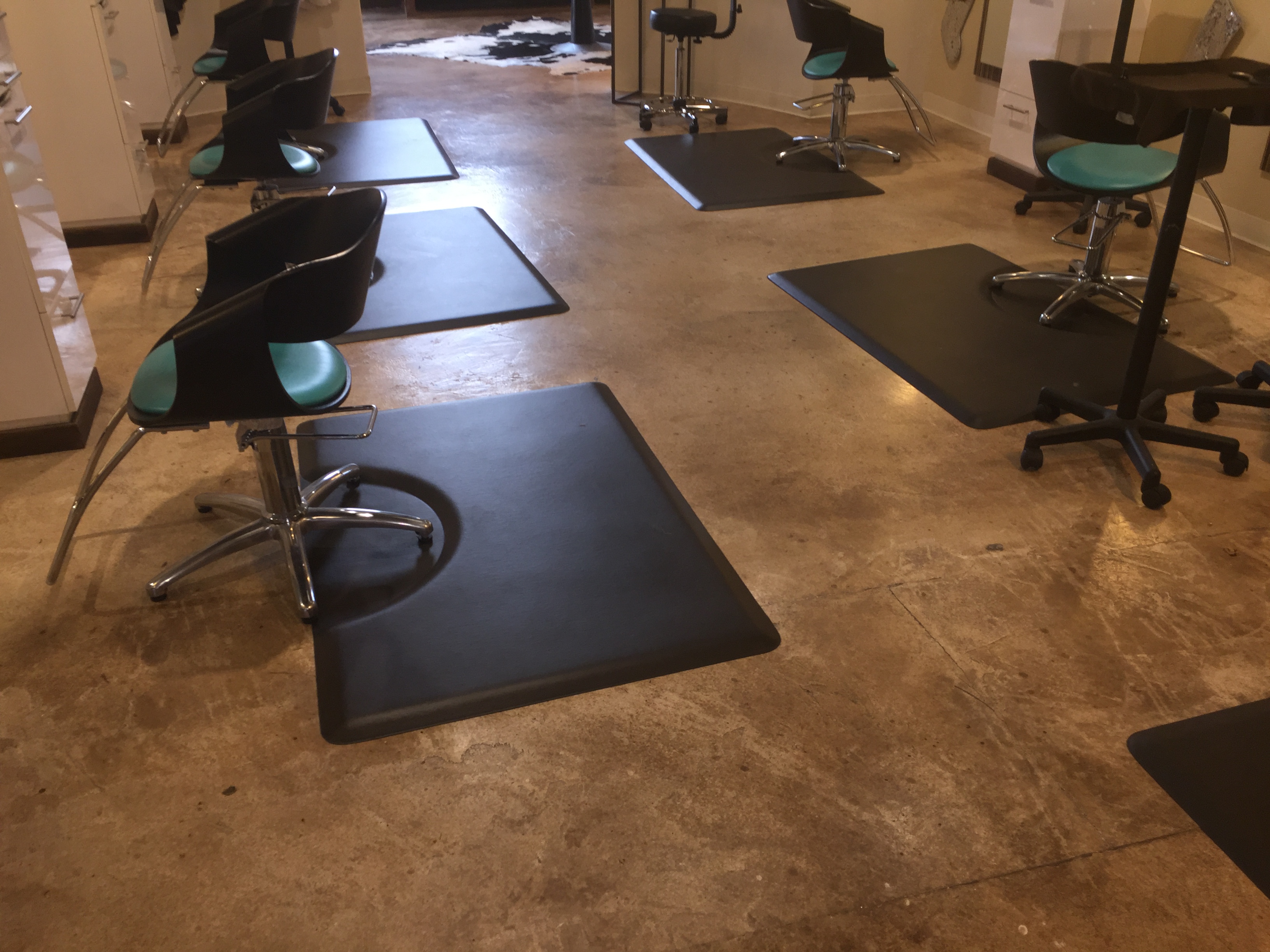

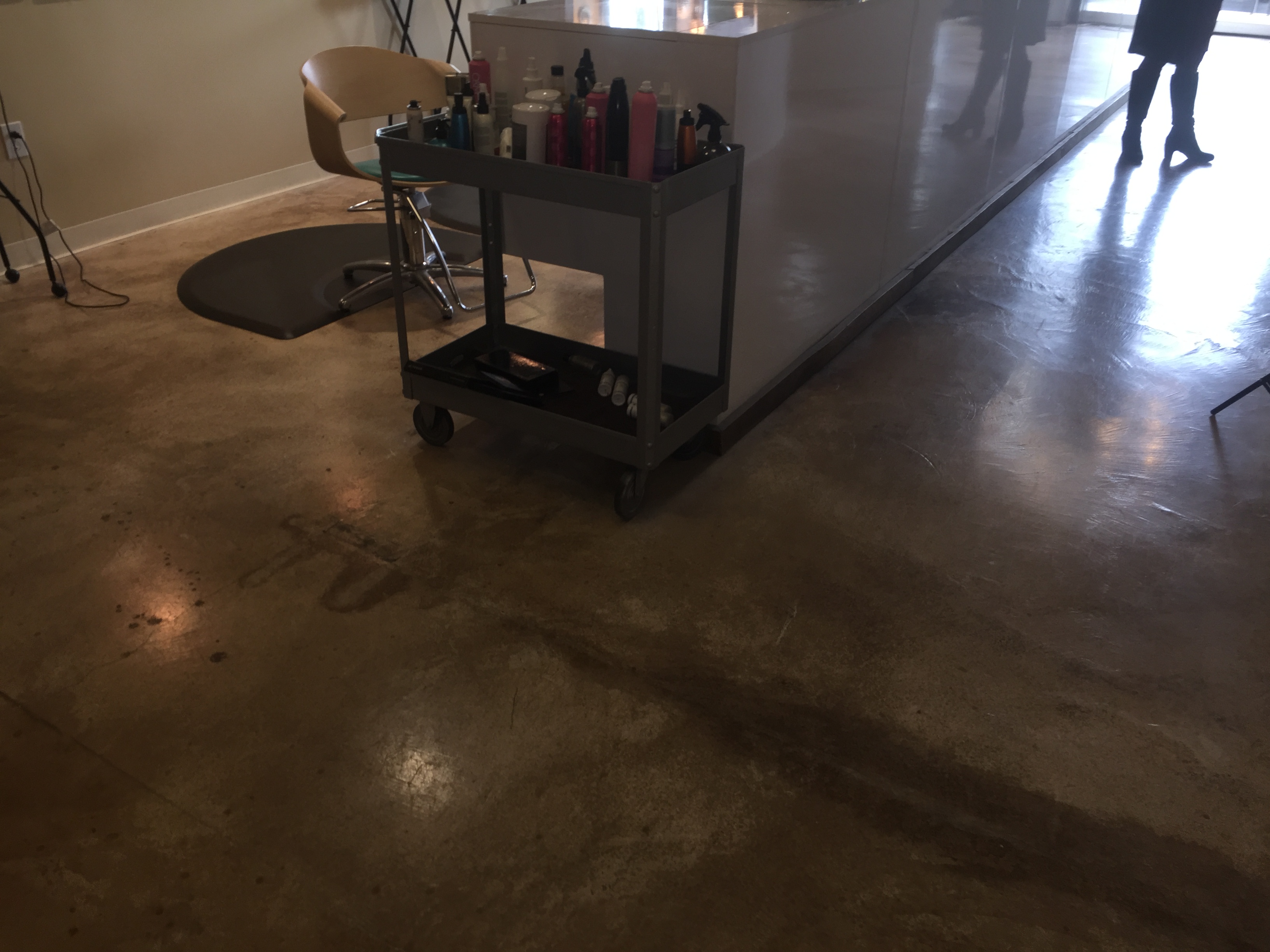

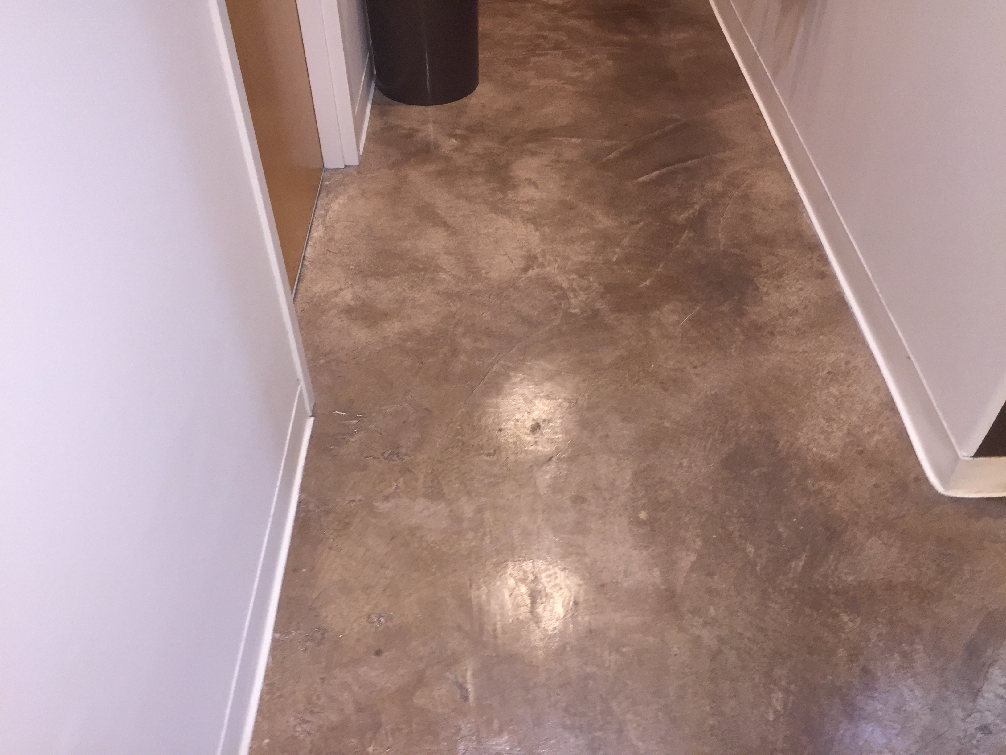

I went to do an estimate for some VCT and Stained Concrete at a salon. She said they wanted the stained concrete waxed but I told them that I wouldn't wax it. I told them I would do the bathrooms and office VCT and clean the concrete. Then if they wanted I would check into a finish or seal to apply afterwards.
What do you guys apply to stain concrete to give it a shine? I'll post some pics but I'm sure you won't be able to see very good. She is checking to see what it was sealed with originally.

That type of stained concrete has a light coating of stain on the surface and if you hit it with a Monkey Pad or any other abrasive pad you will scratch the stain off. You can put a coating on it. The customer asked for 'wax' which is how they view it, but water based 'wax' for concrete is called 'guard' and it has chemical bonding agents in it to make it stick to the concrete. You can get Ameripolish 3D Stain Guard or Sentinal Formula 404 from your local Aramsco Interlink Supply. Give it a light scrub with neutral cleaner and organic citrus, rinse well, apply 1 or 2 coats of guard, collect your money.

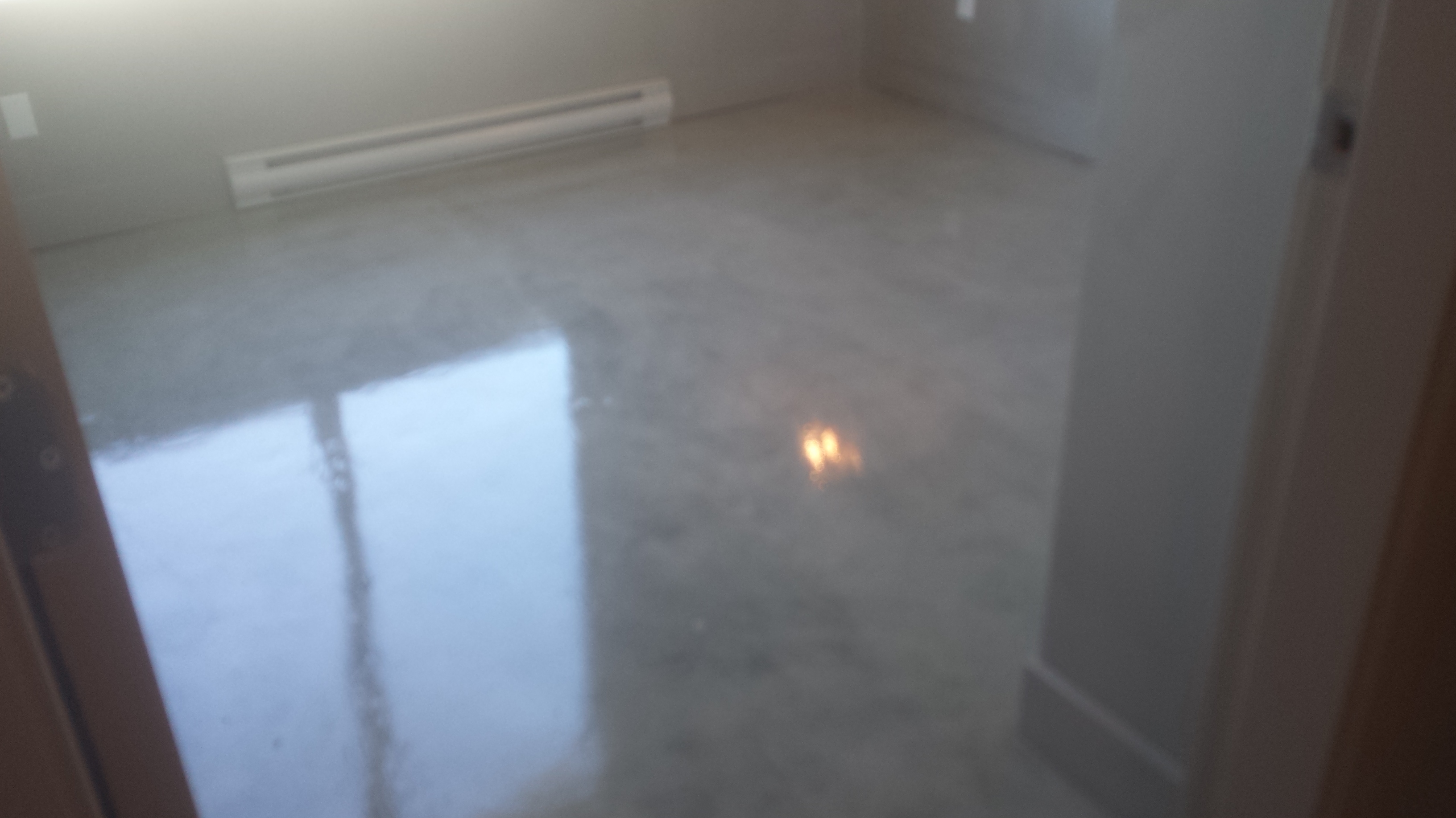

It's dead simple. Clean the floor and get flat mop and an applicator pad, Apply 3 or 4 coats - it turns to glass. Collect. Deposit,Spend.
