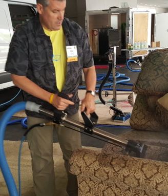

This guy does on upholstery instead of stairs . . .
