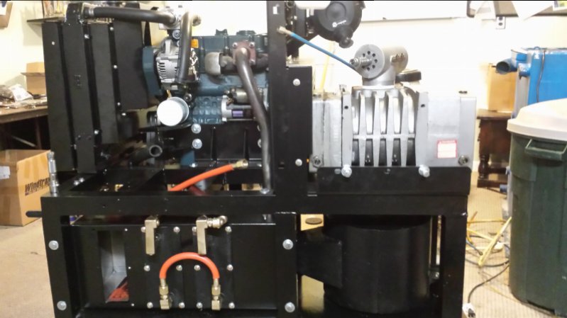

This is a picture of Larry Cobb's set up. I like this set up and it's somewhat like my set up. My 100 gallon fresh water tank sits behind my machine and the waste tank sits to the right of the machine behind the seats if you are facing the machine head on from the side door.
